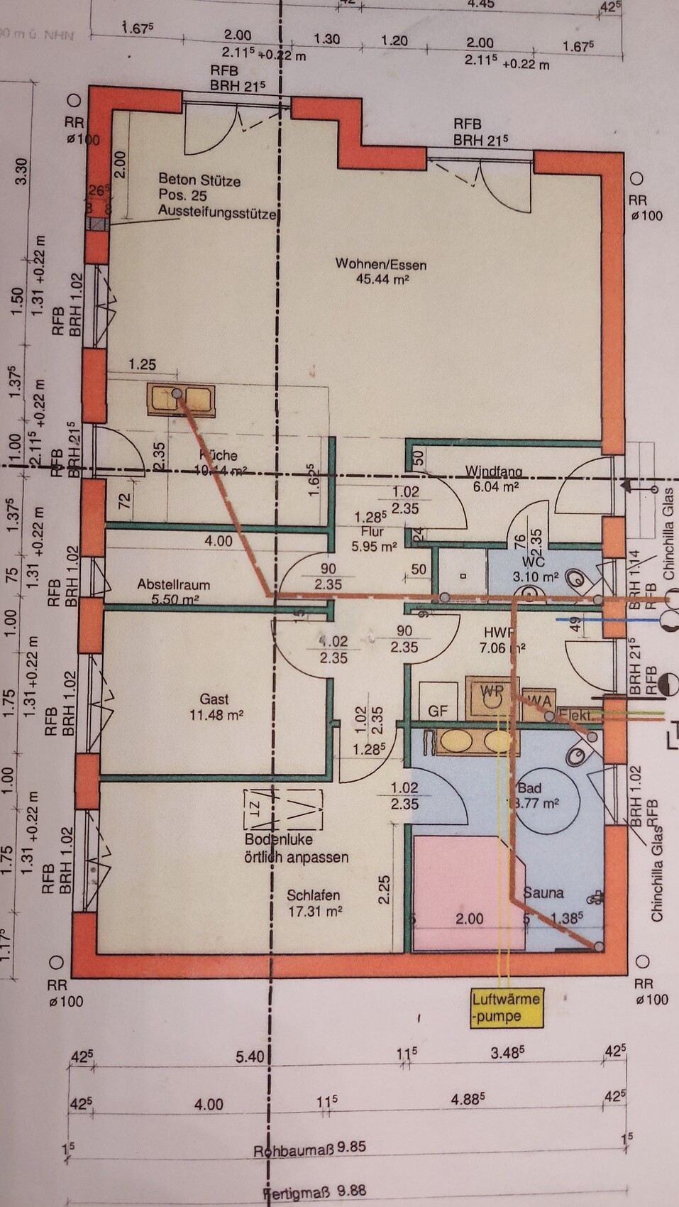

hanghaus202328 Nov 2022 11:43@Nida35a I completely agree with you. But the original poster really insists on having the granny flat and pursuing their hobby. The basement is also a good option since there is a slight slope.
Why not show the original poster your floor plan?

Thanks again for the great feedback. We have now realized that our plans are significantly too large. We will take a closer look at what we actually need. What we have already learned is that the idea of having the garage inside the house is definitely outdated and will be removed.
@Nida35a
Your house looks really inviting, you did a great job. You don’t have a slope or a separate apartment, so we still need to figure out how to include those. Unfortunately, not all the dimensions are readable, but roughly we estimate around 130m² (1400 sq ft) of floor area?
@Nida35a

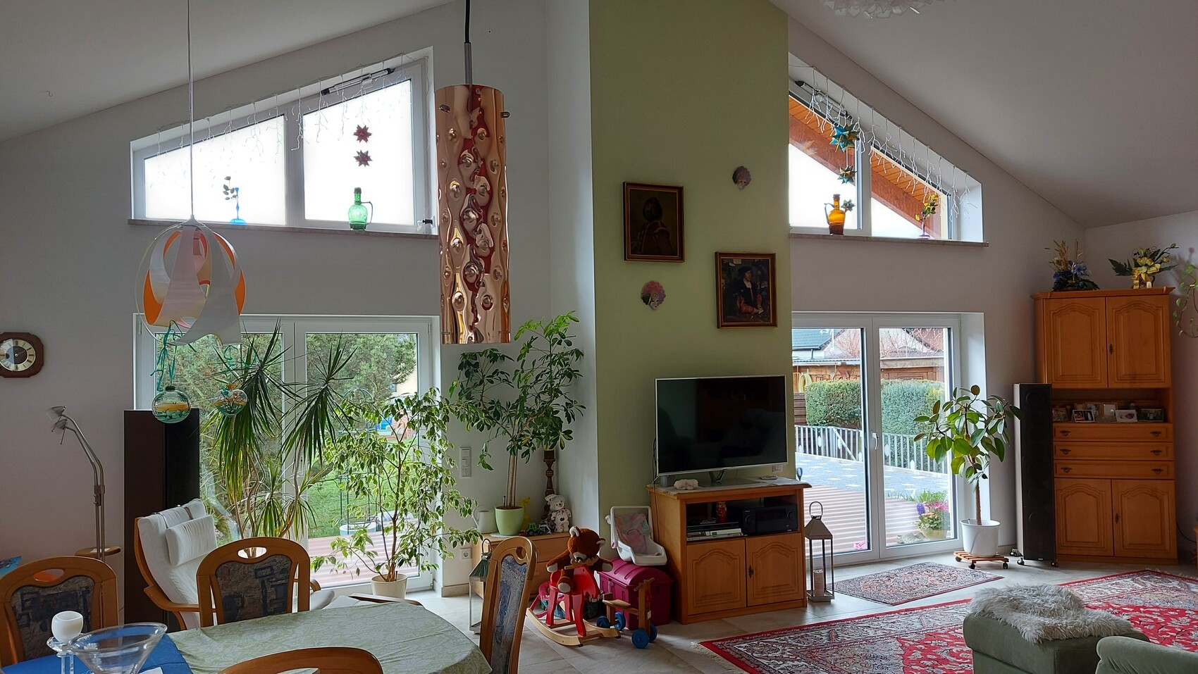

wolko22 schrieb:
Your house looks really inviting; you did a great job.
You don’t have a slope or a separate apartment, so we still need to incorporate those. Unfortunately, not all the house dimensions are readable. Roughly, are you around 130m² (1,400 sq ft) of floor area? Yes, 125m² (1,345 sq ft) of floor area, which is comfortable for the two of us to manage.
We wanted to create a feeling similar to a vacation home, open and full of light.
We could have gone bigger, much bigger even—that’s what we had before.
Just take the opportunity to build a house that suits you.
We often like tiny houses and camper vans too, so for us, small can be nice.
