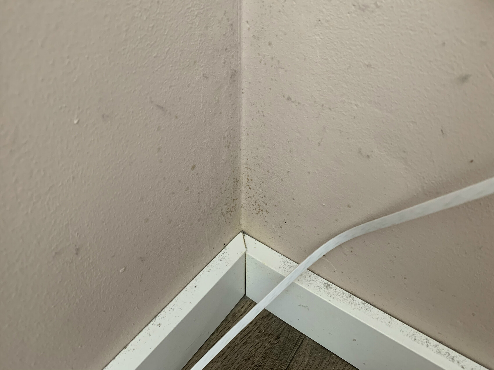

Hello community,
the gray stuff on the white baseboards is dust – not mold or anything like that.
- There are strange spots in the corner on the wall – mold stains?

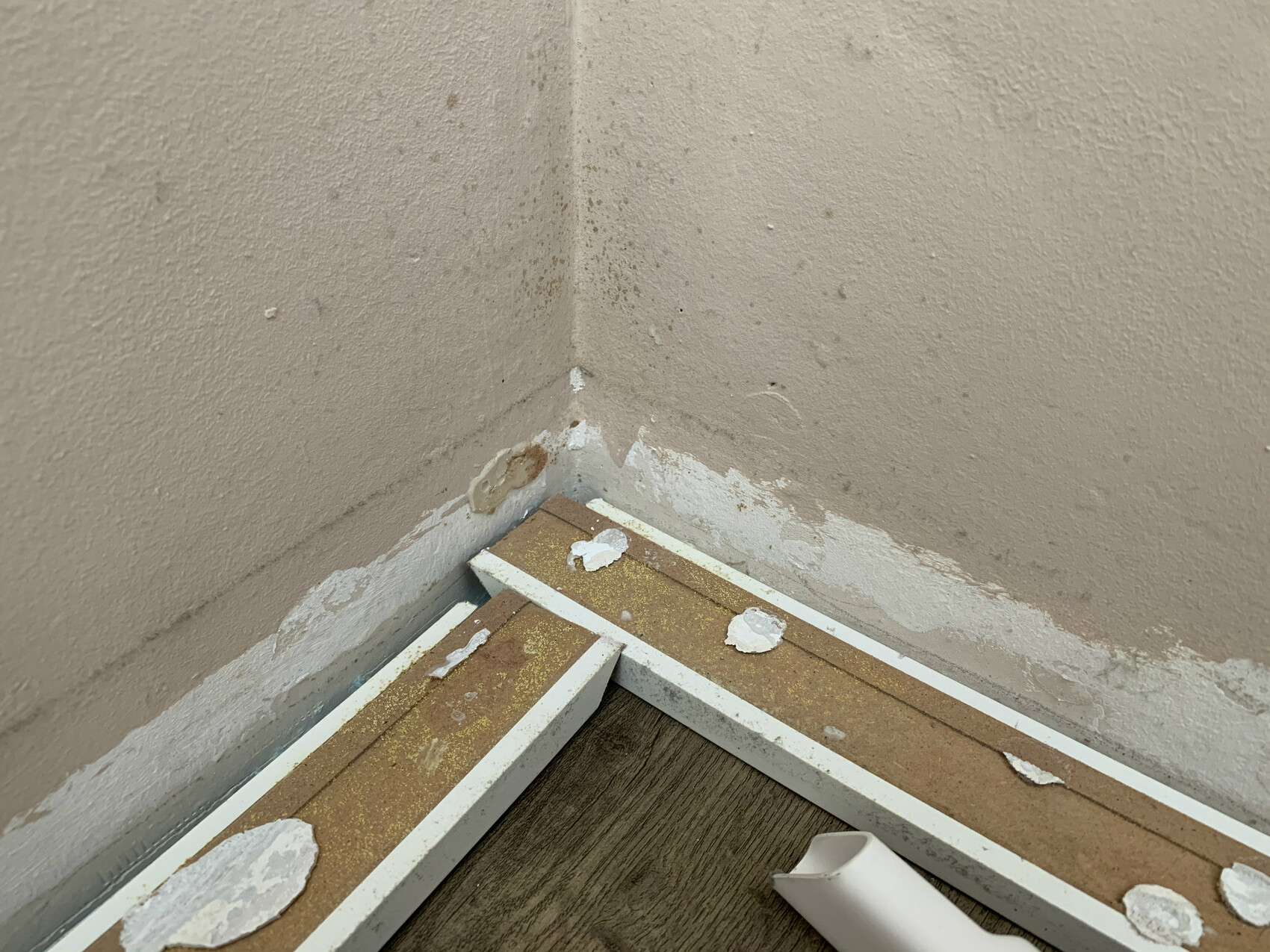

- From the corner, just below the baseboards, I noticed a yellowish tint, so I wanted to check what is going on behind it.
- What are those yellow spots on the back of the baseboards?

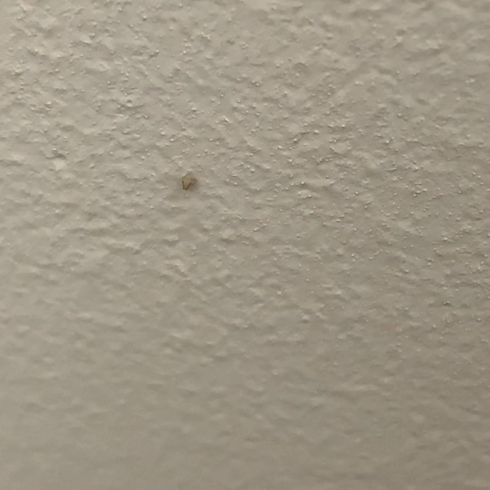

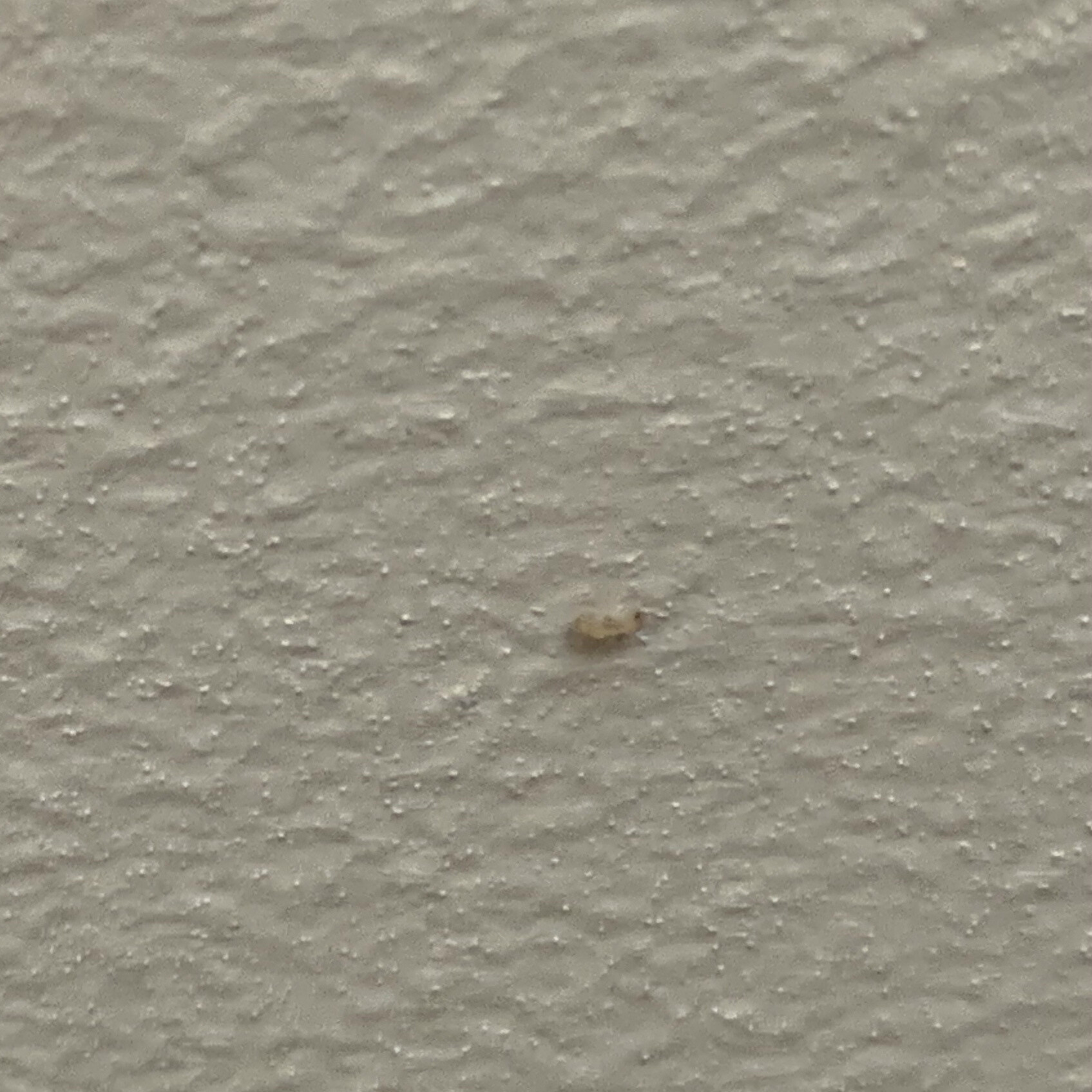

- Noticeable were these small creatures behind the couch, crawling out along the wall.
2-second video "small creatures": [MEDIA=imgur]a/IVN6664[/MEDIA]
Can someone enlighten me?
Thanks

seat88 schrieb:
Was the couch placed right against the wall? There might be mold or mildew; I can’t comment on your pests ^^ Yes, the couch was against the wall – now it’s about 1cm (0.4 inches) away. Although with kids jumping on it, that gap probably won’t last long.
I would suggest looking into booklice.
Search for booklice on Google, and you’ll find a site from the German Pest Control Association… fits with the dust you have as well. KingJulien schrieb:
https://www.hausbau-forum.de/threads/was-sind-das-für-viecher-und-wo-kommen-sie-her.33905/
The same pests? Looks like it: booklice!
And the yellow spots on the wood? Are those eggs? Does the wood react (e.g., softness, discoloration)?
guckuck2 schrieb:
Feeding marks and pests alongside.
Moisture in the corner or just residual moisture in a newly built home. Residual moisture in the new build is likely, we moved in 3 years ago.
What do you mean by feeding marks? The spots on the wall?
Thanks for your replies!
hni0i schrieb:
And the yellow spots on the wood? SEggs or droppings
