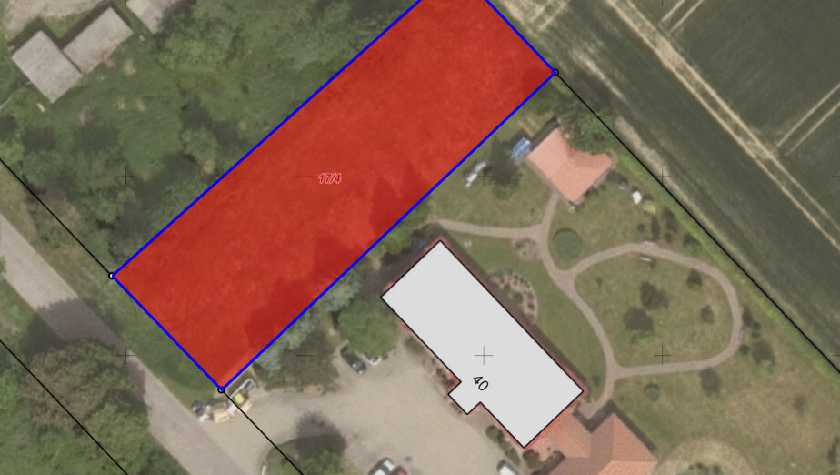

We have the opportunity to buy a plot of land that is 22m (72 feet) wide and 65m (213 feet) long. It is a north-facing lot. How do you usually approach a situation like this? Do you position the house towards the back or the front?
I have uploaded a few pictures for better understanding. The map excerpt is oriented north.
One important criterion for us is "maximum sunlight." Where should the main entrance be located? How can we create a southwest-facing terrace?

Luftbild: rotes Rechteck-Grundstück (17/4) mit blauer Umrandung neben Gebäuden und Feldern.
Vogelperspektive eines Grundstücks: roter rechteckiger Bauabschnitt neben weißem Haus.

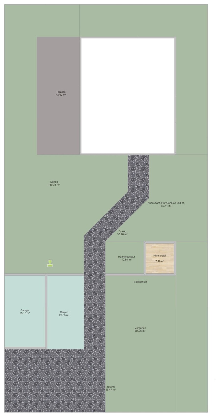

I have prepared a proposal for a friend’s north-facing plot. Maybe it can serve as a reference for you (of course, individual regulations always need to be taken into account).
The garage and carport are used as privacy screens and, in my friend’s case, include a chicken coop (this could also be replaced by a garden shed).
The walls used for separation can also function as privacy fences.
Lageplan eines Gartens mit Terrasse, Hühnerstall, Zuweg, Sichtschutz, Garage, Carport und Zufahrt.

You’ll soon need a tractor just to keep the garden in shape. You’ve really got to want that.
The northwest corner is a smart choice; very long driveways and access roads are expensive and don’t look good either.

And maybe it’s worth considering whether you might want to divide the plot later on. A second plot for the child or in case of financial difficulties... this seems possible here. Planning accordingly is advisable.
Max.mkmk
27 Aug 2019 16:13
whether the plot might be divided later on.
Not sure if that will ever be possible. At the back, there is only farmland, no road.
27 Aug 2019 17:30
Max.mkmk schrieb:
Not sure if it will ever be possible. At the back there is only farmland, no road.
No worries. That’s what walking sticks are for.
