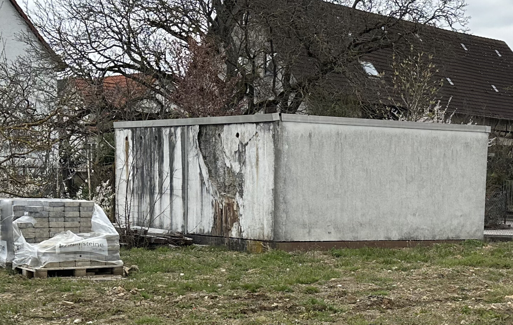

I’m looking (again) for some advice from the experts here. There is a plot of land about 35 km (22 miles) from Stuttgart that my partner and I might be interested in. It has an area of 425 sqm (4,575 sq ft), but with some restrictions, if I understand correctly. The official land value in this area is €600 (about $650) per sqm, and the asking price for the plot is €350,000. What bothers us are the two garages on plot 1848, which look completely neglected (actually close to demolition, especially from the back). And of course, there is the access path that would run directly past the house. The plot plus additional costs would use up all our equity. There are two of us, but we would need about 110 sqm (1,184 sq ft) of living space and maybe 30 sqm (323 sq ft) of storage/utilitarian space. Also, a carport. According to the seller, there is no obligation to build. The builder of the house on 1849/1 is related to the owner of 1849.

If you can’t accept the design, age, or proximity of neighboring properties, then you shouldn’t buy such a lot. The garages have their purpose, even if they look neglected to you. They are not neglectful for their function and will likely continue to serve their use. These are signs of aging that tend to be treated more loosely in garages, especially when built on a property boundary. Everyone is responsible for their own property, fencing, and thus privacy screening. This means it is your responsibility to cover the point of contention with a privacy screen or hedge if you wish. As a general rule, the last neighbor adapts to the existing conditions and tolerates them. Alternatively, you can ask for permission to paint or improve them. However, no entitlement should be expected.

Both of us find the two garages on property 1848 disturbing; they look completely neglected (from up close they are actually ready for demolition, especially from the back).

Conclusion: keep looking! (By the way, what happened to the end terraced house?). Yes, then the "remaining" plot would be uninteresting to us because hardly anything would be left. And thanks for asking—the seller of the terraced house had their own house purchase project, which did not materialize. Therefore, they have temporarily stopped their own sale. This is what we were told.
