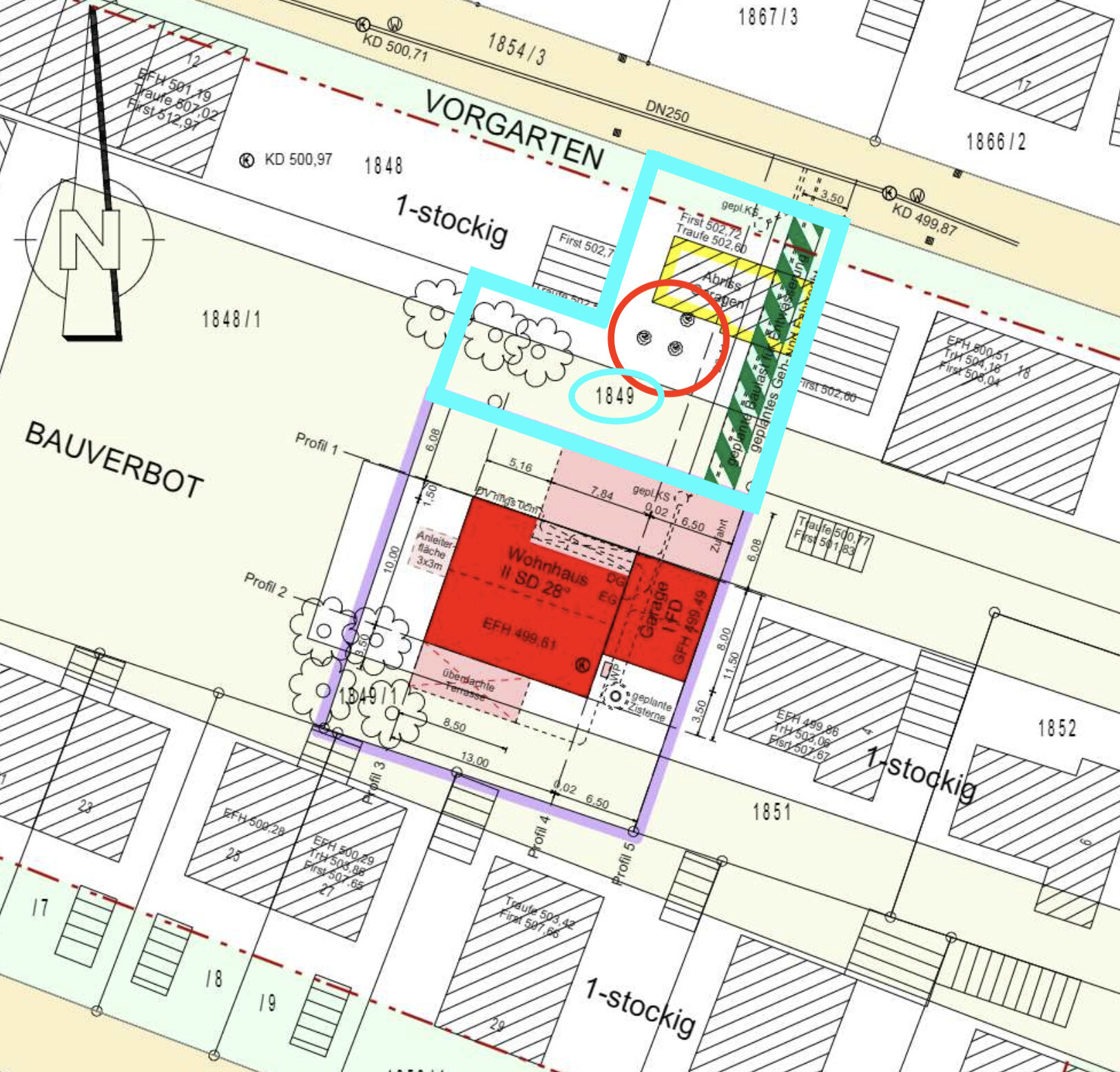

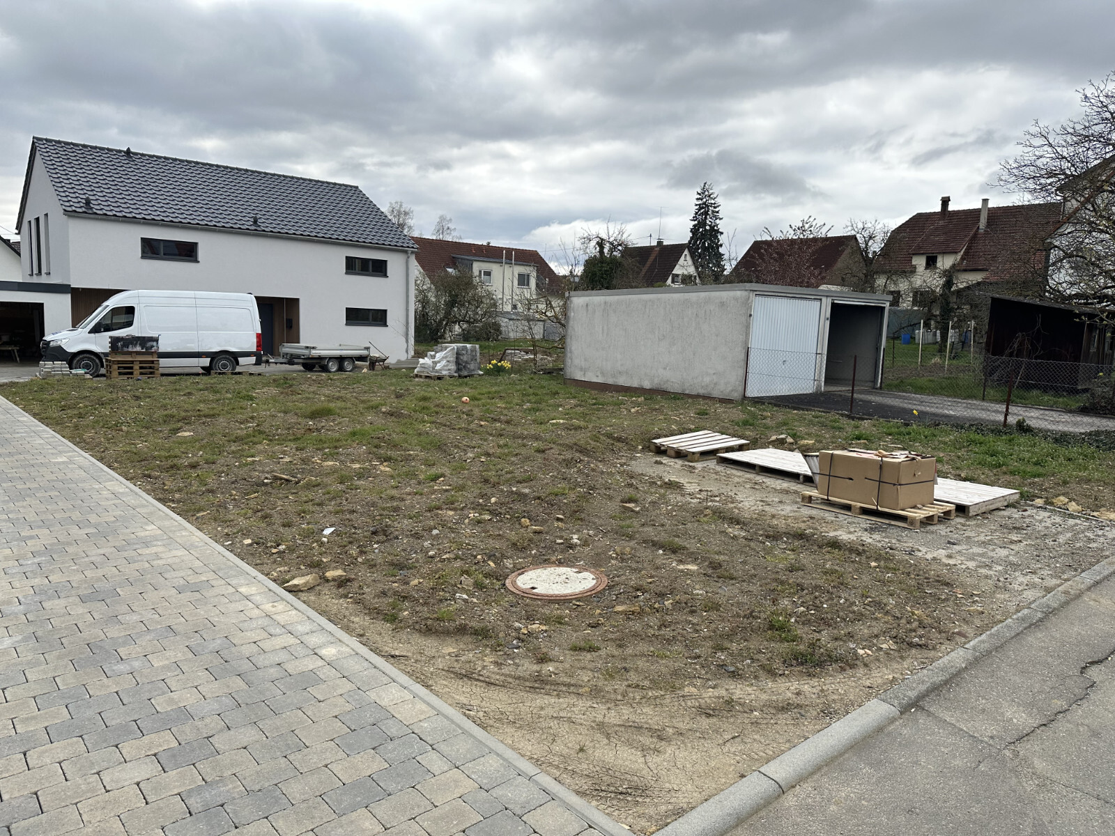

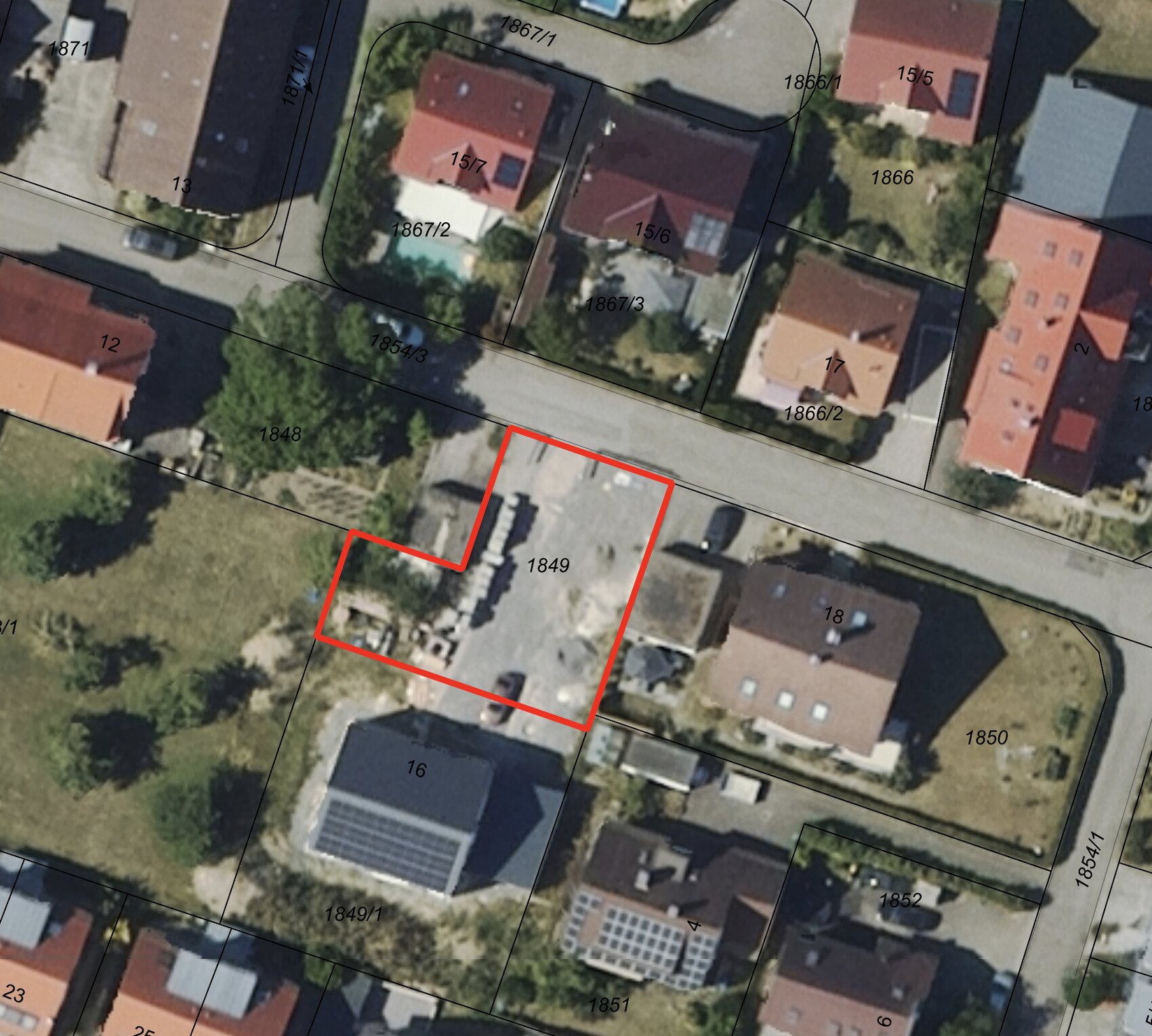

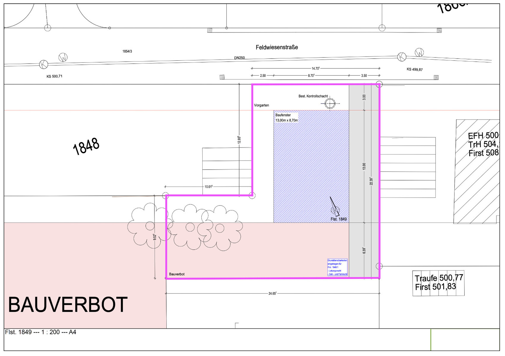

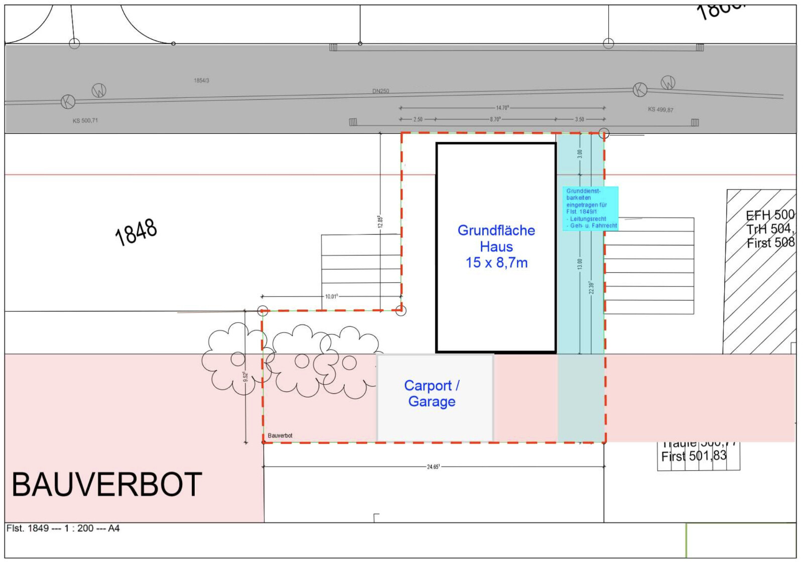

I’m looking (again) for some advice from the experts here. There is a plot of land about 35 km (22 miles) from Stuttgart that my partner and I might be interested in. It has an area of 425 sqm (4,575 sq ft), but with some restrictions, if I understand correctly. The official land value in this area is €600 (about $650) per sqm, and the asking price for the plot is €350,000. What bothers us are the two garages on plot 1848, which look completely neglected (actually close to demolition, especially from the back). And of course, there is the access path that would run directly past the house. The plot plus additional costs would use up all our equity. There are two of us, but we would need about 110 sqm (1,184 sq ft) of living space and maybe 30 sqm (323 sq ft) of storage/utilitarian space. Also, a carport. According to the seller, there is no obligation to build. The builder of the house on 1849/1 is related to the owner of 1849.
Is it feasible to build a house on this plot that meets these requirements? Are there deductions when valuing the plot as equity? How would the living quality be assessed – also with regard to a possible later sale?

In this case, probably the first scenario happened: the old building was demolished, the first heir kept a nice plot of about 6xx sqm (6xx sq ft), built on it and paved his driveway to the street.
The remaining front part of 425 sqm (4,575 sq ft) is now offered online as a nice, flat plot by the co-heir without mentioning that the rear part has a building ban.
The price is outrageous, especially considering the building ban and the driveway that have to be deducted or realistically factored in. Personally, I would not buy this plot for that reason alone, as I wouldn’t want neighbors like that.
