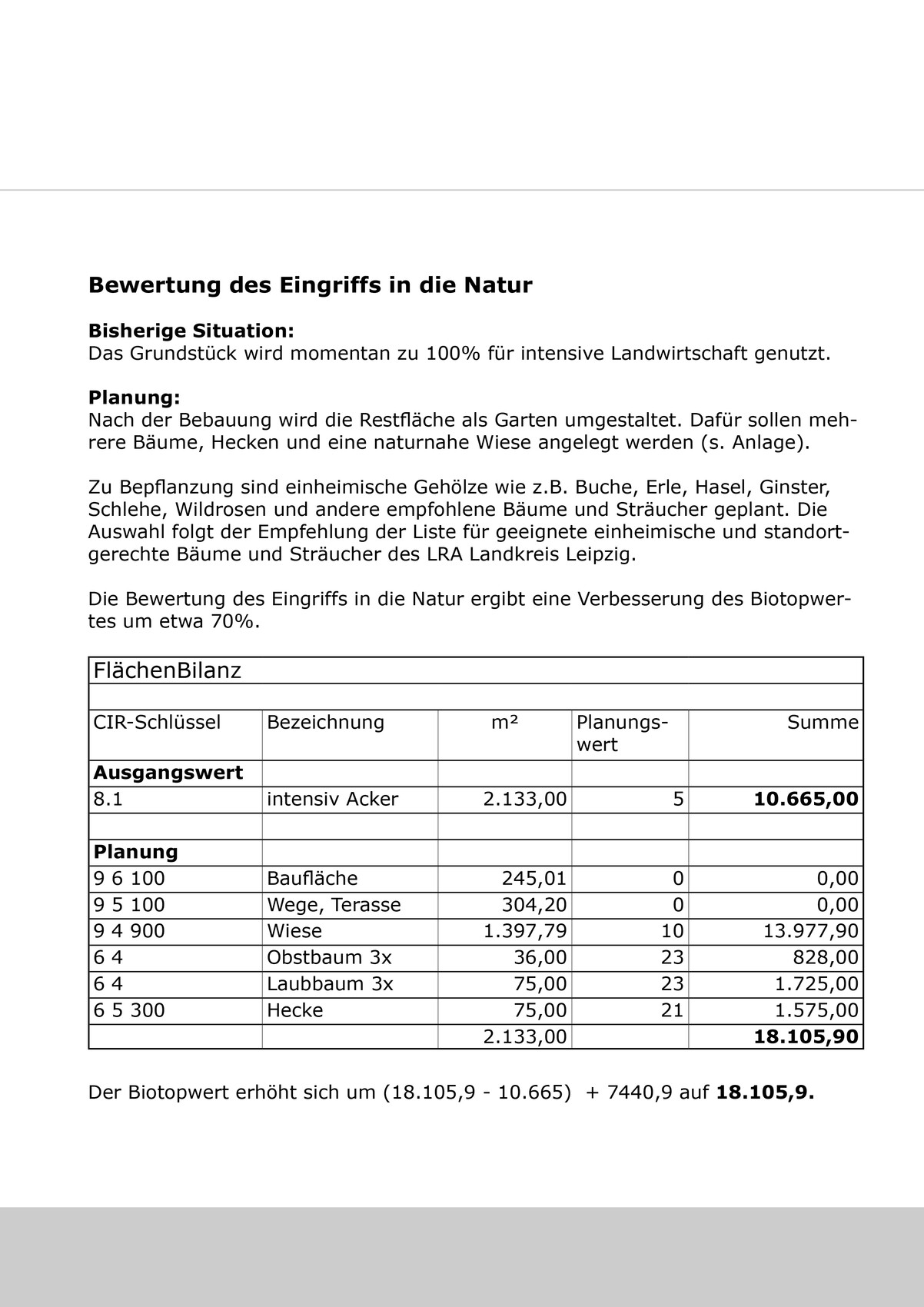

We also did some construction work outdoors. For this, we needed approval from the nature conservation authorities. They required an "assessment of the impact on nature." Fortunately, we were allowed to carry this out ourselves, which saved us from additional costs.
The impact on nature is evaluated according to specific criteria.
It looked like this in the end:
