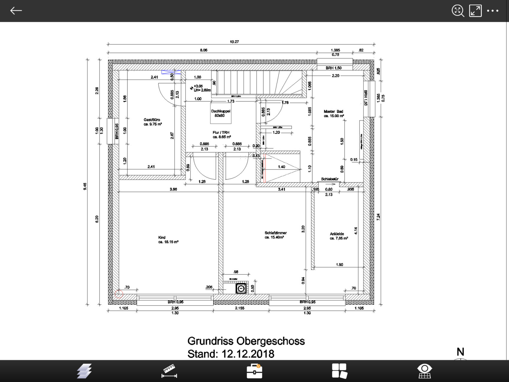

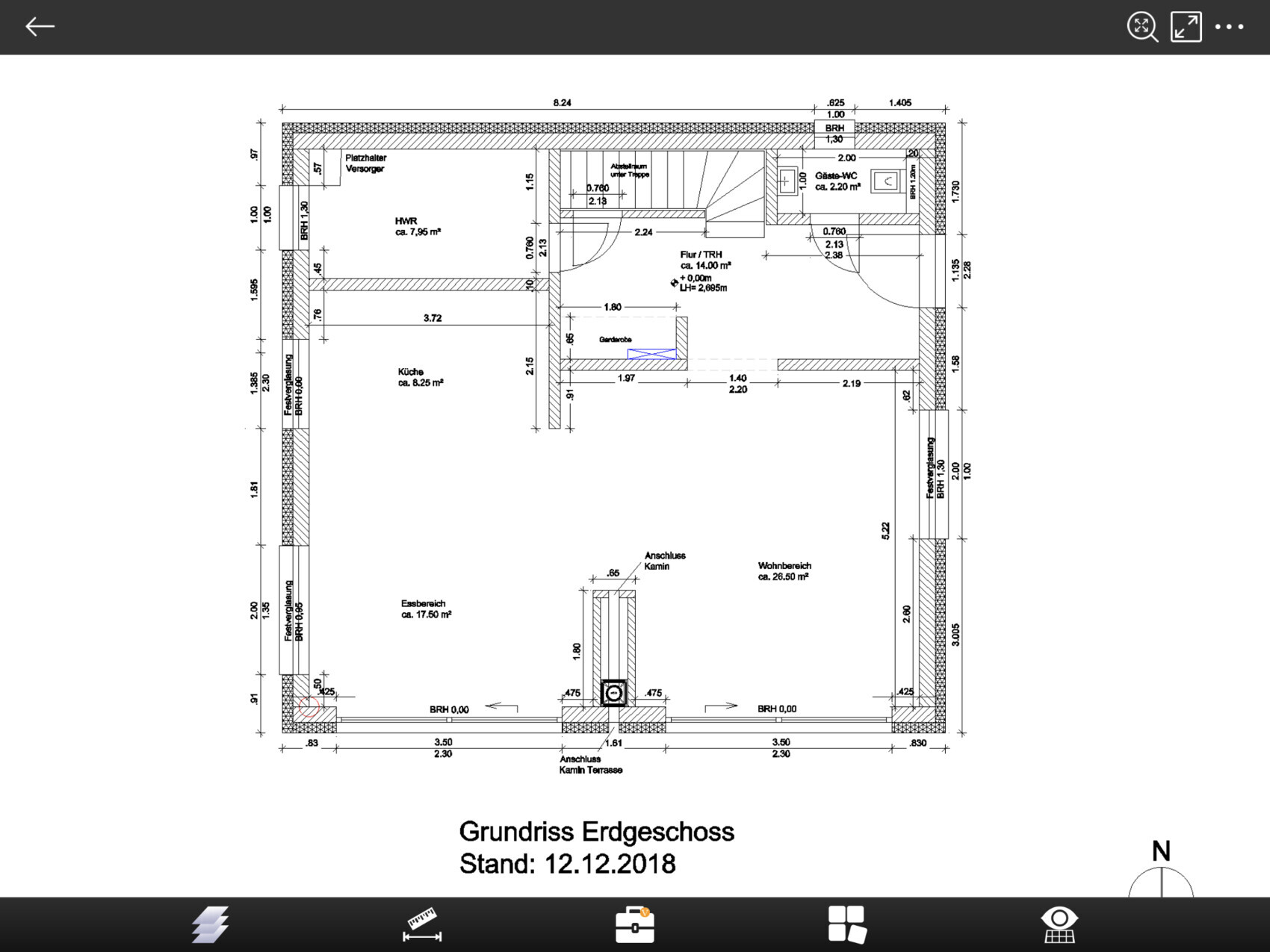

Without exact dimensions, it’s hard to say for sure. Here are a few key points to consider:
- Possibly swap the kitchen and living room (more private relaxation area, shorter route from the entrance to the kitchen, living room more on the west side, kitchen in the southeast)
- A bathroom with two doors might not suit everyone; where is the toilet located? The layout could be improved
- The "fireplace" wall seems more like a disturbance to me. I don’t find it suitable as a room divider. It disrupts the sense of space and the view of the terrace. Definitely try a 3D walkthrough if possible. It should be removed.
- There are too few windows, especially in the stairwell, which needs more natural light
- Having the bedroom next to the children’s room and positioned on the south side may not be ideal
- A chimney close to the exterior wall usually doesn’t look very appealing
But these are mostly minor details or personal preferences. Overall, it works.

Here are the floor plans with dimensions.
Floor plan ground floor with kitchen, dining area, living area, utility room, and hallway, dimensions included
Floor plan upper floor: guest/office, hallway, bedroom, child’s room, walk-in closet, master bathroom.

I would also swap the kitchen and living room. And add windows to the stairwell, otherwise it will feel like a real cave. These skylights are actually very difficult to keep clean, which is quite an unpleasant issue...
