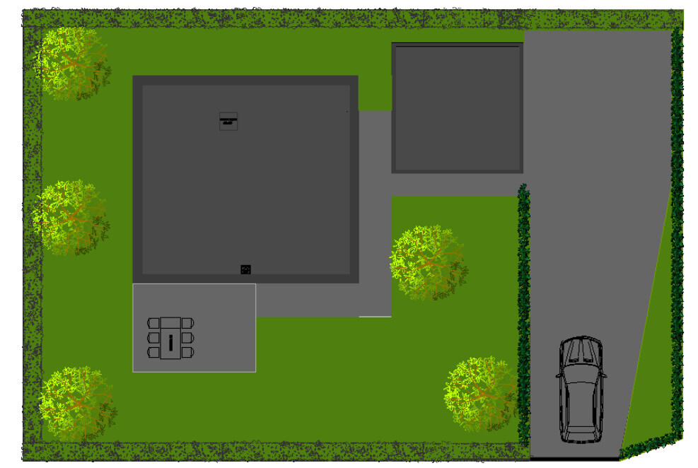

Hello Forum,
Attached are our current floor plans for the ground floor and first floor, as well as the location of the house on the plot in the residential area. The house is just under 150sqm (1,615 sq ft) and will be occupied by three people. The terrace faces southeast. The floor plans are my own design; the architect and structural engineer have not yet reviewed them. Another note: you can see our current furnishing, including the existing kitchen.
Do you have any comments, suggestions, etc.? I am looking forward to a constructive discussion.

Yes, there will be a double garage of approximately 6x6m (20x20 feet). No, I am not allowed to exceed the 5m (16 feet) building line. Therefore, a garage on the west side is not possible. It can only be placed east of the house.
Furthermore, the driveway should also be used as a parking space for guests. Parking is not allowed on the private road.

Basically, the cul-de-sacs are necessary to provide access to the rear plots.
Parcel 38, for example, is accessed from the main street.
This already takes up quite a lot of space:
Bird’s-eye view: Large gray house with extension, terrace, green yard, right driveway with car.
The site coverage ratio/floor area ratio is missing in the original post… I’m not sure if it has been mentioned before.
I would rather imagine a wider building, for example:
Ground floor plan: Kitchen/dining on the left, living room on the right, staircase in the middle, hallway, bathroom.
The first floor would be mirrored accordingly and would need to be revised.
First floor plan: Hallway with staircase, bathroom, bedroom with walk-in closet, two children’s rooms.
From the left side:
5 m (16 ft) building setback - 15 m (49 ft) house - 6 m (20 ft) garage ... leaving 4 m (13 ft) width remaining
and from the top of the plan:
3 m (10 ft) + 1 m (3 ft) for access path, 7.8 m (26 ft) house, with 9 m (30 ft) plot depth remaining from the bottom of the plan
Question: Would a pedestrian pathway be possible from the main street to the front door?
The building depth here is still 7.8 m (26 ft). Overall, with the suggested room layout by the original poster, it should be possible to save some space and achieve a similar footprint as the house currently planned.
You placed the utility/technical room facing the main street. Is access provided from there? Would it also be possible to place it in the other north corner of the house?

It’s clear that the dead-end roads are necessary for accessing the rear lots. For the original poster, the problem is that access (driveway) has to be made from there (which really needs to be clarified whether it’s absolutely required). If it does have to be that way, I’d also favor a more elongated building with the garage positioned as far east as possible. The issue of a pedestrian path to the house is still unresolved and must be clarified in relation to the driveway.
I’ve looked at a similar situation in another housing development: there, the driveway is allowed directly from the main road, and the dead-end roads are planned exclusively for the rear lots. That seems more logical and allows for better building layouts. Maybe it’s worth checking with the local authority how the zoning plan is actually intended.
Either way, it’s going to be a tight fit...
