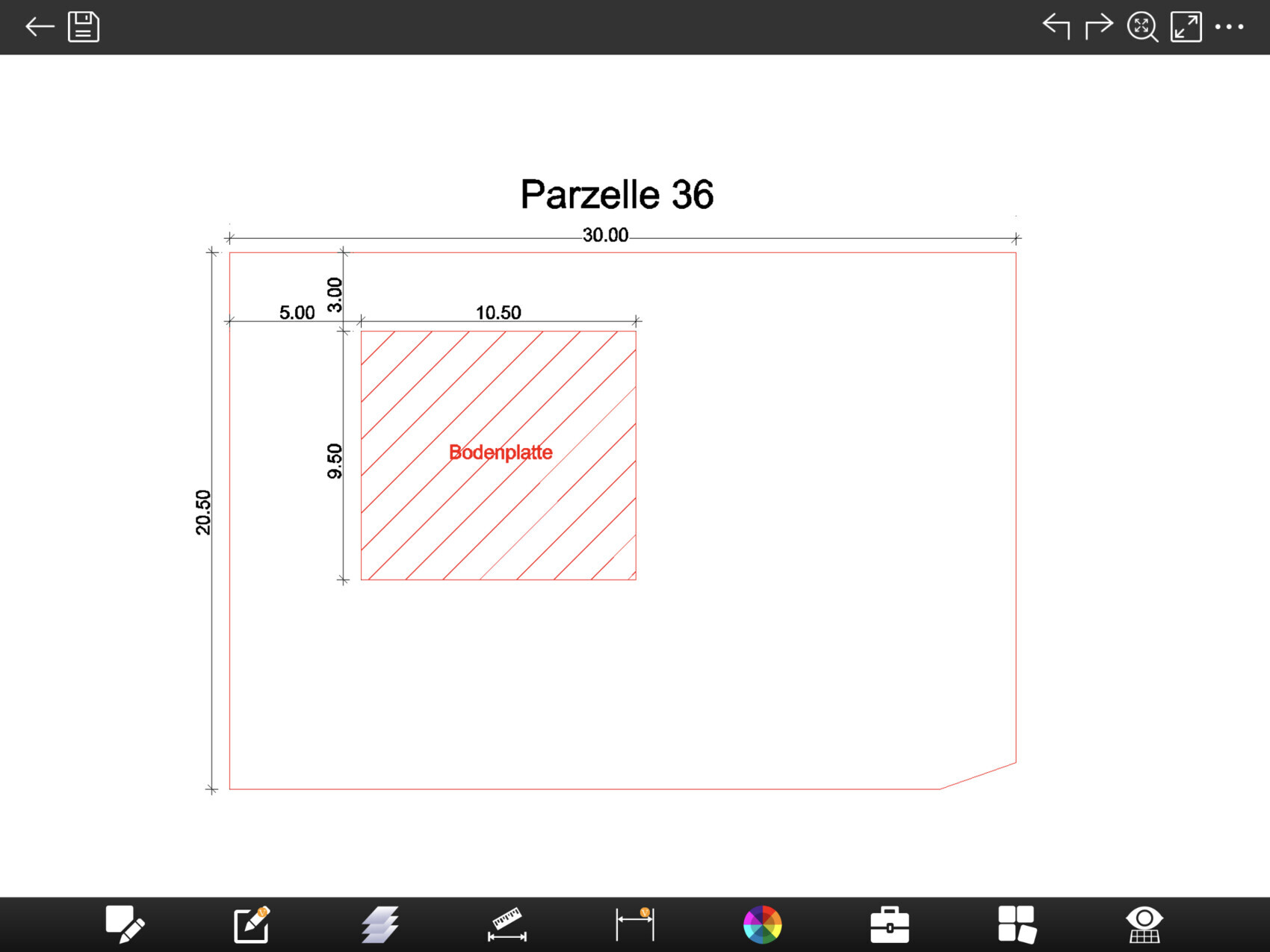

Here are the plot dimensions quickly. Sorry, we are still traveling at the moment.
We want to be able to get from the garage into the house without getting wet. That’s why the garage is positioned there in the plan.
Grundriss: Parzelle 36 mit roter Umrandung; schraffierte Bodenplatte im linken Bereich.

Is it allowed for the garage to be built on the western boundary? That would also be the best location for me. It would provide privacy from the street. Boundary construction would be ideal. And consider how much sunlight you would actually lose by doing so.
What dimensions should the garage have? Double garage?
