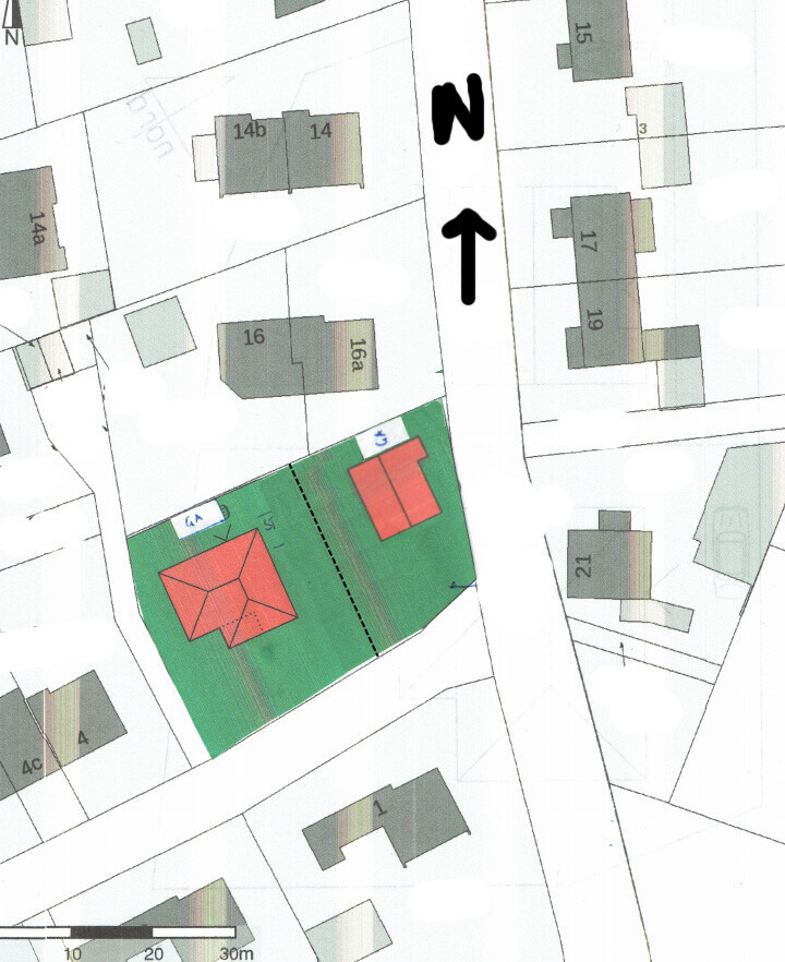

Now, the question is about access. Attached you can see the first site plan from the architect. Our plot would be the plot on the right. The land will be subdivided into three parcels, with both buyers jointly purchasing and sharing the small “access strip” 50/50 as a driveway.
Alternatively, we could purchase the entire right plot, and our neighbors would then have to create their access from the other road to the south. According to the building authority, both options are possible.
If we choose the option shown in the attachment, we would have to buy less land. The architect said that the right plot (with a small border adjustment) could be reduced to a maximum of 500sqm (5,382 sq ft). This is already somewhat expensive for us, but manageable. With the shared driveway, our plot would be “only” about 420sqm (4,521 sq ft), but we would presumably have to pay for half of the driveway. We were also told that we might save some costs on utility connections with a shared driveway.

Site plan: green plot with two red buildings, surrounding houses, and north arrow.

But I fully agree with everything you wrote in #2. If it is at all avoidable, a shared access should not be created. In my opinion, it is even completely inappropriate here, as the plot is then surrounded on three sides by roads.
Fyddles schrieb:
You’re right in a way, except that we wouldn’t be allowed to use it; otherwise, there is very little advantage for them.
You mentioned that the subdivision has not yet taken place. Assuming the neighbor wants a larger plot, you could divide it differently:
Site plan: Two red buildings on green property, surrounded by roads, north orientation at the top.
The surveying costs would also be somewhat lower then.

Yes, I estimate around 500€ (about 550 USD). But I think we agree that even if you could save 5-10K€ (5,500-11,000 USD) with shared development, the disadvantages outweigh the benefits.
Fyddles schrieb:
How expensive is subdividing the property? Generally, and then subdividing into three parcels?
That depends on the number of subdivision parts, land value, boundary length, and lot size. Rough estimate: 2-3K€ (2,200-3,300 USD).
Let me put myself in the neighbor’s shoes on the left side:
If they aren’t watching every penny, they might be happy to get more land for their corner bungalow—of course, not the area from #1. That’s why in #19 I shifted the shared boundary by 3m (about 10 feet), which roughly corresponds to the area for the access road.
