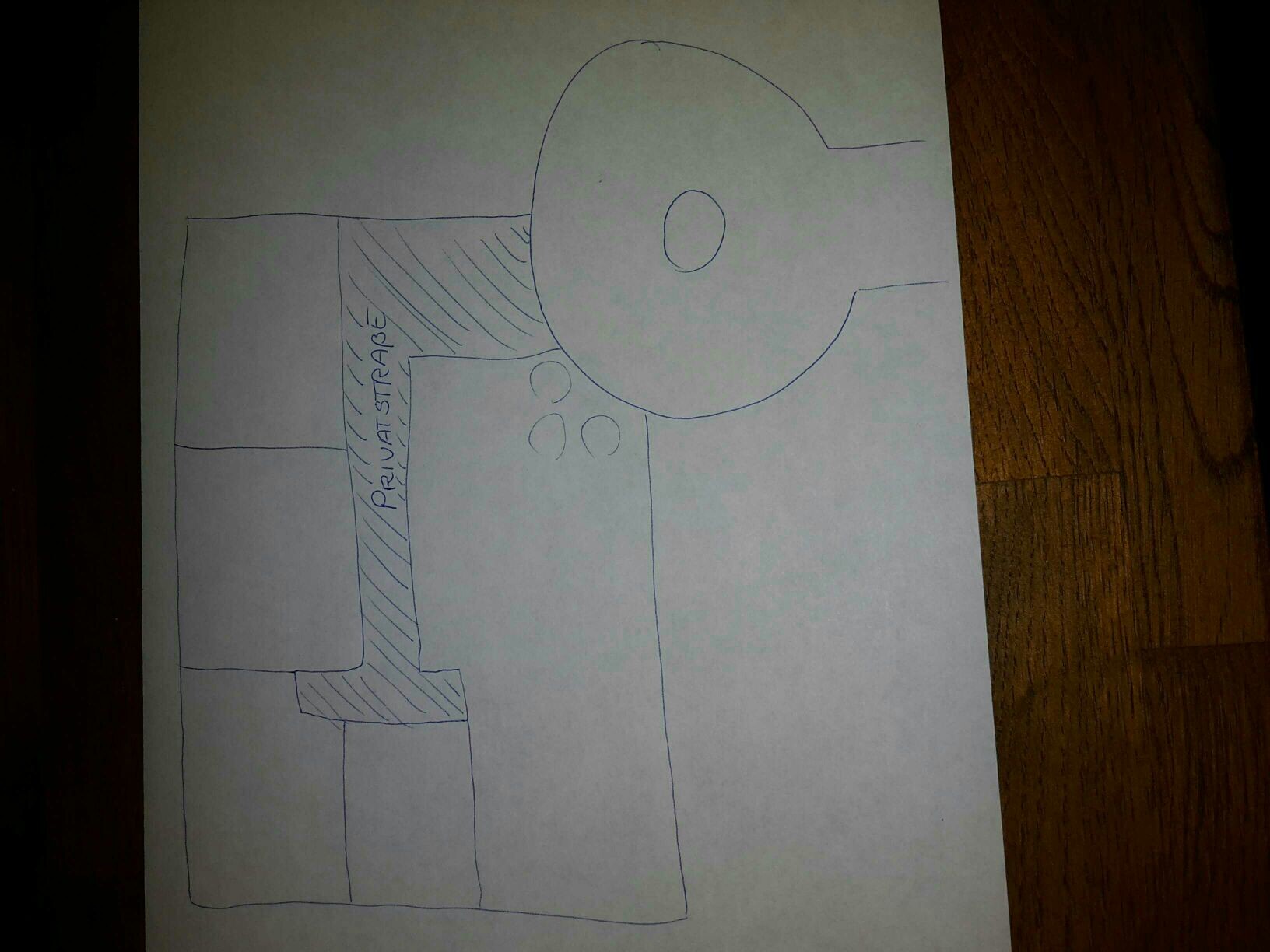

ph710 schrieb:
We all need the road to access the public street.That means none of the plots border directly on the public street – so how does the private road do it? Did you leave the road "private" after completion?
So none of the plots border directly on the public road – how does the private road then connect? Did you keep the road "private" after completion?For example, see attachment. Plots 1–5 are located in the second row, and the newly constructed private road (red) connects the private properties with the public pathway area (green).
@TE: As always, a plan helps. In general, I suggest handing over the road to the local authority at the end of development, if at all possible. Exceptions prove the rule.
Dirk Grafe
So none of the plots border directly on the public road – how does the private road connect then? Did you keep the road private after completion? One plot touches the public road at a corner. It is not yet built on. There are three trees in that corner.
We were only able to purchase these plots by acquiring shares in the private road.
This is common practice in this area.
