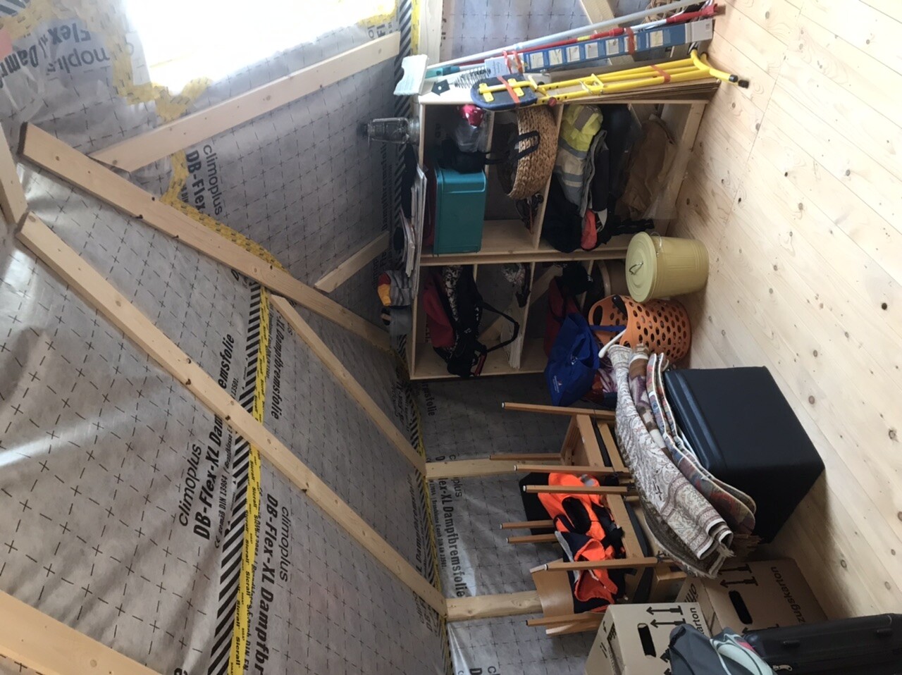

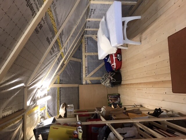

To create a frost-free and not overly hot storage room in summer, we recently insulated the attic space above the ceiling. A carpenter and I worked together as helper and tradesperson. The room has a Velux window for ventilation. We used about 100 sqm (1,076 sq ft) of 160mm (6.3 inches) compressed mineral wool, which was sufficient for our needs – thicker insulation wasn’t necessary. In addition, we installed 100 sqm (1,076 sq ft) of breathable membrane, 40 meters (131 feet) of batten, 240 meters (787 feet) of cladding boards, 5 cartridges of adhesive for the membrane, 4 rolls of foil tape such as SicaCrall, and three boxes of Spax screws.
We chose the breathable membrane instead of a standard vapor barrier as a precaution, because the space is sealed in winter but the insulation can dry out in summer if any moisture gets in. The carpenter was very meticulous in ensuring that the membrane was sealed tightly everywhere, which he considered very important. The two of us took about 2.5 working days in total, or around 20 hours each. The outcome is very satisfying. The space feels completely dry, comfortably tempered, and not stuffy. I occasionally ventilate through the Velux window. We will see how it performs during winter.
Costs: $1,500 for materials, 20 hours labor.
