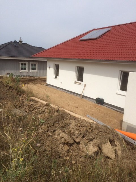

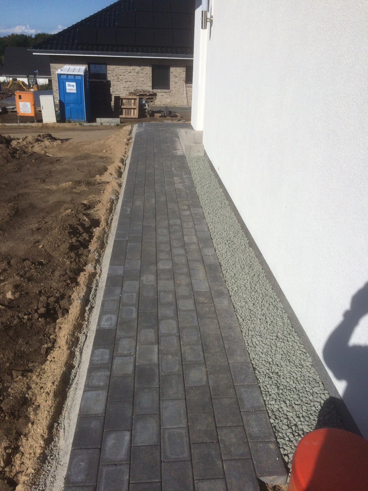

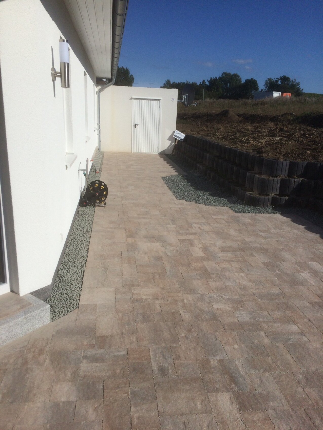

Guys, you shouldn’t compare apples and oranges. What I paid for the 72 included filling, a stair landing, and a pebble border around the house.

Nordlys, that looks really stylish. I like the pebble edge. What type of gravel did you use there?

As far as I can see, your installation is not just a simple “staggered” pattern but a bit more complex. The pebble edge is a good idea. Was the width planned like that?

Gravel refers to crushed granite material, which is probably the cheapest option available. Stones, for example anthracite rectangular pavers, cost 11.00 gross per square meter (10.8 sq ft) here, while the beige ones are Diephaus via patio, at 17.50 per square meter (16.3 sq ft). Both are concrete pavers. Natural stone paving is significantly more expensive.
