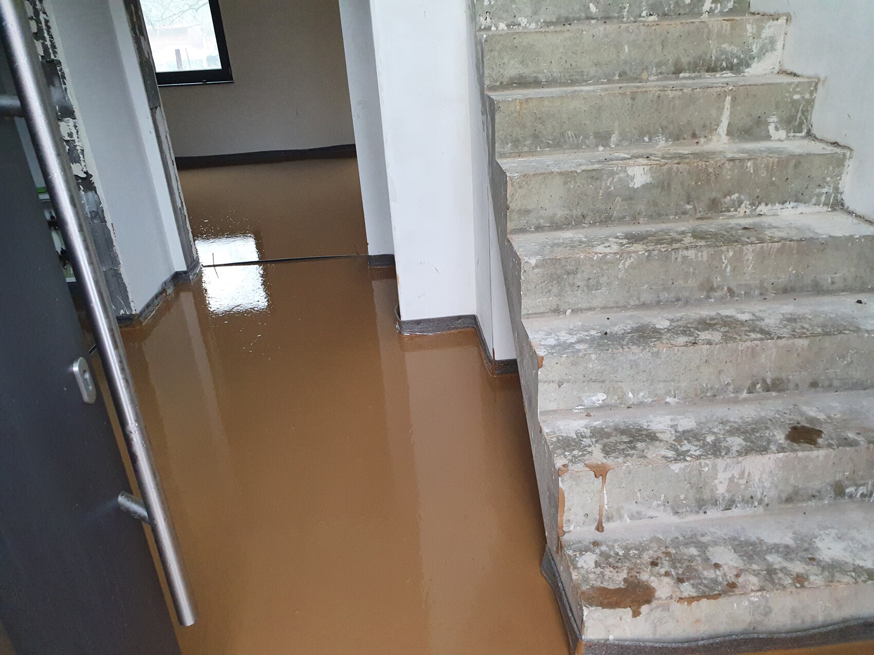

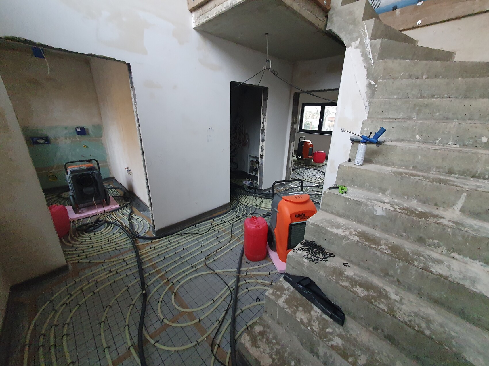

MDLASERCUT31 Jan 2021 13:47What is happening at the construction site? Have the water damages been repaired yet?
What is the timeline for everything that is still missing? By the end of March sounds quite ambitious. The screed also still needs time to dry.
