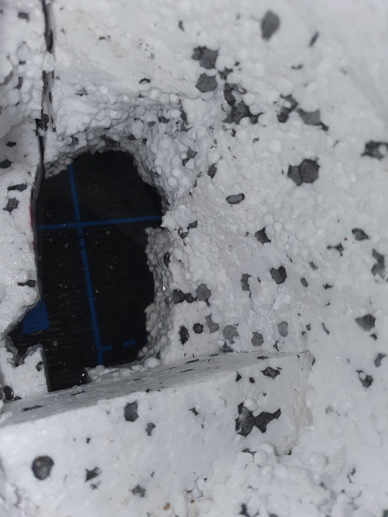

More precisely, the filling line hose of the heating system came loose, and the shut-off valve was not completely closed.
The water meter shows 38 cubic meters (cubic yards), although I don’t know how much the masons and plasterers have used.
At least I was somewhat lucky in this misfortune. If the concrete mixer with 8 cubic meters (10.5 cubic yards) of screed had been waiting outside as planned, it would have been even more expensive.
I find a certain irony in the fact that this happened in the trade I actually trained in. It was stupidity. There’s no sugarcoating that.
Tomorrow the drying company is coming, charging 1100 euros plus electricity costs for the drying process.

Today the drying company is coming to set up the equipment.
The insurance will cover the costs of around 1500€ (approximately 1600 USD).
The positive side is that I get free building drying this way 🙂

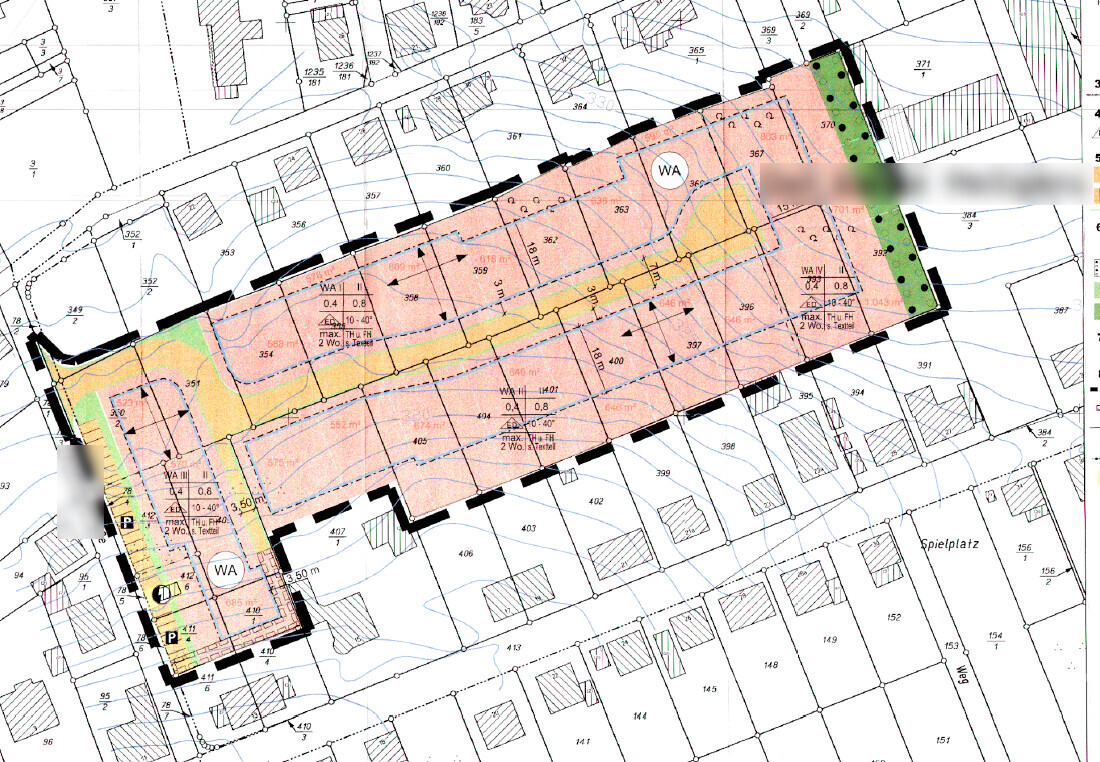

We have been waiting for two years for the development of a new residential area in our town. The plan was to sell our current house afterward.
Today I found out that the development was sold to a regional general contractor.
That felt like a punch in the stomach. Obviously, I will never be able to build as affordably with the general contractor as I could before. It’s really quite frustrating.
