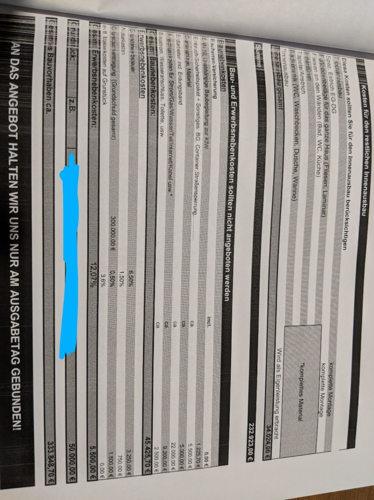

OK, got it. I will handle the exterior landscaping directly.
I have uploaded the offer.
Preisangebot-Dokument mit Tabellen und Bauleistungen, Beträge sichtbar
Foto einer Bauleistungsseite mit Leistungsumfang für ein Haus und Details

300,000 is still quite a bit more than what the original poster is aiming for. ;-)
Just the porch in front of the front door easily costs around 2,000. Then there are paving stones for the essential outdoor areas, new furniture because the old couch no longer fits... each of these alone is already a separate expense that can match or exceed a Christmas bonus and/or tax refund. Having to decide whether to buy new furniture first or something else is, in my opinion, very unsatisfying.
Edit: Just skimmed the quote. What do you want with a quote from 2017? ("February discount 2017")?

Can anyone read this?
Nordlys
15 Aug 2018 09:29
Sure. Easy to read.
For example, it says that all the insulation is only delivered, not installed.

And the usual gimmicks with these "turnkey" offers: downspouts only extend just above the ground, no drainage, no internal infrastructure, the garage is only included as planning service, and so on. And especially without any detailed specifications. Electrical and plumbing services often represent major expenses.
What exactly does interior finishing as an owner’s responsibility mean?
