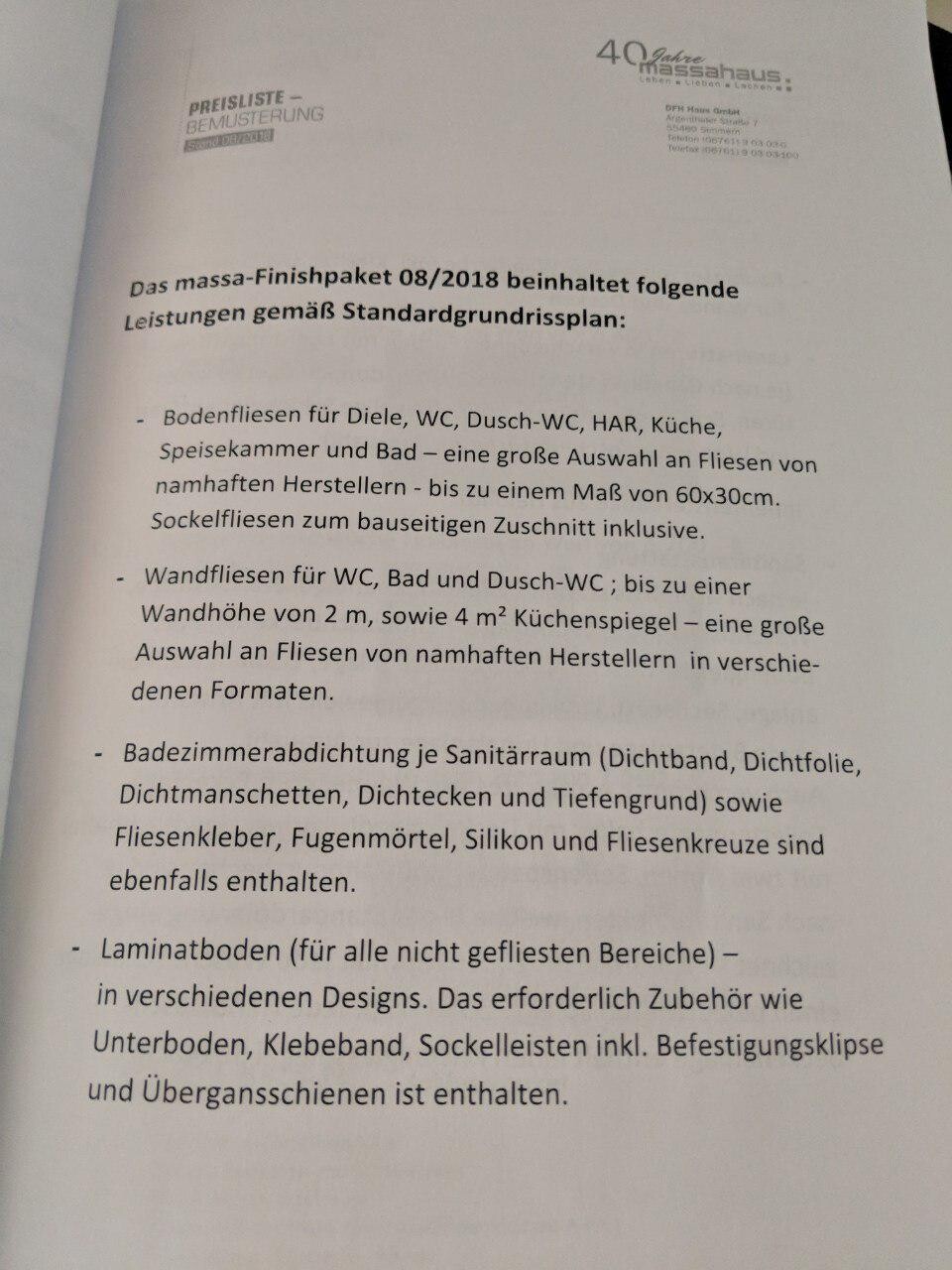

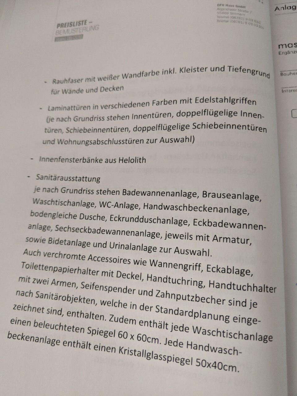

A garage is not planned for now. Is the upgrade included? Wallpaper, doors, tiles, etc. Interior finishing as own work means we do the tiling and painting ourselves. However, the materials will be supplied.
It's not that I want to defend the offer, I just want to understand where the mistake is.
So, it’s about a shell house without interior doors, window sills, floor coverings, and such...

nektus schrieb:
Here, regarding the upgrade, what should be included
These are packages that you can add additionally. They are not included in your house price.

15 Aug 2018 11:17
Interior doors are listed, as well as the coverings and so on. However, I’m not sure if the cost estimate is realistic. According to the consultant, everything should be included, but that doesn’t seem to be the case. I will ask him again for a more detailed breakdown, including how much has been allocated for coverings and so forth.

15 Aug 2018 11:20
nektus schrieb:
Interior doors are listed, as well as the coverings, etc. However, I’m not sure if the cost estimate is realistic. According to the consultant, everything should be included, but that doesn’t seem to be the case. I will ask for a more detailed breakdown again, including how much was budgeted for coverings and so on.
Have you finalized the selections for this? I don’t see it on your quote!
