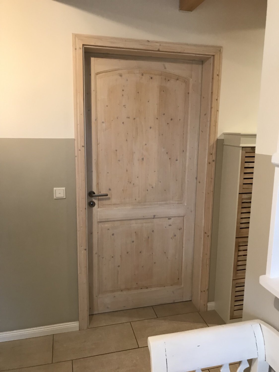

Do you have a photo?
In my 80 square meter (860 square feet) apartment, I also have 1-meter (3 ft 3 in) wide doors.
They seem a bit too large. In a bigger house, they might look better.
Please, no comments about the paint,
that was a quick job and no professionals were involved (me).
