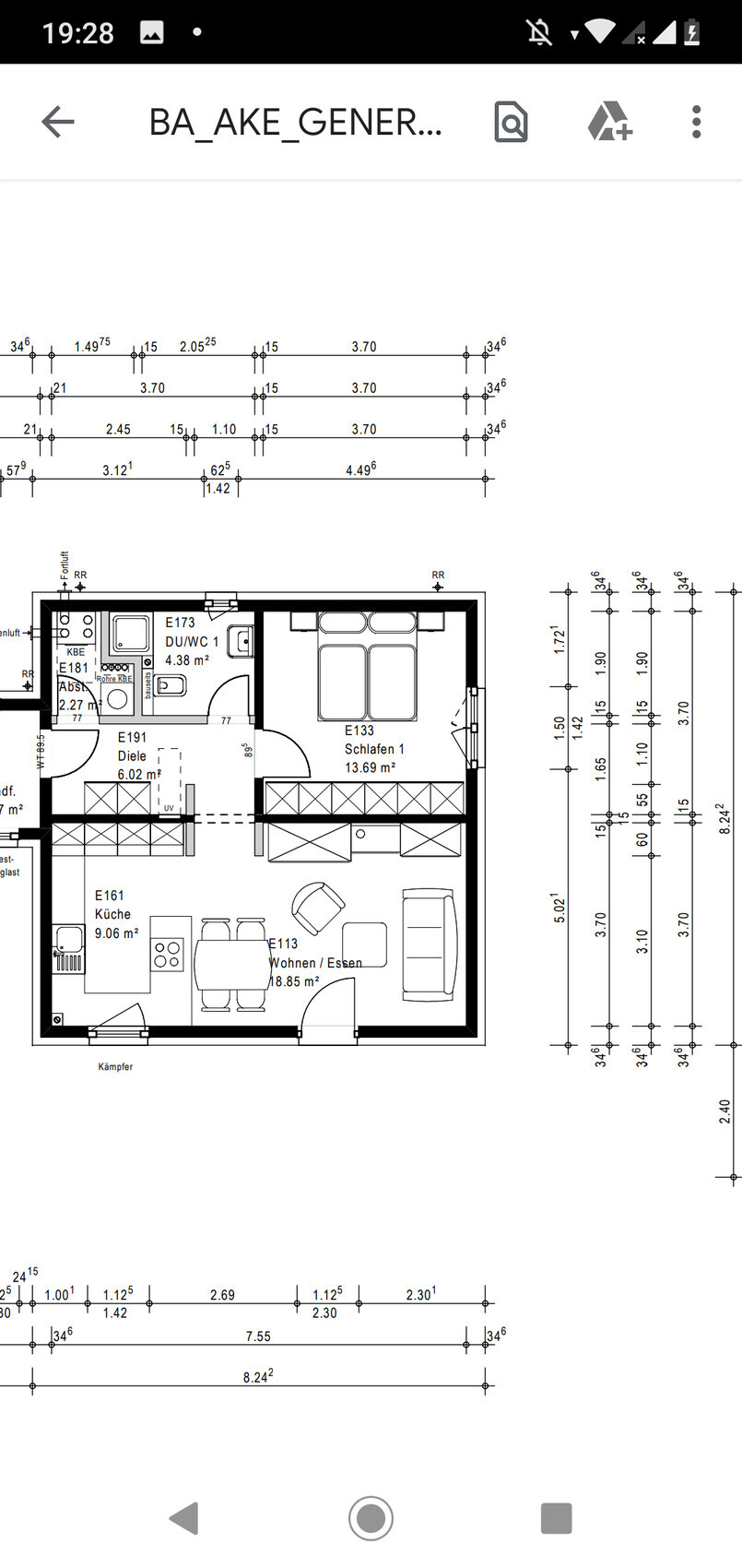

Hi, we are building a house with a very well-known prefab house company, and this is the preliminary floor plan.

We searched a long time for the ideal house for us and my parents and finally found it. Before signing next week and starting construction, we want a last check. Any improvement suggestions? Maybe how to enlarge the living room? Thanks in advance. PS: we want to remove the windows marked in yellow. All windows in the house are floor-to-ceiling.

The provider reminded me of being aggressive and inflexible. At least the salespeople were. Officially, we are only allowed to change non-load-bearing walls and minor details like windows. However, the architect was still able to modify a few things. I’m very curious now whether the additional changes we want can be realized. The extension of the Generation 8 model is actually the largest they offer, and choosing a bungalow would have been too expensive and wouldn’t have fit on the plot. It was already a tight situation.

Can you upload the photo in better quality?
Unfortunately, it’s not readable.
Have you already been to the building specification appointment, or are you going for a shell house? If you click on it, it gets larger and the quality is good.
We are going for a shell house without floor coverings, etc., and we are subcontracting all trades ourselves or doing a lot of the work personally.
