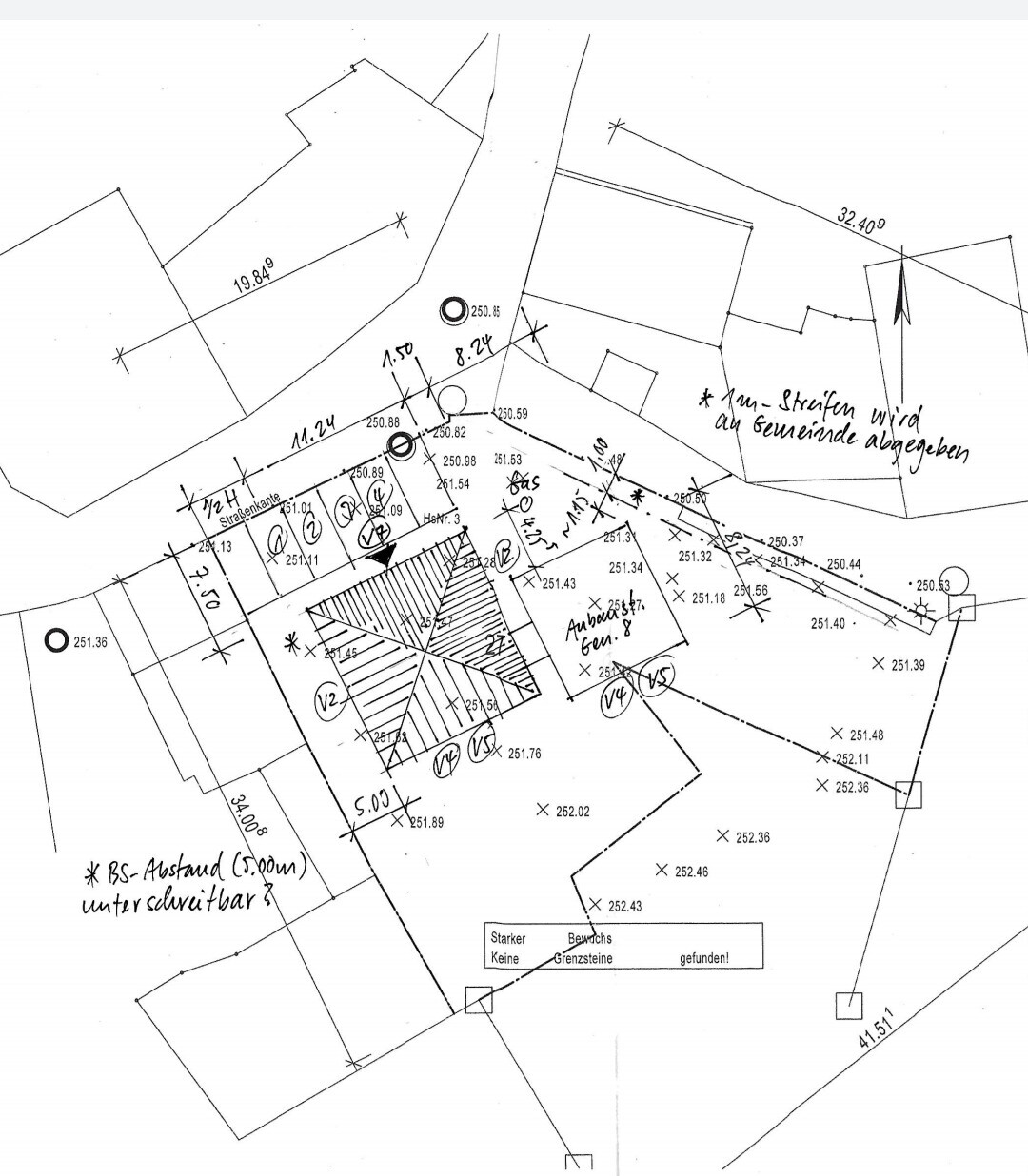

Site plan of a building plot: parcel 27 with red outline and building areas.

I would just like to know how much width there is. Do you have the overall plot dimensions? Anything at all? What information do the architect or the house builder have?
L
Laufi92
15 Oct 2019 08:56
kaho674 schrieb:
I would just like to know how much space there is in width. Do you have the overall plot dimensions? Anything? What did the architect or the house company say?
Oops, yes, I do have that, sorry, I thought you meant something else.
Site plan of a building plot with measurement points, boundary lines, and building outline.
kaho67415 Oct 2019 09:04
What about the 5m (16.4 feet) on the left side of the plan? Is there any regulation that requires it to be at least 5m (16.4 feet) instead of the usual 3m (9.8 feet)?
I'm asking because if we don’t have any options in width, there’s hardly any point in considering a wider connecting structure.
The 2.15m (7.1 feet) on the other side is also quite unclear. Is that a public path with just a 2m (6.6 feet) setback, or something similar? Are you giving 1m (3.3 feet) to the municipality? Why is that? I wouldn’t give anything away.
This might sound a bit annoying, but without exact figures and facts, we only understand half of the situation here.
L
Laufi92
15 Oct 2019 09:07
kaho674 schrieb:
What about the 5m (16 feet) on the left side? Is there any regulation why it can’t be just 3m (10 feet), as is usually the case?
I’m asking because if we don’t have options for the width anyway, pursuing a wider connecting structure doesn’t really make sense.
The 2.15m (7 feet) on the other side is also quite unclear. Is that a public path with only a 2m (6.5 feet) setback or something? You’re giving 1m (3 feet) to the municipality? Why is that? I wouldn’t give anything away.
This might sound a bit annoying, but until we have exact numbers and facts, we can only understand half the situation here.
There is a large building directly on the boundary on the left side, so we need to maintain the distance due to fire protection regulations. We’re happy to give the one meter (3 feet) to the municipality because they will also remove a terribly ugly and old wall for us, haha. The reason for this is that the garbage collection can’t get through at this point, and the municipality would pay us a considerable amount for it. This road is public, so we are allowed to build closer as long as we respect the required setbacks.

kaho67415 Oct 2019 09:42
I assume the external dimensions are difficult to change because they follow certain module sizes in the prefabricated house? Or are you completely free to adjust them?
