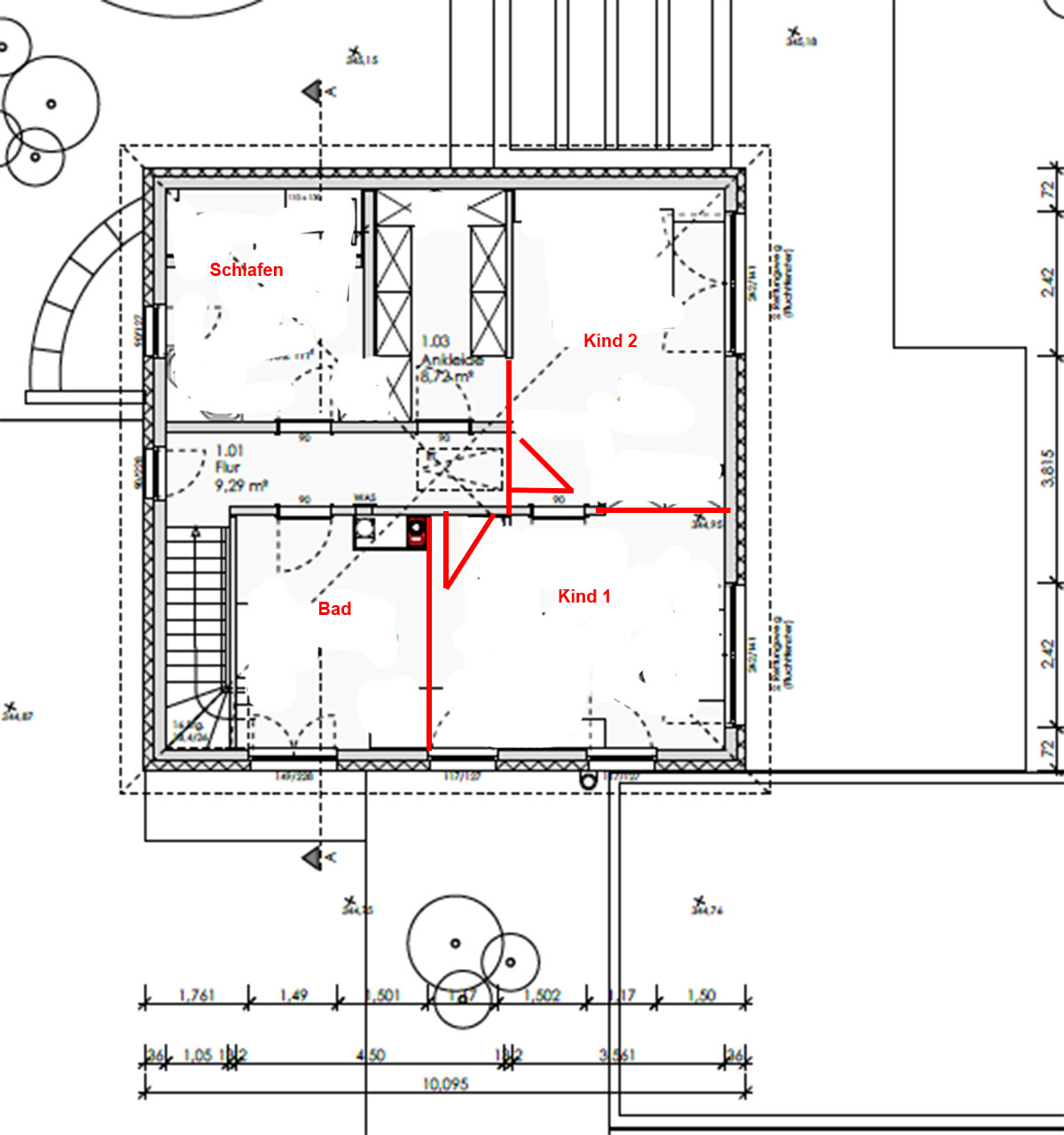

Another thing that bothered us is the small “nook” in the bedroom, so I adjusted our new proposal for the architect under “OG_NEU.”

mynhma schrieb:
- Regarding the upper floor, yes, we are still having some difficulties... Last night we discussed a slightly revised version where we would use the niche for a built-in closet in the hallway as a small utility storage space. That way, we would have a nice straight wardrobe and TV wall in the bedroom, the first child’s room would be enlarged, and by moving the wall in the second child’s room, the children’s rooms could be made more equal... What do you think about that?
No idea. We definitely need a sketch for this. Nobody can keep track of it all in their head anymore. 😉I don’t know how fixed the layout upstairs is. But we could still shuffle things around a bit. Here’s an alternative sketched out:
