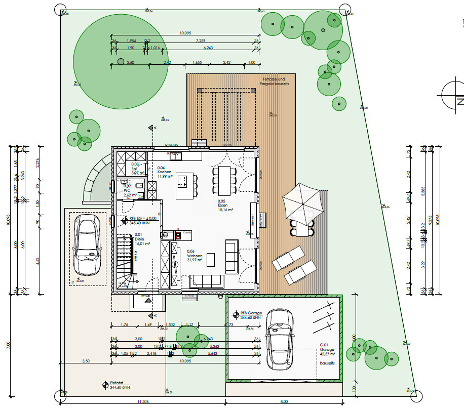

Besides the large living/dining area, our personal highlights are the window seat and the fireplace. Do you think the empty space between them is wasted?
Before the first question comes up: we couldn't orient the terrace to the south because, first, the building boundary limited us, and more importantly -> to the south we would be looking at the neighbor’s elevated terrace, while to the north there is a beautiful orchard meadow with several hundred meters of view. To the west, we also have a neighbor with two full floors, but since we have almost 10 m (33 ft) of garden space, we hope that will be enough.
What personally concerns me a bit is the empty space between the kitchen/dining area and the living room. Originally, we planned to place the fireplace in the middle there, but my wife didn’t want to split the room that way.

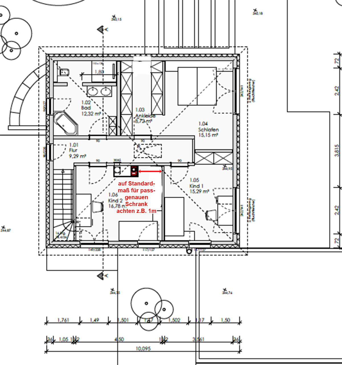

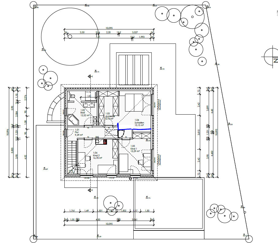

Another thing that bothered us is the small “nook” in the bedroom, so I adjusted our new proposal for the architect under “OG_NEU.”

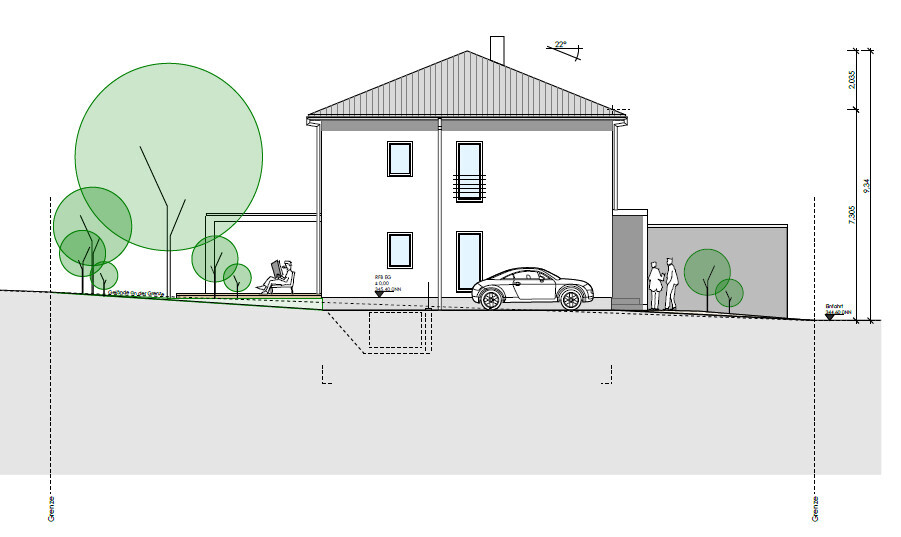

Außenansicht eines Einfamilienhauses mit Garten, Auto und Bäumen als Planzeichnung

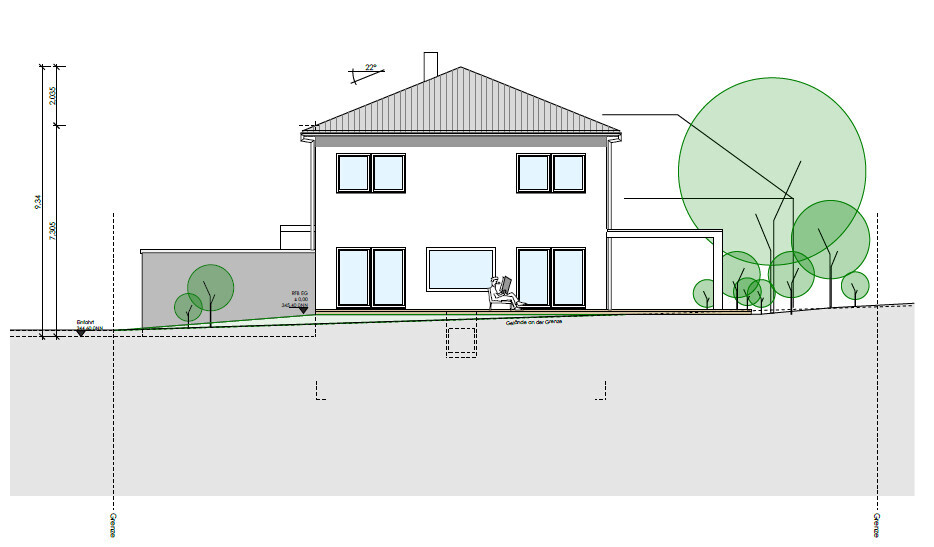

Außenansicht eines zweigeschossigen Hauses mit Garage, Einfahrt und Garten.
Ansicht eines Hauses mit Garten und Geländeprofil als Grundstücksplan
Architektur-Elevationszeichnung eines Hauses mit Dach, Fenstern und Bäumen

RobsonMKK4 Dec 2017 17:48
What I notice is that a walk-in closet can accommodate a window. The wardrobes shown in the plan don’t really work anyway. I also think it would improve the exterior appearance.

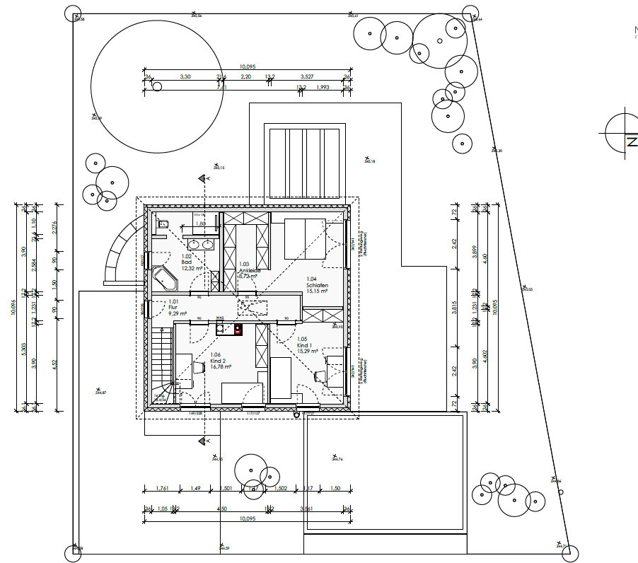

I would simply extend the wall in the bedroom on the upper floor. This creates a deeper recess on the children's room side, which can be fitted with a small walk-in closet, similar to American designs.
I strongly recommend planning the kitchen or having it planned. I find it somewhat incomplete as it is.
And, really no supports or visible beams in the living room? I would definitely ask again about that.

And then, on the ground floor
I would probably place the living room at the top left of the plan (so South/West), then the dining room at the top right, and the kitchen area at the bottom right.
A pantry (but why, actually? Maybe better to have a small storage room on the ground floor for the vacuum cleaner, etc.) and a guest toilet would then be located to the right of the entrance.
This way, the large room could get a bit more South/West light.

I would leave everything as planned by the architect, except for adding an extra window in the walk-in closet. The upper floor is designed for soundproofing in a way that there is no direct wall between the bedroom and the children's room without at least some wardrobes placed in between. Think carefully about this.
In my opinion, the wardrobes in child’s room 2 are poorly designed – I would focus on custom-fitting them to the niche. Possibly also consider a corner wardrobe, which I would select in advance.
Otherwise, I think it’s very good. The "empty space" in the living room is, in my opinion, not wasted, as it serves as a central living area. I would also not change the orientation, for the reasons you mentioned.

- We had the window in the dressing room installed but then removed it... The issue is that directly opposite, at the same height, there is a neighbor’s window, and when changing in the dressing room, you don’t want to be observed. This would mean the window would always be covered or have the blinds down. So, we thought it would be better to use that space for storage since my wife needs as much closet space as possible. 😀
-> We will reconsider this though.
- Unfortunately, a complete redesign of the ground floor is not an option for us... As mentioned before, we want to take advantage of the nice north side in the living area as much as possible, and a full layout change would affect that. We have already discussed this option in this version, so thanks for that!
- Regarding the upper floor, we are still unsure... Last night, we discussed a slightly adjusted version where we would use the niche in the hallway for a built-in closet as a small utility storage. This would allow for a nice straight closet and TV wall in the bedroom, enlarge Child 1’s room, and by moving the wall of Child 2’s room, the children’s rooms could be balanced out... What do you think of this?
