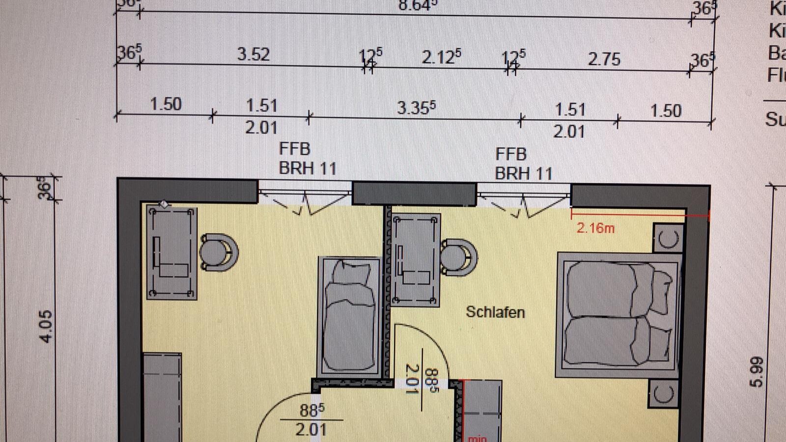

We made a few small changes to the floor plan ourselves since our draftsman is on a long vacation. That’s why some measurements are not accurate (bathroom on the ground floor and utility room). The wall between Child 1’s room and the master bedroom was moved 50 cm (20 inches) toward the master bedroom, so those dimensions are also not exact.

So, where the closet is drawn now – doesn’t the person sleeping next to the door need a nightstand? What is supposed to be the advantage?I imagined it this wayThe niche is 280 cm (110 inches) wide... which really raises the question of where the person sleeping near the door is supposed to put their bedside table, or how much space the person sleeping along the exterior wall will have left before the wall. Also, you want to move the wall further to the right according to the plan.

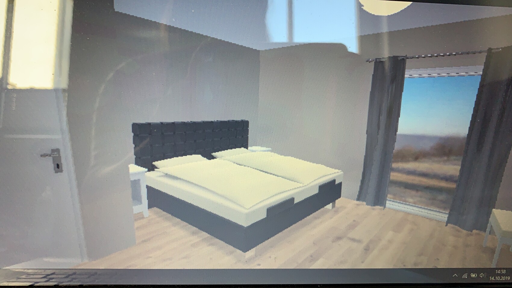

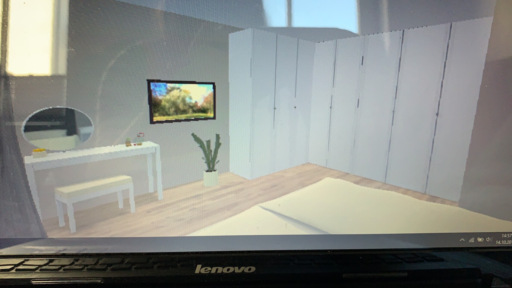

Franzi050822 Oct 2019 07:38I’ve now reversed it in the bedroom, see pictures. This is not a desk but a vanity table.

I’m confused about moving the wall there.
The bedroom might become a bit tight with a dressing table and bed.

Franzi0508 schrieb:
I imagined it like thisSo how exactly then? - In 3D it doesn’t look that bad, but the floor plan is more realistic, meaning it doesn’t work with bedside tables. The person getting out of bed practically stumbles right into the bed. In this bed, you’ll feel like you’re in a horizontal closet – what’s the advantage compared to the original position: effectively just under one meter (about 3 feet) of extra wardrobe space? – and that only because there’s no other place for clothes for special occasions and for the other season!https://www.instagram.com/11antgmxde/

I would reduce the size of the bedroom to give more space to the kids’ rooms. You sleep and get dressed there, but don’t use it much otherwise. Your children also need space to spend time in their rooms during the day.
The hallway is quite large and ultimately just wasted space. Your children would probably appreciate having more room instead.
The entrance to the bathroom also feels awkward and isolated – there might be better layout options here.
The bed in child 1’s room and the shower location should be reviewed because of potential noise issues. But the bathroom layout is likely not finalized yet anyway.
