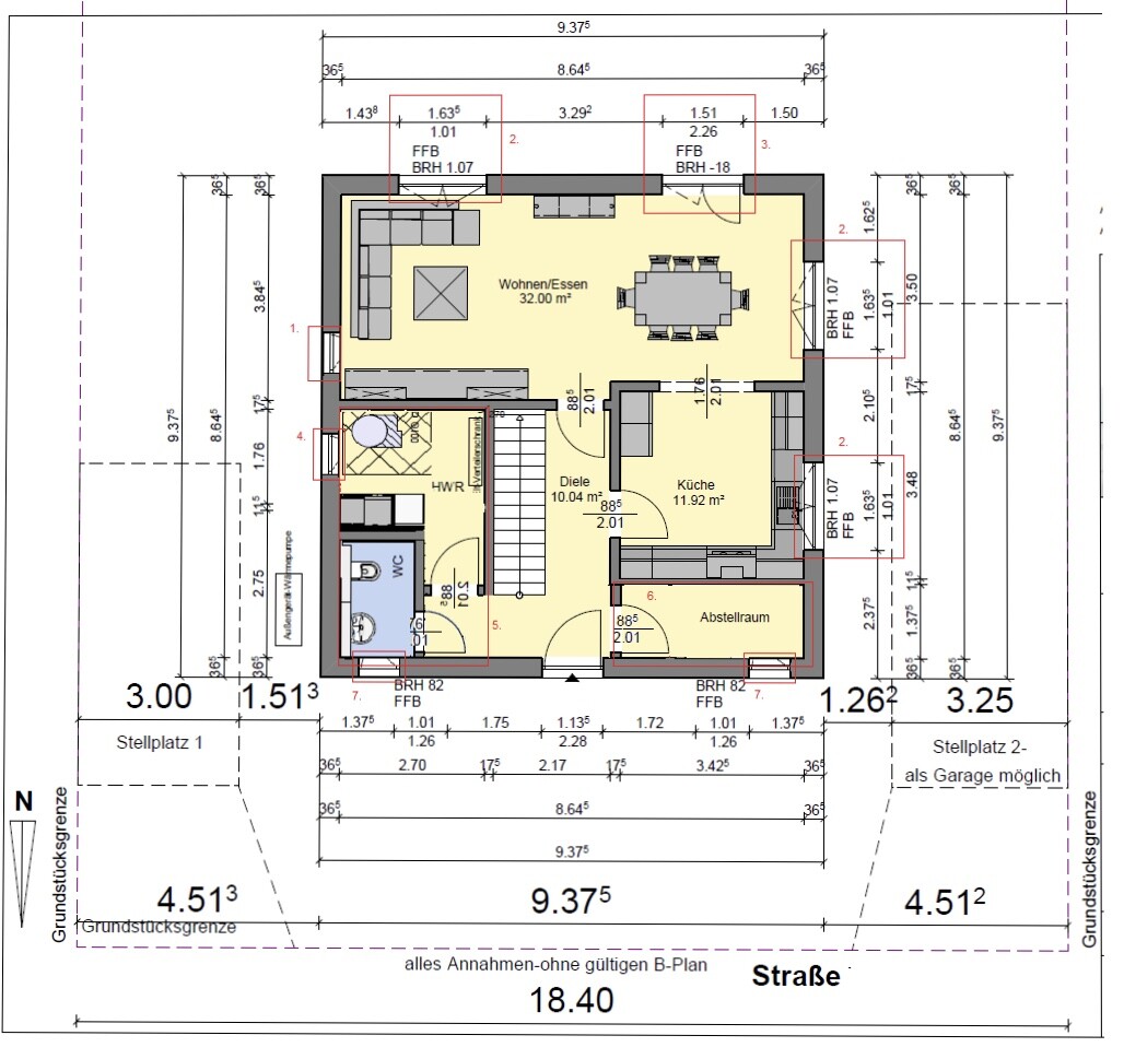

We are currently in the planning phase and would appreciate some input from experienced homeowners.

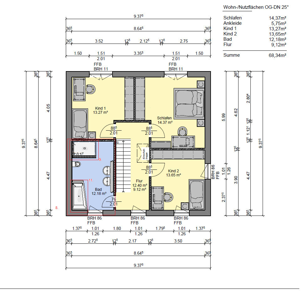

We made a few small changes to the floor plan ourselves since our draftsman is on a long vacation. That’s why some measurements are not accurate (bathroom on the ground floor and utility room). The wall between Child 1’s room and the master bedroom was moved 50 cm (20 inches) toward the master bedroom, so those dimensions are also not exact.
Windows are planned as follows:
Living room: window 1.63 x 1.10 m (width x height) (5 ft 4 in x 3 ft 7 in), patio door 1.80 x 2.26 m (5 ft 11 in x 7 ft 5 in), fixed glazing 0.5 x 2.26 m (1 ft 8 in x 7 ft 5 in).
Kitchen: 1.63 x 1.10 m (5 ft 4 in x 3 ft 7 in).
Bathroom and storage room windows: 0.7 x 1.00 m (2 ft 4 in x 3 ft 3 in).
The bed is planned to be placed in the niche in the bedroom.
Looking forward to your suggestions for improvements

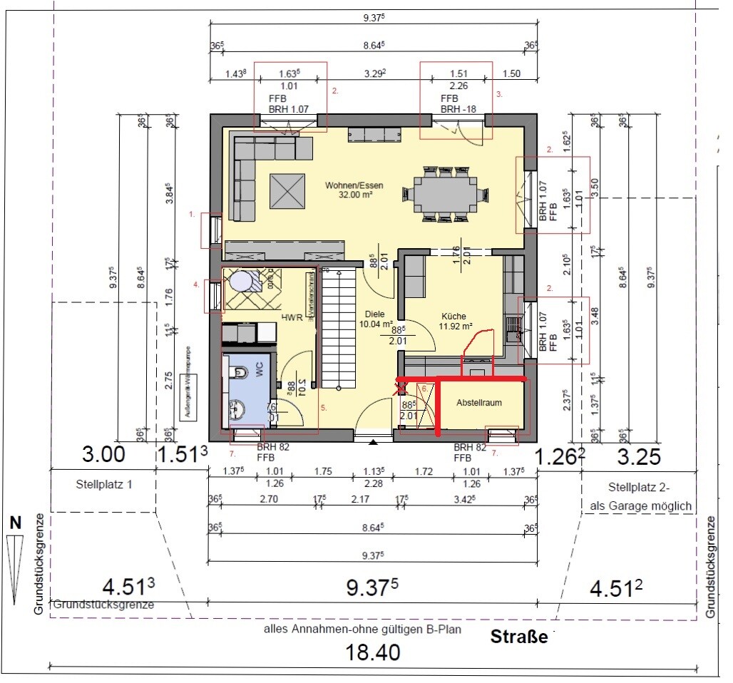

I would design the storage room on the ground floor differently. Turn it into a proper walk-in closet and a separate pantry, possibly accessible from the kitchen.
Attached is a suggestion with slightly optimized walls:

I would make the kitchen a bit smaller (especially if the storage room is also being used) and rather give the dining area more space – 3.50m (11.5 feet) is not much. You also want to comfortably access the patio door without having to squeeze past the chairs, while also being able to get to the kitchen. As it is planned now, there isn’t much room left on either side.

How much space should be planned for this?

Well, you could simply remove the "edge" in the dining area, meaning move the wall down to be flush with the living room wall. I think that should be more than enough; it's about 35cm (14 inches). The kitchen can handle that, and you can’t really plan anything special in there anyway (sorry about that).
