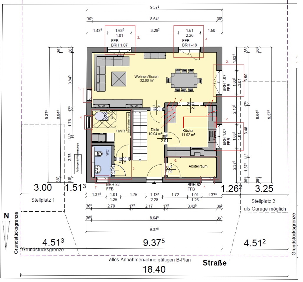

We are currently in the planning phase and would appreciate some input from experienced homeowners.
We made a few small changes to the floor plan ourselves since our draftsman is on a long vacation. That’s why some measurements are not accurate (bathroom on the ground floor and utility room). The wall between Child 1’s room and the master bedroom was moved 50 cm (20 inches) toward the master bedroom, so those dimensions are also not exact.
Windows are planned as follows:
Living room: window 1.63 x 1.10 m (width x height) (5 ft 4 in x 3 ft 7 in), patio door 1.80 x 2.26 m (5 ft 11 in x 7 ft 5 in), fixed glazing 0.5 x 2.26 m (1 ft 8 in x 7 ft 5 in).
Kitchen: 1.63 x 1.10 m (5 ft 4 in x 3 ft 7 in).
Bathroom and storage room windows: 0.7 x 1.00 m (2 ft 4 in x 3 ft 3 in).
The bed is planned to be placed in the niche in the bedroom.
Looking forward to your suggestions for improvements

How much space should you plan for?I would just roughly plan for the cabinets and appliances you need, and that will give you an approximate size. It might actually be 30–40 cm (12–16 inches) less, which would make the dining area just under 4 m (13 feet), likely a bit more comfortable. Maybe you could also consider adding a counter?
