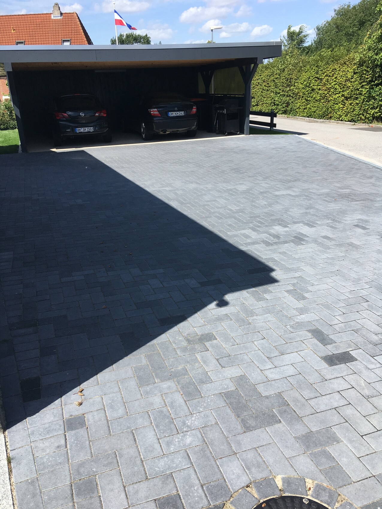

A carport is better because ventilation is improved; in a closed garage, moisture cannot escape as easily. Just for your information: a garage door for a double garage or double carport costs around 2400 Euro. I also built a carport measuring 7 x 7 meters (23 x 23 feet), with the roof overhang it is 8 x 8 meters (26 x 26 feet).
