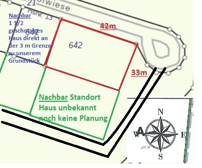

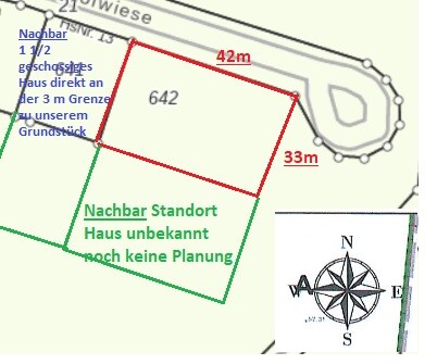

Crax237 schrieb:
The direct neighbor has built a one-and-a-half-story house right on the 3m (10 feet) boundary line. And that would be the red rectangle?
Crax237 schrieb:
We still don’t know which house will be built on the available southern plot. The southern one doesn’t belong to you?
Which one, or in other words: where is your plot located?
Crax237 schrieb:
All floor plans still need to be mirrored. Then do that. Mirror the floor plan and show the plot—ideally place it to scale where you imagine it.
Both floor plan designs have their weaknesses. But you should already be aware of them since you copied the plans from the forum posts here.
So there’s no need to discuss the flaws further. The forum community tends to remain silent at some point, especially when something is actually being built.
One thing, though: the second plan is completely unacceptable (with a child), as it offers no privacy—not even for the bathroom—and appears amateurish. The first plan, with the open kitchen as you envision it, at least has a dining area.
Ultimately, the plot needs to be known.

Regarding the plot of land:
Red: The outline shows our future plot. Length 42m (138 feet), width 33m (108 feet).
Green: represents the neighboring plot where we have no information about what will be built.
Blue: A 1.5-story house is currently being built right up to the 3m (10 feet) building setback line, with only two small windows facing our plot.
We are having difficulty deciding the best placement for the bungalow type/shape (L-shape or angled bungalow) — whether centered, left, or right. Intuitively, we would also build right up to the neighbor’s boundary in order to enjoy the view into the approximately 42m (138 feet) open garden.
