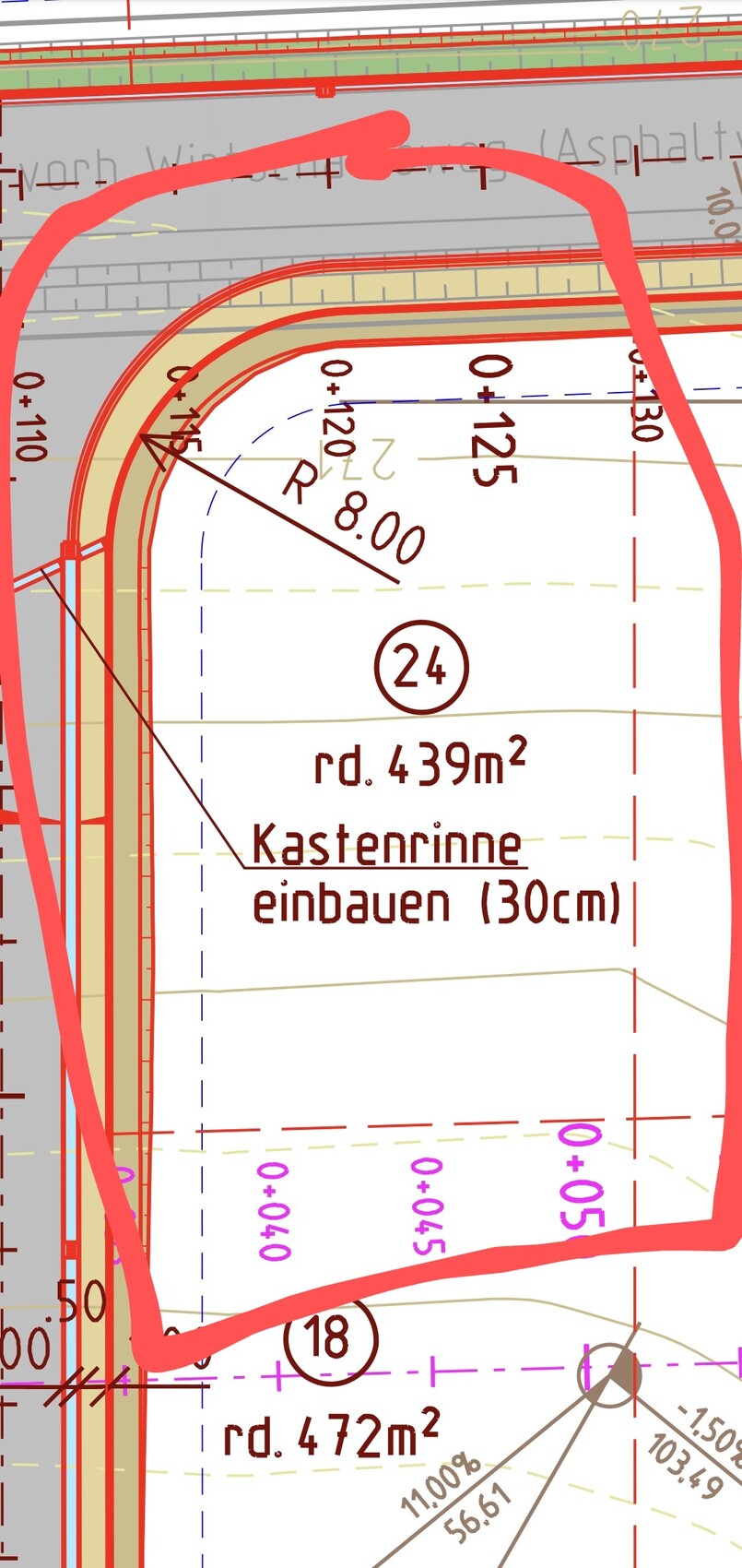

Plot size: 439m² (according to development plan – residential area not fully serviced yet, plot not surveyed. Front approx. 13m (43 feet) wide, widening to 17m (56 feet) after a curve, approx. 27m (89 feet) long)
Slope: Gentle north-facing slope, plot rises about 2.5m (8 feet) towards the south
Site coverage ratio: 0.3
Floor area ratio: 0.6
Building envelope, building line, and boundaries: See development plan excerpt. 3m (10 feet) setback from road, otherwise according to BayBO (Bavarian building code). Carports/garages may also be built outside the building boundaries (not at the rear)
Edge development: Fill or similar up to a maximum of 2m (6.5 feet) above traffic surface

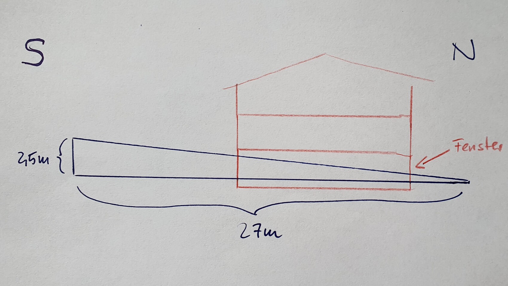

Basement and floors: Due to the slope and a need for plenty of (storage) space, we considered a basement (facing north and partially above ground), plus 2 full floors. Knee wall (kniestock) 1.6–1.8m (5–6 feet) if possible. Preferred roof type is gable roof, currently planned with a 25° pitch.

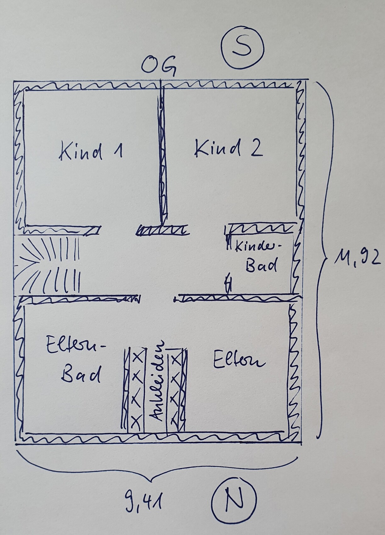

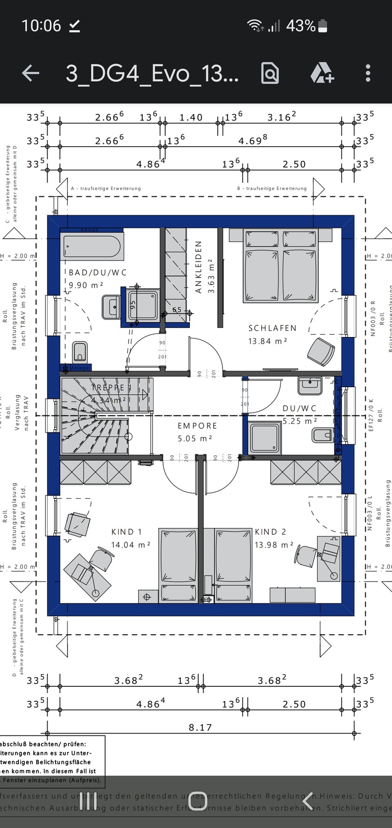

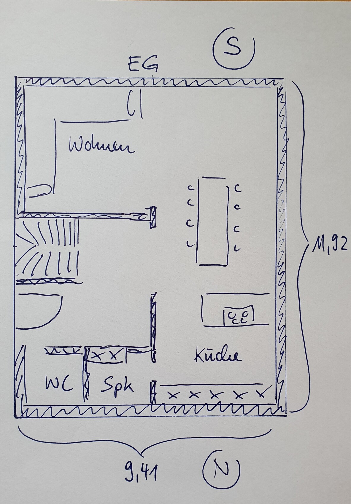

- We would like to modify the shown floor plans as follows (see hand-drawn sketches): In the basement, largest possible windows (light wells or shafts possible?) and 2 rooms as a living basement. On the ground floor, entrance from the east side, large hallway, pantry. On the upper floor, the children’s rooms should face south, the master area north. Generally, as many large windows as possible, especially in living spaces.

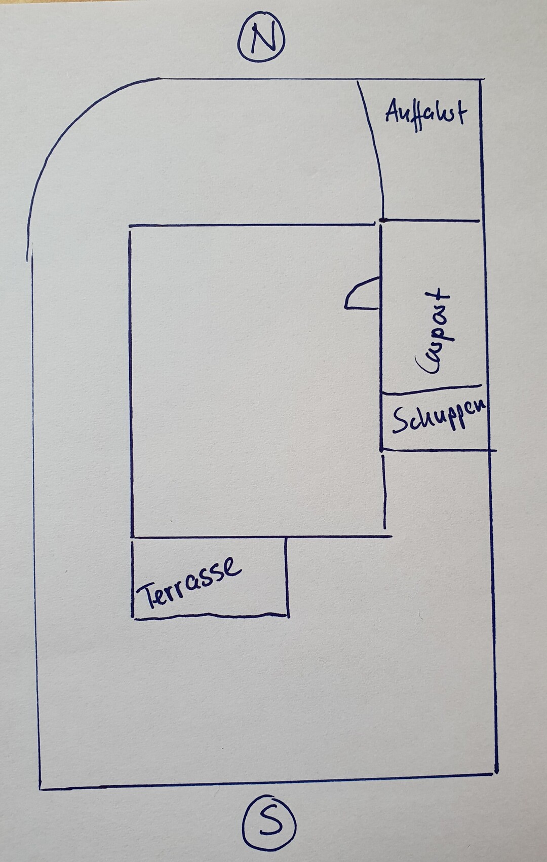

- We would like the carport including the shed described above to be located eastwards up to the plot boundary, preferably the full possible 9m (30 feet) length and as wide as possible when the house is sited as close as possible to the road on the west side. However, with the front door on the ground floor, the driveway to the carport would slope upward. The carport should also provide the canopy over the front door.

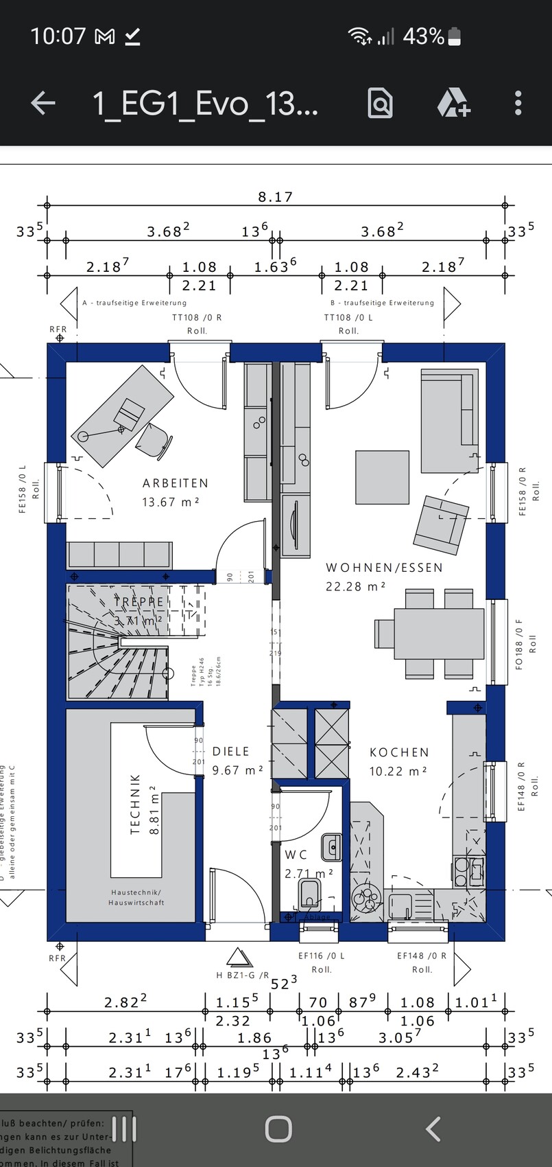

Who created the design: By us based on the “Evolution139” by Bien-Zenker plus “grid extensions”. Exterior dimensions based on current calculation 9.41m + 11.92m (31 feet + 39 feet).

- We are unsure about the best layout for the entrance area including wardrobe/guest toilet/pantry. Should the hallway’s access to the living area be aligned with the front door or the stairs?
- As currently planned in our heads, only the guest toilet and master bathroom are stacked vertically. Children’s bathroom and utility room are in different areas – will this work?

The floor plan screenshots come from the catalog or a preliminary plan from the seller. The hand-drawn floor plans reflect our ideas for the layout and the plot arrangement. I haven’t added windows yet.

- Does the plot layout make sense? Are there better alternatives?
- Are the carport and driveway feasible (incline? space by front door?)

- How much space is needed for light wells in front of basement windows?

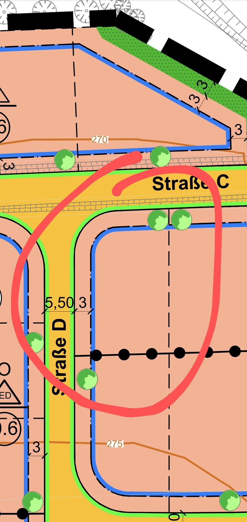

hanghaus202314 Feb 2023 14:44Then please tell us the zoning plan so that it can be found online.
Especially on a slope, you should know everything that is included.
Are you sure the driveway is allowed there? There is a tree shown in the zoning plan.

Unnerfranggn14 Feb 2023 14:52hanghaus2023 schrieb:
Then please tell us the development plan so we can find it online.
Especially on a slope, you should know everything that’s included.
Are you sure the driveway is allowed there? There’s a tree marked in the development plan. This is about the new residential area "Bickelsgraben" in the municipality of Rimpar. The plan can be found on the "Projects" page. Is that enough? I’m not sure how precise one needs to be here ;-)
The trees shown in the plan are just examples. We need to plant one, but I believe the location doesn’t matter.

Less commendable (dear readers, please DO NOT copy this point!) is the commitment with the preliminary contract. What I do like, however, is using a catalog house as the basis for planning (although I haven’t yet identified which version the base model was in this case). What do the interior walls in blue and gray mean? I assume the expansion grid refers to increments of 62.5cm (25 inches), but what were the original dimensions?Yes, about the preliminary contract... We hardly got started and have already done and sold quite a bit, which we’d rather count as mistakes. But it is what it is now, and I hope they’ll build us a nice house 🙂
The original house is the “Evolution139,” with original dimensions of 8.17 x 10.67m (27 x 35 feet).
The grid extensions were told to be the most cost-effective way to enlarge the footprint, cheaper than, for example, a bay window…
The currently planned dimensions are 9.41 x 11.92m (31 x 39 feet). These are also the basis for the price calculation.
Edit: I don’t know why the walls in the “nice” plans have different colors. In my sketches, I probably just pressed harder in some places...
In the site development plan excerpt, it can be seen that the property lies on a boundary line (“Knödellinie”), so different regulations likely apply for the southern neighbors. The data there suggest a north-south slope of 80cm (31.5 inches) total and a transverse slope of 5cm (2 inches) per 5m (16 feet), but I don’t understand the indication of 2.5m (8 feet) fully—this is also a crucial factor (“gamechanger”) concerning the basement regulations.On the mentioned page, besides the site development plan there is also the civil engineering plan, from which I read the height data (yellow wavy line?). But otherwise, I don’t read building plans... 😉
hanghaus202314 Feb 2023 16:18I also find the foundations exemplary.
A small suggestion for improvement: always orient all plans uniformly to the north.
