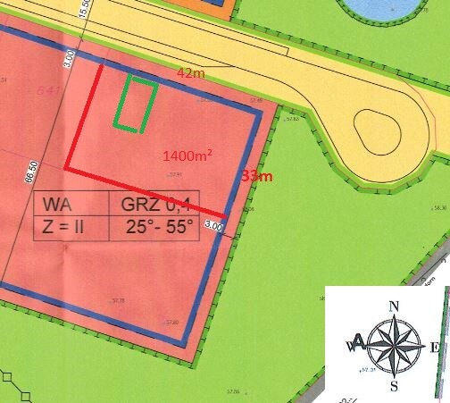

After going through numerous catalogs and floor plans, we have come across two floor plans in this forum that appeal to us much more than the ones in the catalogs.
Could you give a recommendation on which floor plan would make the most sense for the plot linked below?
Development plan: none / restrictions
Plot size: 1400 sqm (0.35 acres)

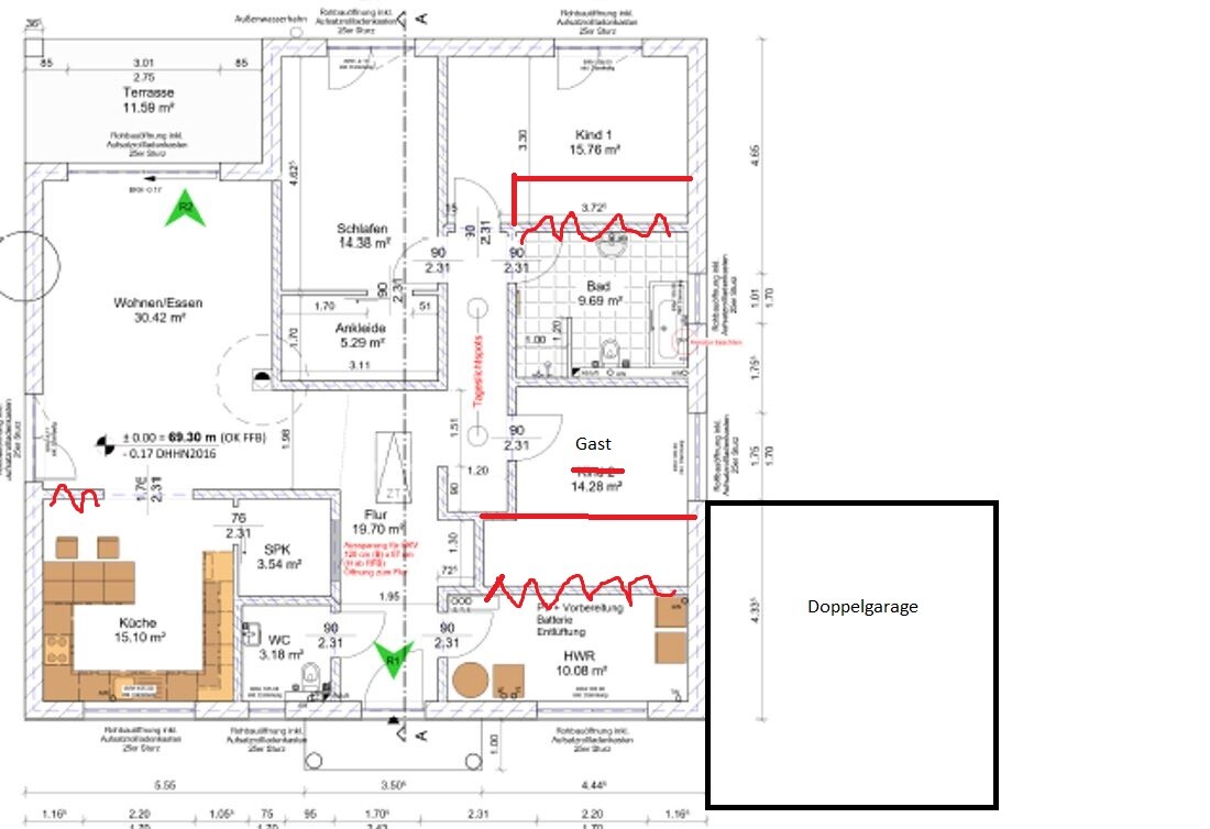

Thank you to the forum members for sharing the floor plans. We have attempted some amateur modifications based on our ideas.
Would you recommend a different building type?
The direct neighbor has built a 1.5-story house directly on the 3 m (10 feet) boundary line. We do not yet know what kind of house will be built on the southern part of the available plot.
All floor plans still need to be mirrored because we logically want the entrance directly on the street side. The garage should be placed directly at the boundary with the neighbor.
Slope: no
Site occupancy index: 0.4
Floor space index: 2
