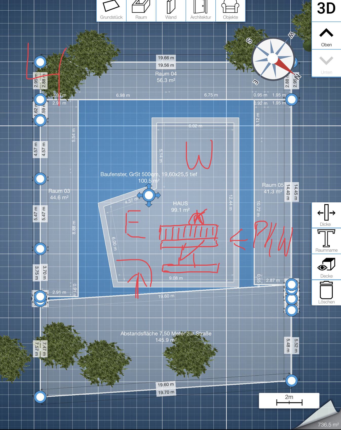

Draft 4 (angled): adapts to the sun, the opening of space from small at the entrance to large in the living room, the transitions, the flow of rooms kitchen-dining-living room, possibilities for terrace all around east/living room, great unconventional children’s room with terrace.

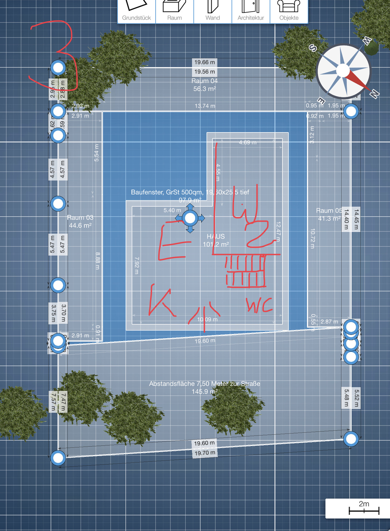

Draft 3: always works with L-shape kitchen-dining-living, lots of garden to the west, narrow side to the southeast neighbor.
Draft 2 (corner): partly covered outdoor area, the neat UF, the UF terrace.
Draft 1 (“barn”): the aesthetic exterior, clear structure.
What do you not like? Why?
D4: kitchen too subordinate? Large living area needs subdivision… upstairs attractive but difficult.
D3: no structure of garden/terrace not derived from or shaped by house/plot.
D2: inside GF too fragmented? Kitchen not separated enough from dining area? UF not easy to design because of angle.
D1 barn: small garden to the west.

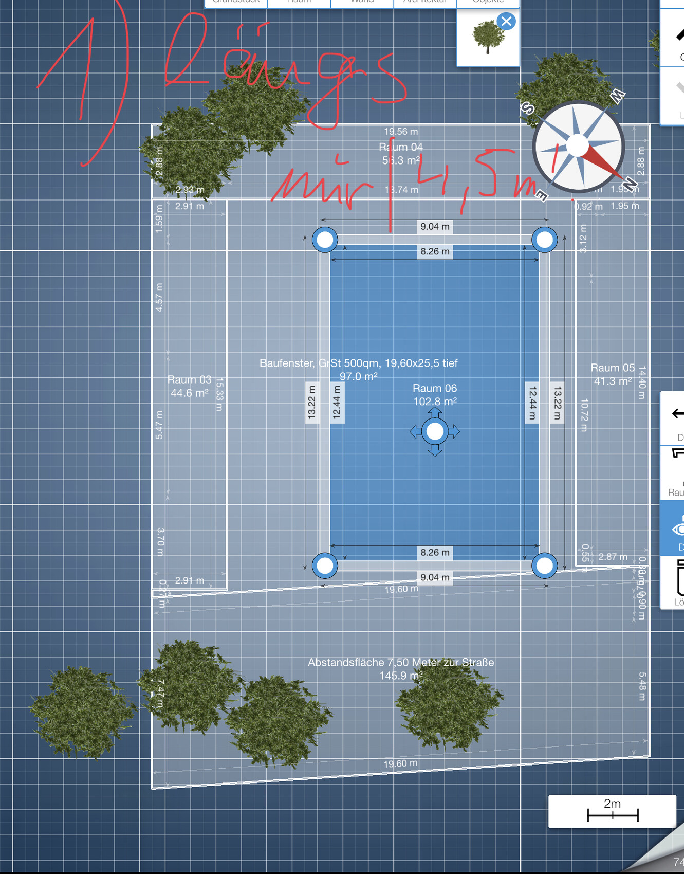

Without having read the text: long and narrow on the north side, light inside the house from southern sun, living room on the west, long staircase integrated with the building. Gable roof.
With the text:
You have the garden to the west through the garden in the south.
Everything is perfect. Modern barn style. If you like it, many options are possible 🙂
PS: Do yourself and us a favor and switch to sketching with paper and pencil.

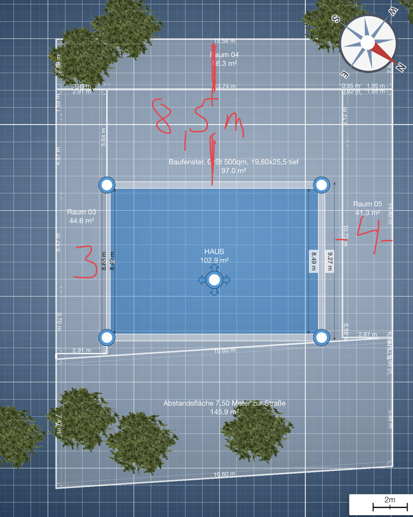

I'm not very confident about this, but the floor area ratio including access path, terrace, and parking space could be very tight.
The access path takes up quite a bit of space.
The front garden @Steffi33 has a large one. It looks impressive visually.
Layouts 4 and 3 have the kitchen far from the terrace.
Layout 2 doesn’t fit the plot at all.
I like layout 1.
I like layout 1.

Number 2 doesn't fit the plot at allThanks so much for the quick reply, so:
Idea 2 is out for me as well, it divides the plot into two unrelated parts.
I definitely like Idea 1 (barn) – the question is whether it will look "barn-like" enough: the nicest ones I’ve seen have length-to-width ratios of 2:1 or more. Here, the maximum length is limited to about 13 meters (43 feet), so at most 1.6 to 1. Is that enough to still look like a "barn," or will it look a bit "chunky"?
I haven’t completely ruled out Ideas 3 and 4 yet, especially 4 with the angled shape, which I find appealing because it’s not static.
Suggestion:
I’ll post the floor plan concepts for 1, 3, and 4 on the forum, either as paper/pencil sketches (understood @ypg – but currently very hard to get hold of :p) or at least in a readable digital format.
Yes, @haydee, the floor area ratio is pretty tight; it was originally 0.3 and then set to 0.25 by the first zoning plan. I think we first have to give up the paved driveway (already over 20 square meters (215 square feet) alone), then the carport… and the terrace, well 😎 .

Yes, @haydee, the floor area ratio is getting tight. It was originally set at 0.3 and was then lowered to 0.25 by the initial zoning plan. I think the first thing to give up is the paved driveway (already over 20sqm (215 sq ft) alone), then the carport... and the terrace, well 😎 . No, usually the second floor area ratio applies (the one not explicitly mentioned, except in text form in the zoning plan) for access paths and parking spaces. The terrace counts towards floor area ratio 1, so within the possible 125sqm (1345 sq ft).

the ones I have seen have length-to-width ratios of 2:1 or more. A barn-like character is more about the ratio of height, narrow width, and roof pitch. You won’t really perceive the "length" at the immediate boundaries of the plot. Focus first on possible room layouts before fixing length and width... I don’t see the 9 meters (about 30 feet) at all. In this case, even if you find the barn too short, it is, in my opinion, the most charming building form.
