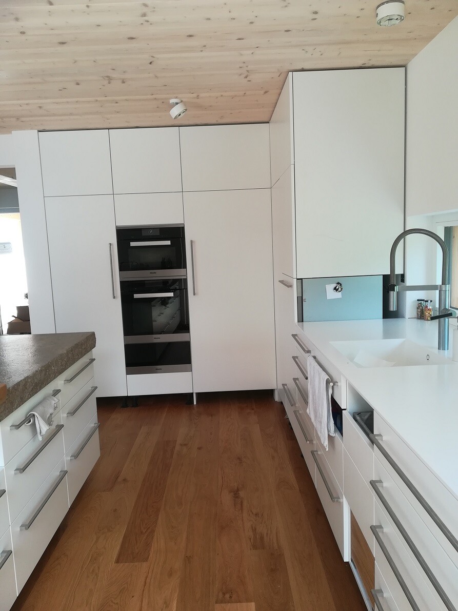

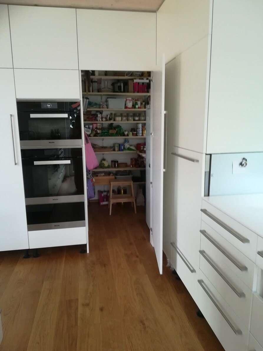

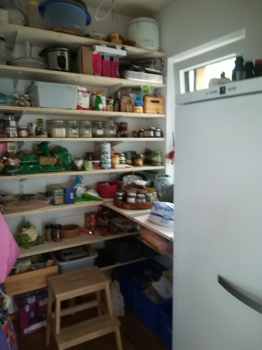

I would never, ever do without a pantry – even if it’s just a small one. I now have it with direct access from the kitchen, and it’s absolutely invaluable. It’s perfect for quickly putting things down, I have the freezer cabinet inside it, so I don’t need a freezer compartment in the regular fridge. I have a shelf there where my soda maker, toaster, and bread bin are always ready to use but out of sight.
I also keep bins for paper recycling and plastic there, as well as a box for glass recycling – just open the door, and everything is neatly stored away.
Visually, we’ve integrated it into the kitchen in a way that it doesn’t stand out:
Here’s a look into our pantry:
Next to the freezer cabinet is the shelf, with the recycling bins below (they’re bigger now) – the baseboards are still missing in this photo.
Here it is with the door closed – integrated into the kitchen front:
The kitchen should finally be finished next week, then I’ll share some more pictures.
But without a pantry? No way!
