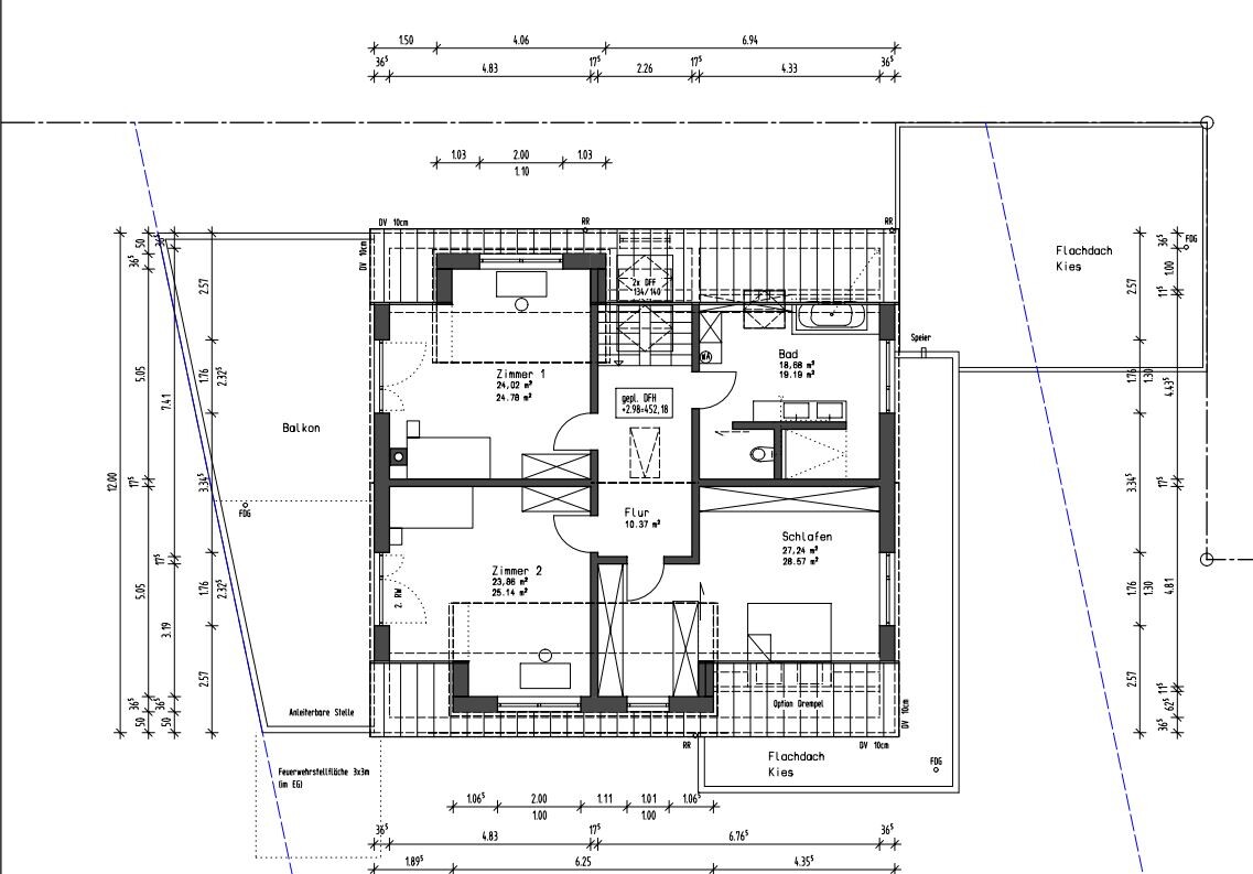

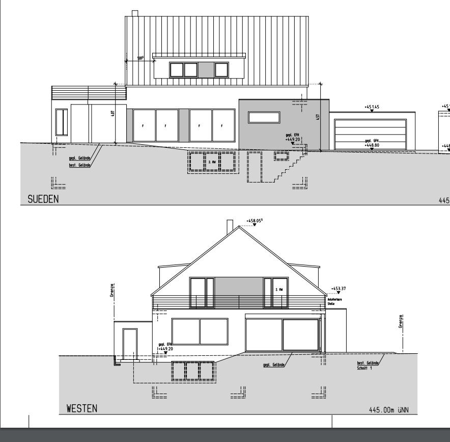

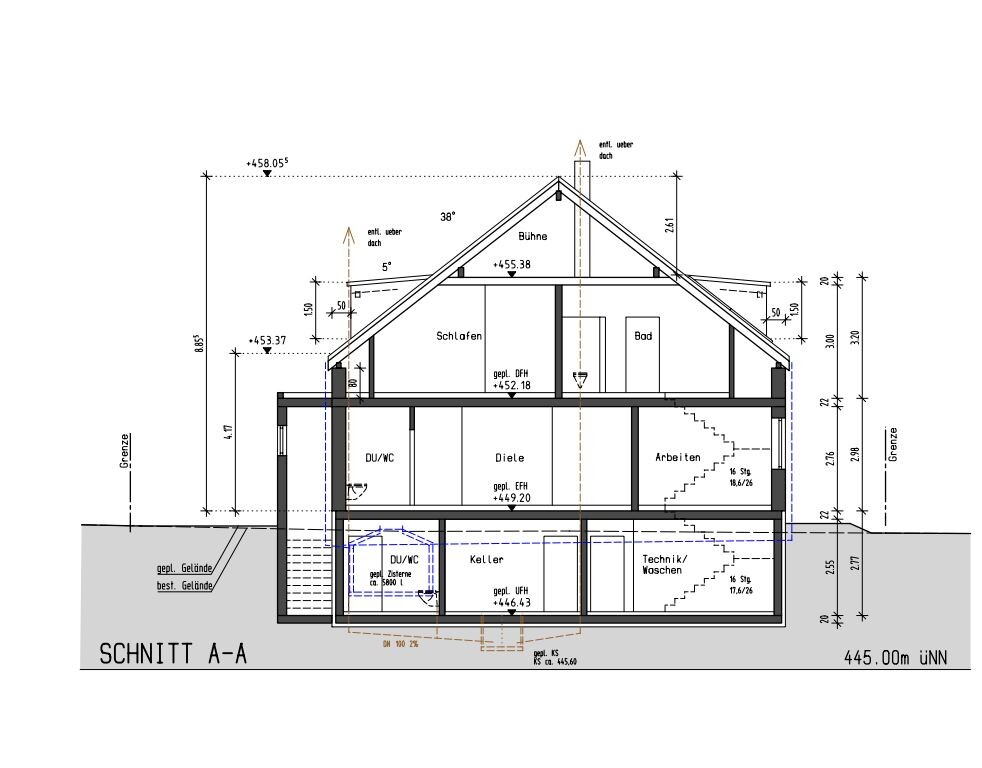

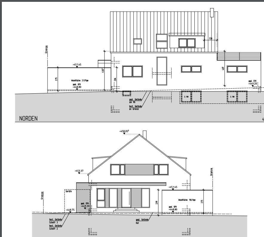

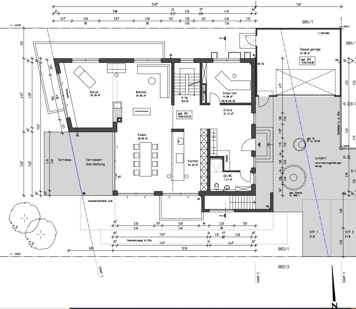

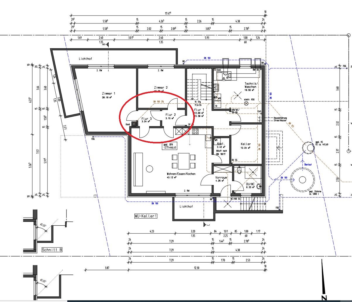

Dear forum members and experienced builders,
Here is our most recent design (just before submitting the building permit / planning permission application).
Main changes:
- We have now included a separate apartment (hence the stairwell structure on the southeast side).
- Various smaller floor plan adjustments
Anyone who would like to take another look is warmly invited.
Many thanks again for all your ideas and suggestions.
Best regards and wishing you all the best
Main changes:
