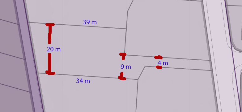

Ladies and gentlemen,
we have made some progress, and I have also tried to include some measurements / dimensions (please excuse the amateur quality) (see image).
We are now leaning towards building WITHOUT a secondary apartment, following the advice here in the forum – thank you again! Reasons are mentioned above (“privacy” / cost / parking space… etc.).
The question now (again) is:
1. WHERE and HOW should we position / plan the house within the building boundary?
Especially considering the future neighboring developments.
How can we achieve the best possible visual privacy and a feeling of security inside the house and especially in the garden?
2. What creative elements could help achieve the best possible privacy?
Walls? Fences? Pergola? Conservatory / sunroom? Other ideas?
Thank you all in advance!
Best regards and happy living / building / planning to everyone!
sanftmut schrieb:
and I have now also tried (sorry for the amateur quality) to add some measurements / dimensions (see image). Measurements are recognizable for both laypersons and professionals,
sanftmut schrieb:
1. WHERE exactly should we place / plan the house within the building plot. Where is the building plot boundary?
sanftmut schrieb:
2. What could be creative elements to achieve the best possible privacy?
Walls? Fences? Pergola? Conservatory? Other ideas? Let plants grow. Hedge, tree, shrubs...
