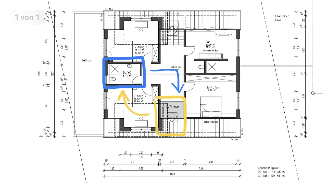

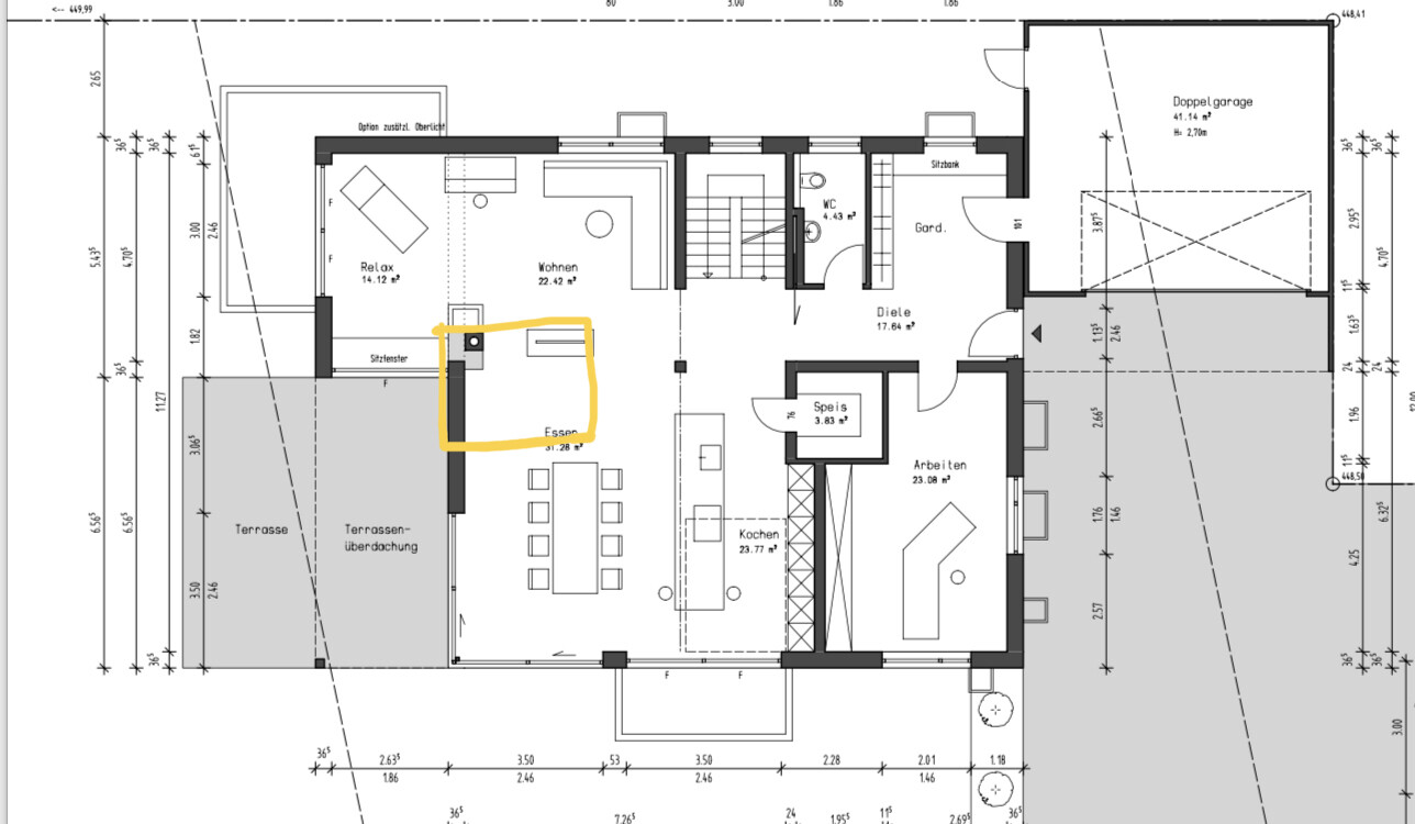

Since it was mentioned that the air space is not ideally positioned:
What do you think about swapping the kids' bathroom and the air space? See the “photo.”
The advantage would be having the west side open to the air space – the disadvantage: the kids’ bathroom would be close to the master bedroom.
Looking forward to your opinions on this…
Thanks and best regards
Apart from the fact that I generally said to relaunch instead of fiddling around ...
... I think: "You don’t know your own plan."
The open space would then be half over the bay window and the terrace. Joker, six, fail.
sanftmut schrieb:
What do you think:
Swap the children’s bathroom and the open space?
On the ground floor, the open space is better placed there, but you’re not reading correctly: the sound makes everything seem louder upstairs.
If my husband is watching TV downstairs and I’m upstairs, I can hear his TV from below, but not mine in the bedroom (under certain conditions). If there are two people, this works, but not with children.
sanftmut schrieb:
But: I thought the empty space was supposed to be here.
See the picture – maybe my “amateur” sketch wasn’t clear enough. Um, then I guess I have to almost completely retract my previous statement and say almost the opposite – yes, I misread the small illustration. However...
sanftmut schrieb:
maybe it was a bad idea after all... ... unfortunately still applies, see Yvonne’s explanation in #66.
I now think I have understood what is wrong with your design, i.e., where its oversizing comes from: it seems to me your guiding principle is not “how to plan the house to meet needs,” but rather “how to maximize plot usage.” Try turning off this “loudness” button.
