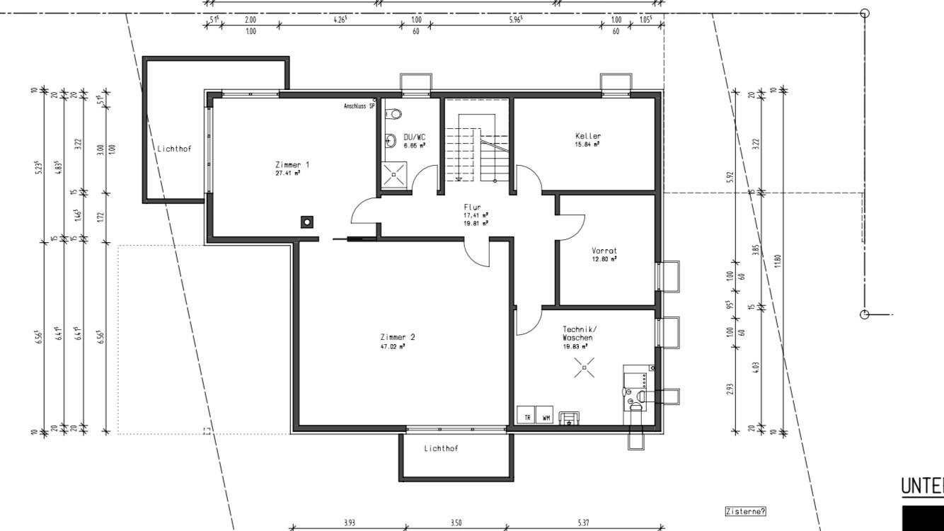

Hi everyone!
The revised design is now ready.
See attached pictures!

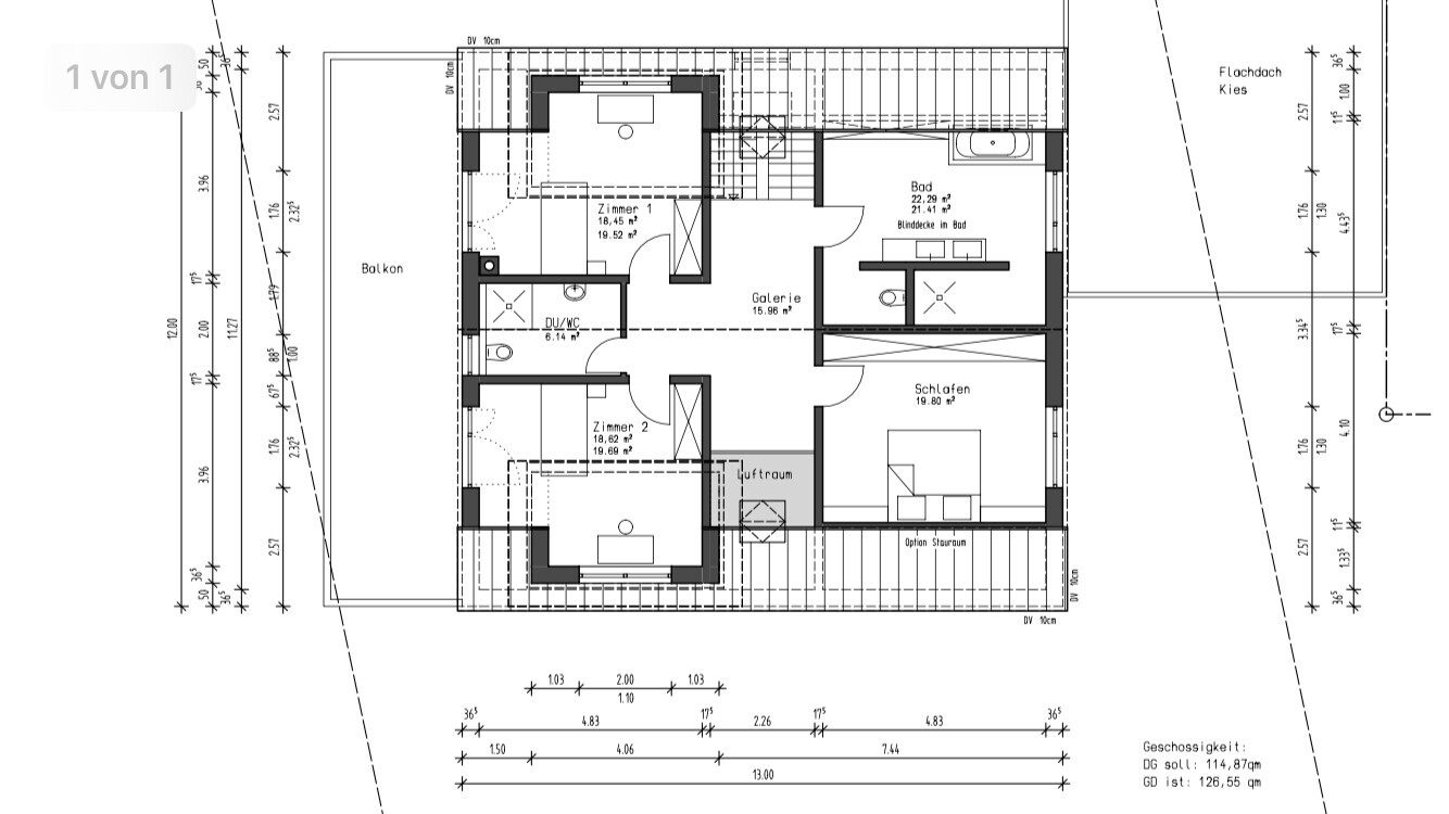

The house is now two meters (6.5 feet) wider (north-south).
Mainly because of the attic floor, which—due to it being a single story and the low knee wall height (0.8m (2.6 feet))—feels like the main planning bottleneck.
Attic floor: What are your thoughts and suggestions for changes?
Note: as far as I understand, we are very close to the two-thirds rule for a full story (building permit / planning permission) limits. So it can only get bigger if we also increase the ground floor.
The goal for the attic was to create a somewhat "open feeling"—
hence the void space as an attempt to bring in some "airiness."

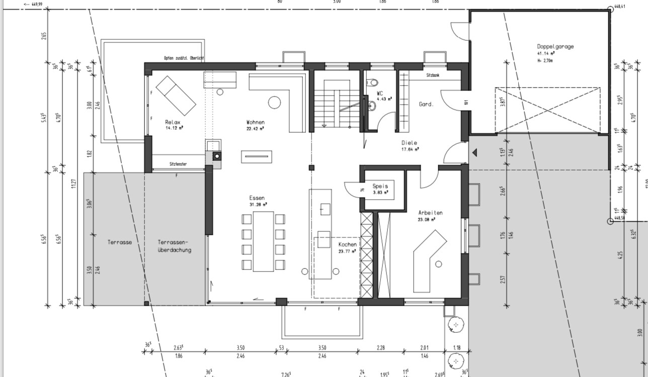

Ground floor: What do you think?
For example, about the windows and walls? Especially regarding the living and dining area.
Would it be better to open more towards the west? And maybe have a bit more wall on the south side (where the neighbor is quite close)?
Looking forward to your opinions, thoughts, and tips!
Feel free to ask if you have any questions!
Best regards and thanks!

Wow, not bad. Apart from the fact that it’s enormous.
Personally, I don’t like the huge light wells for the basement. They ruin the garden. I wouldn’t need the rooms down there anyway, so I wouldn’t include them. But of course, that’s different for everyone.
I think the bathroom isn’t quite perfect yet. You almost walk right into the sinks.
I would also include a laundry chute in the plan. But other than that, it looks good.
Could you tell me again how much it’s supposed to cost?
The north facade stands out with a cacophony of window sizes. The view through the large window behind the lounge chair won’t be entirely unobstructed: the reason isn’t the Bossa Nova music, but simply the fall protection at the edge of the light well. Otherwise, I think it can be left as it is. Nothing should be left lying around in the courtyard, as it is fully used as a “wipe zone” during maneuvering operations.
I haven’t looked into the exact requirements for converting basement rooms into living spaces, but from skimming through it, I don’t like it at all.
In my opinion, the dormers don’t add any value. Whether it’s 19 sqm (205 sq ft) or “only” 16 sqm (172 sq ft)... even with 14 sqm (150 sq ft) you could have nice bedrooms for kids, offices, or whatever. Instead, the single-family house is equipped with unnecessary gimmicks like dormers... plus it even has two light wells in the basement. Somehow, it seems like you’re panicking and worried that the living space might become too tight. Unfortunately, in my opinion, the house doesn’t benefit from this by becoming bigger or more spacious.
Let’s be honest: no one needs a 27+ sqm (290+ sq ft) bathroom on the upper floor. On the ground floor (I’m well known for being a true fan of having enough closet space for plenty of family members), this square, nicely shaped area tends to become more of a mess... maybe close it off but keep in mind the corridor width when doing so.
The pantry is well positioned (finally planned properly and not just tacked on in a row). I find the kitchen too large to be practical for cooking. Unfortunately, the living room is no longer a proper room, just an open corner. Looking at it more relaxed, to me the living area feels too overshadowed compared to the dining area.
