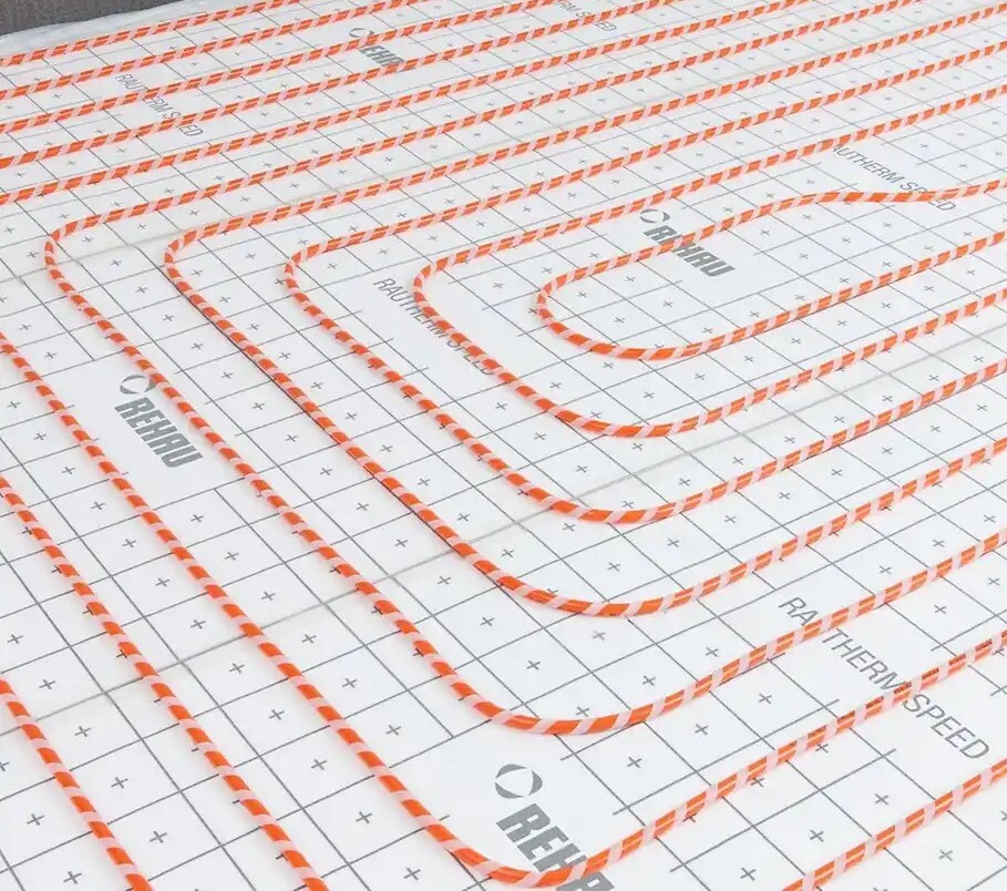

Has anyone here ever used or been offered the clamp-free installation method with hook-and-loop tape? It is said to allow faster installation and a thinner screed.
Edit: I mean this installation method:
Who is the manufacturer of the underfloor heating pipes? Which type of PEX is used, and how is the oxygen barrier implemented?
I personally worked for several years at a large plastics processor. I distinctly remember how carefully it was ensured that the EVOH layer was included. I set up the process data monitoring and developed systems for peroxide removal (to avoid prolonged heating times).
Do your pipes also have a PE protective layer to prevent damage to the barrier? Ours was bright red so that any absence would be immediately noticeable.
