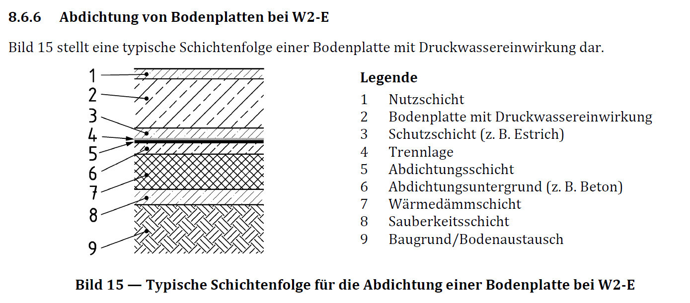

I have now taken a look at the waterproofing standard DIN 18533, and it specifies that for positive water pressure—like we have—the waterproofing is applied beneath the slab, not above it.
Cross-section of a slab with wear layer, waterproofing, insulation, and foundation
This suggests that the waterproofing is indeed not done on top.
I find that a bit uncomfortable because I have to fully trust the company and won’t be able to verify later whether everything was done properly. So now I’m wondering if I should still waterproof the top of the slab as well… kind of as an extra safety measure.

Are you building a basement? It is usually constructed as a waterproof concrete shell ("white tank"), so you typically do not need additional waterproofing under the slab.
Smarti99
20 Jan 2020 11:13
No, without a basement.
-XIII-
20 Jan 2020 11:20
We also used the black tank method, and our sequence from bottom to top was: 1. blinding layer, 2. bitumen waterproofing with torch-on membrane, 3. insulation, 4. concrete slab.
In my opinion, applying it above doesn’t make sense, as water would likely rise through the walls if it comes through the slab.
