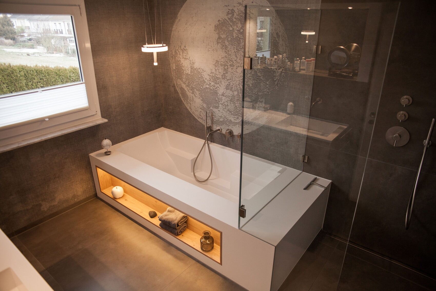

Is it very complicated to move the bathtub with the head end flush against the wall? Currently, there is a tile width of space at the head end. This would create more room for the shower. The glass shower wall could then be moved closer to the tub. The end of the base could remain as a shower bench. Something like in the example image, just imagine the step in the shower and the illuminated decorative niche removed.
Originally, we didn’t want a glass shower anymore because of the squeegeeing – maybe the two shower walls on the base could be dry-walled, with only the shower door made of glass (the shower’s depth probably isn’t enough to skip the door).
