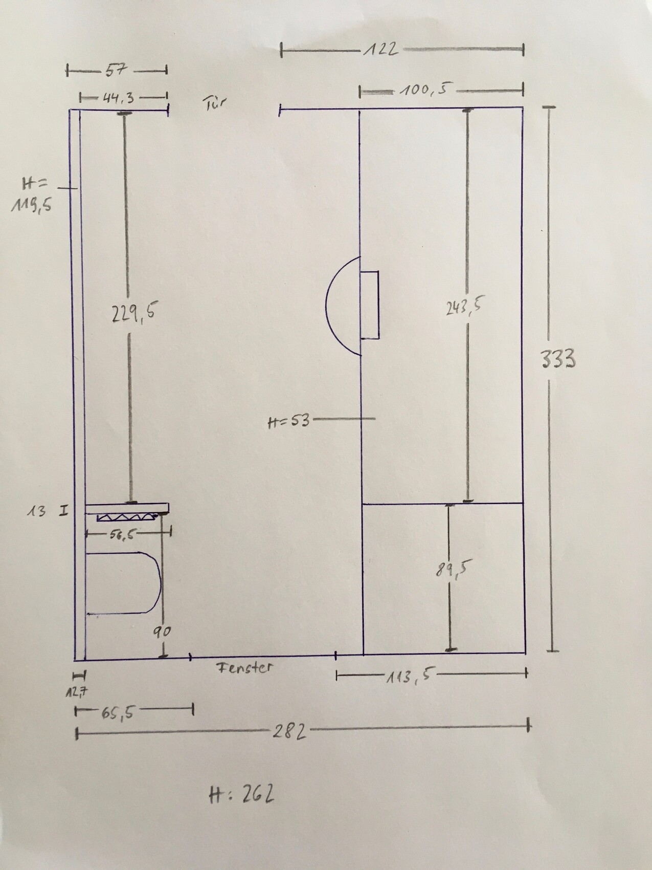

after a sleepless night, I’m seeking your help. We have a bathroom that is about 25 years old, which we inherited when buying the house. It’s now beyond repair, tiles are falling off, all the fixtures (Dornbracht!) are broken, etc.
We spoke with a highly recommended company in our region (Rhine-Main area) and they gave us a quote of over 50,000 euros. It’s a “maximum” offer, no extras, standard fixtures, house-brand tiles, etc. Maximum in the sense that everything that might possibly come up is included. No additional charges, according to them.
Part of the offer is, for example, to remove and replace the existing underfloor heating, and renew all the pipes in the bathroom. Reason: underfloor heating of this age is no longer reliable and should be replaced. We are wondering: is this really necessary?
The bathroom has a classic layout: bathtub and shower on one long side, double sink and toilet on the other long side. We only want to swap the positions of the bathtub and shower, with the shower to be built up and tiled. Everything else should remain as it is, just re-tiled with new sanitary fixtures and new taps. We also plan to lower the ceiling to install spotlights.
We had a budget of about 25,000 to 30,000 euros in mind, and assumed that might even allow for a strip of Bisazza glass mosaic. But the price calculated now, with relatively simple fittings that we do not like, is really depressing.
I understand that I can’t simply compare to prices from large online retailers, as contractors create mixed calculations including materials, installation, warranties, etc. Still, are we that far off with our budget? If not – how do I find a reasonable contractor without astronomical prices? One who really understands the job, who doesn’t insist on tile edge trims, who can properly do glass mosaic, and who is willing to listen rather than just follow their standard scheme?
We are definitely willing to invest to get a great bathroom. But 50,000 euros for a bathroom that still falls far short of our dream bathroom – that just won’t work.
Does anyone have any tips for us?

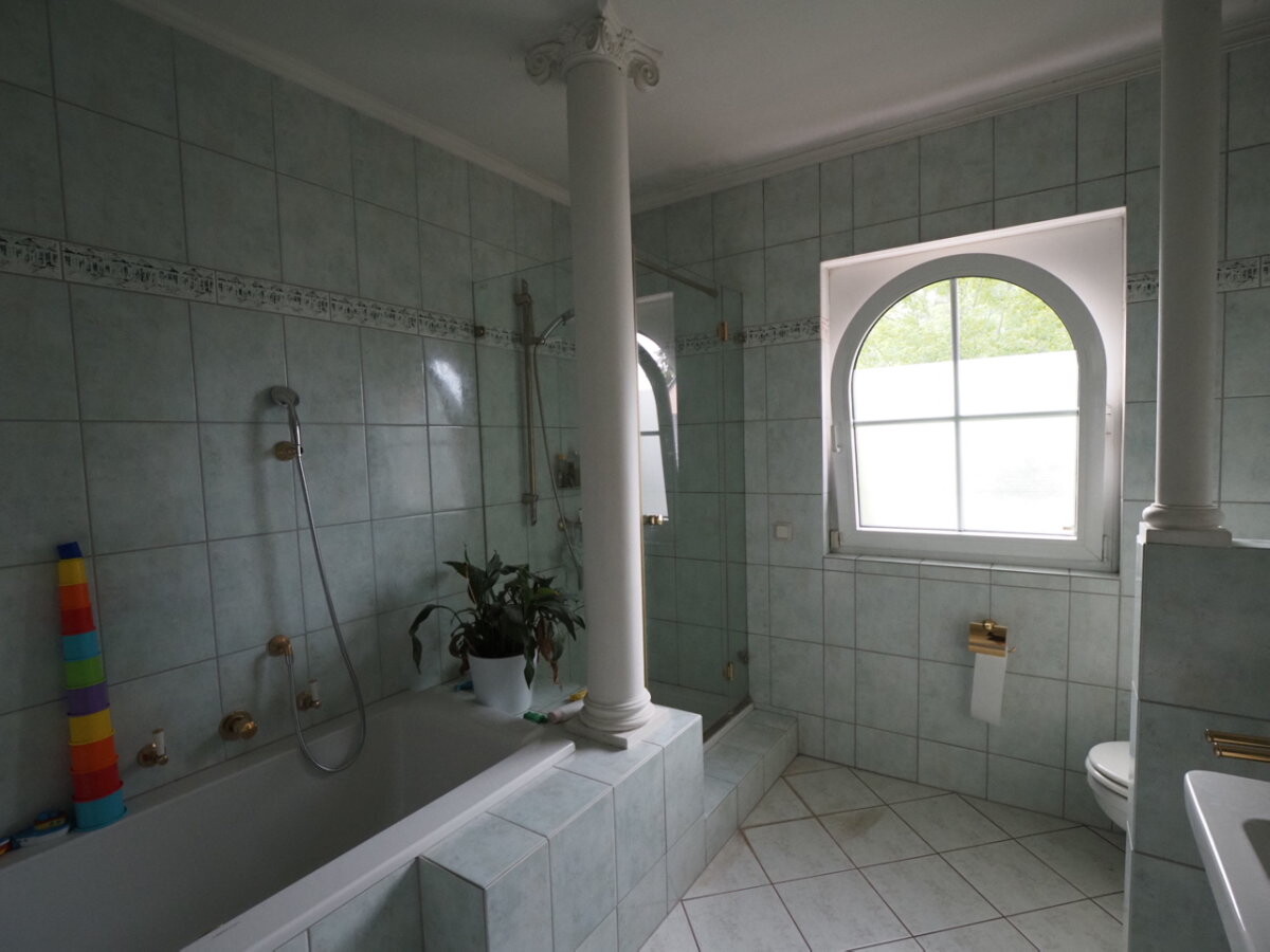

The house was built in 1998 and was originally constructed and fitted with high-quality materials, not by us. On one of the long sides there is a platform, into which the bathtub is set, and the platform continues lower into the shower area (you step up one step into the shower).
Should I post pictures? (You’ll be horrified… an absolute nightmare in turquoise, with columns and golden faucets).

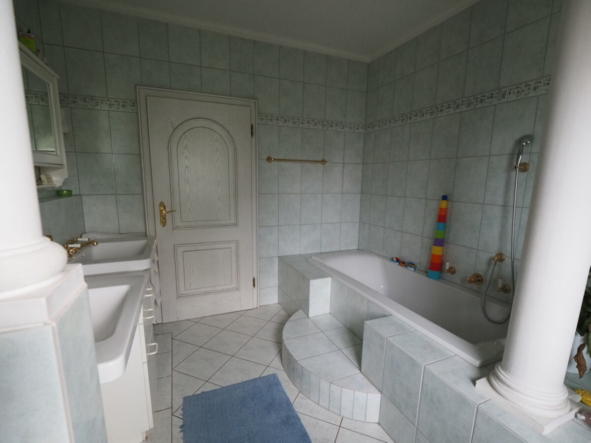

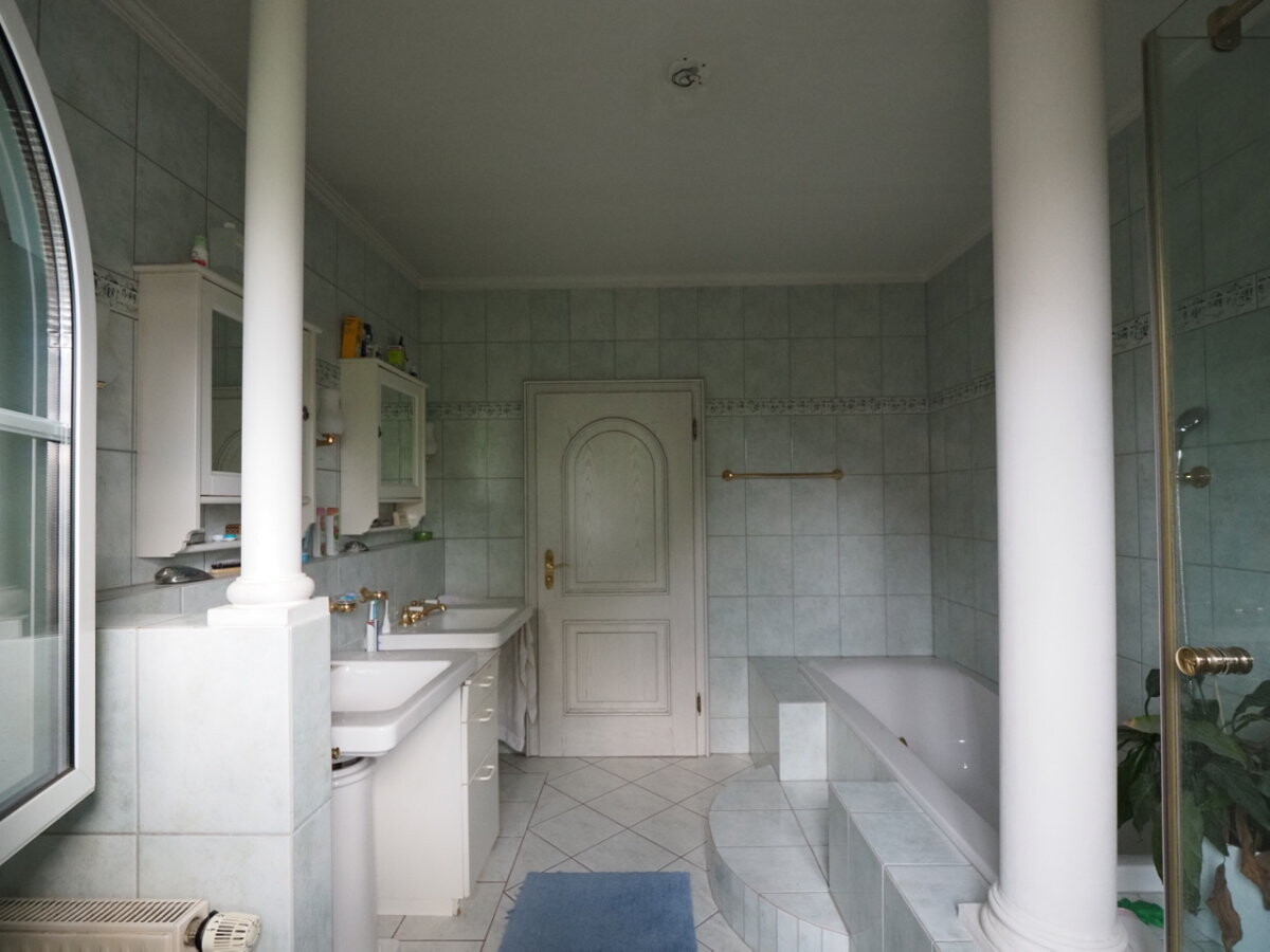

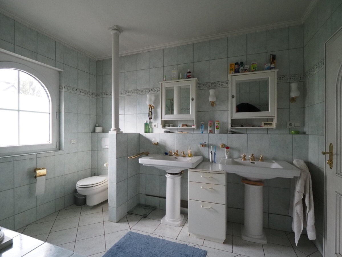

hanghaus20232 Dec 2022 22:10Helisara schrieb:
Should I upload some pictures? I already asked for that in post #4.Here. Painfully unfiltered. Admire the creative tile pattern, the step up to the bathtub, the delicate turquoise marbling, the “antique columns,” the already loose tiles, the supported sink... I think the desire to renovate here is understandable...
The door leads into a bedroom. This is not a family bathroom, only the master bathroom, so two users; the children only use the tub.
