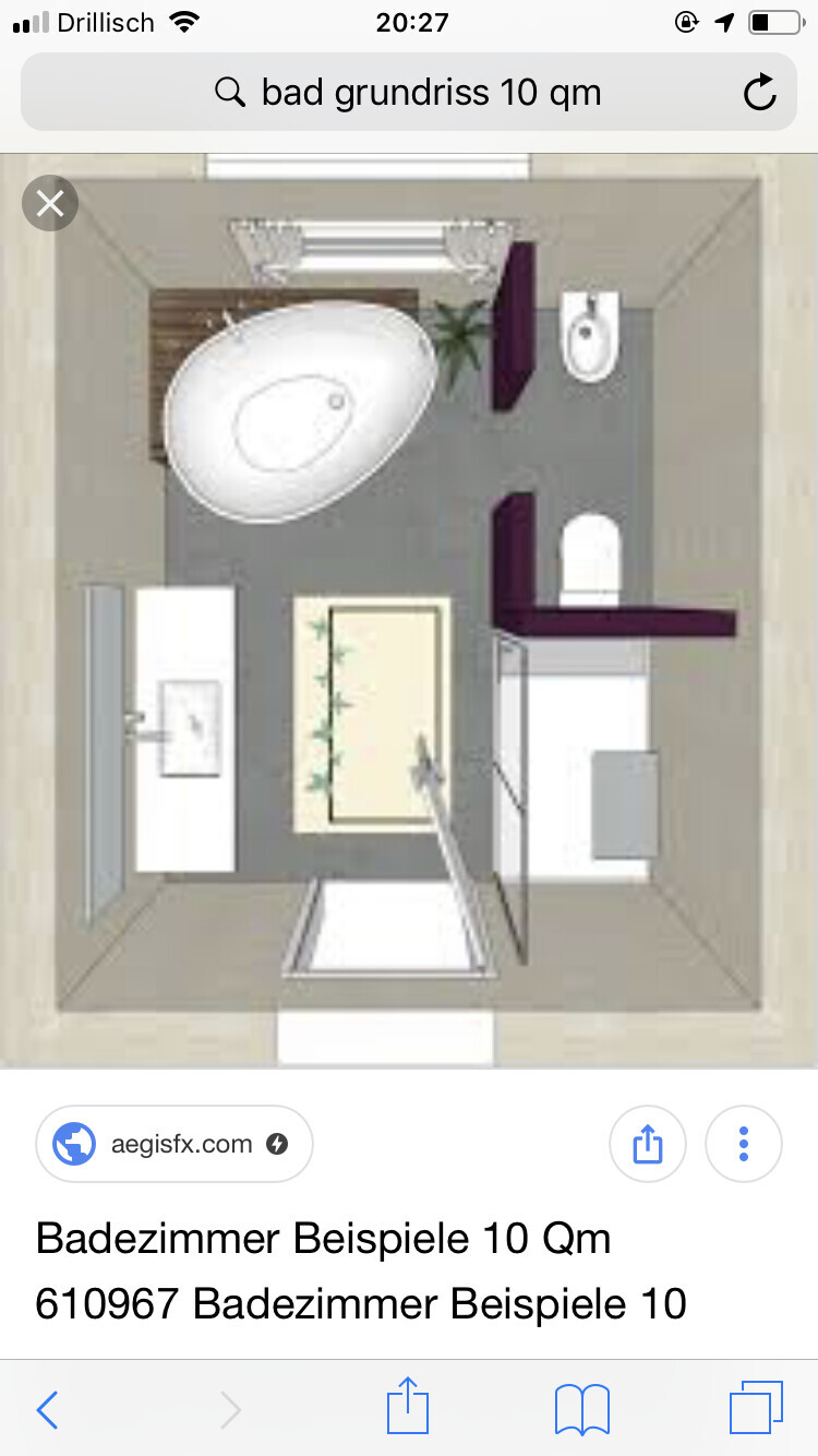

goalkeeper5 Feb 2019 22:50Katdreas schrieb:
I like that idea. How large is your bathroom? Do you have any concerns about the window above the bathtub in terms of opening and cleaning?We’re not that far yet. We’re still in the floor plan stage ourselves. The bathroom will probably be around 9–10 sqm (97–108 sq ft) – but it’s definitely an alternative to the T-shape.
goalkeeper schrieb:
This layout is currently our favorite. Looks pretty good at first glance
Best and most elegant layout ever!
Even if everyone now calls Ts, L-shapes, and rectangles circles.
This is called simple elegance 🙂
If you find it old-fashioned, you can either brighten it up with different tile coverings that match each other or with different tile layouts.
You should take a look at this in the showrooms.I see it exactly the same way. It basically fulfills all your wishes and leaves space where it should be. Natural light enters the toilet and shower area, which is not easy to achieve with a built-in shower and a concealed toilet.
The shower seems a bit small for a walk-in as well. Maybe rotate it 90 degrees?
goalkeeper schrieb:
This layout is currently our favorite.Personally, I don’t like it that much because the toilet is right next to the door, and to reach the only window, you have to stretch or step into the bathtub (well, it depends on your height and the sill height).
face26 schrieb:
Personally, I don’t like it because the toilet is right next to the door, and to reach the only window, you have to stretch or step into the bathtub (well, that depends on your height and the window sill height).And in the end, there is a wall in the middle of the room that takes up space. It will always feel like a maze... even though this is just a bathroom 😉
