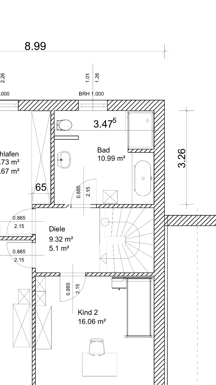

I keep struggling with the bathroom layout.
Our actual bathroom planning won’t take place until well after Easter *grrr*, and we just can’t come up with anything ourselves. We’ve also tried several online planners without any success ☹️
We don’t like the current layout that’s drawn in. Having all the fixtures lined up along the right and left walls looks outdated and not very cozy to us.
Please give us advice on how to make this nicer.
The bathroom should include a walk-in shower with a solid side wall (no glass) and no door, a bathtub, a somewhat “hidden” toilet, and a large washbasin.

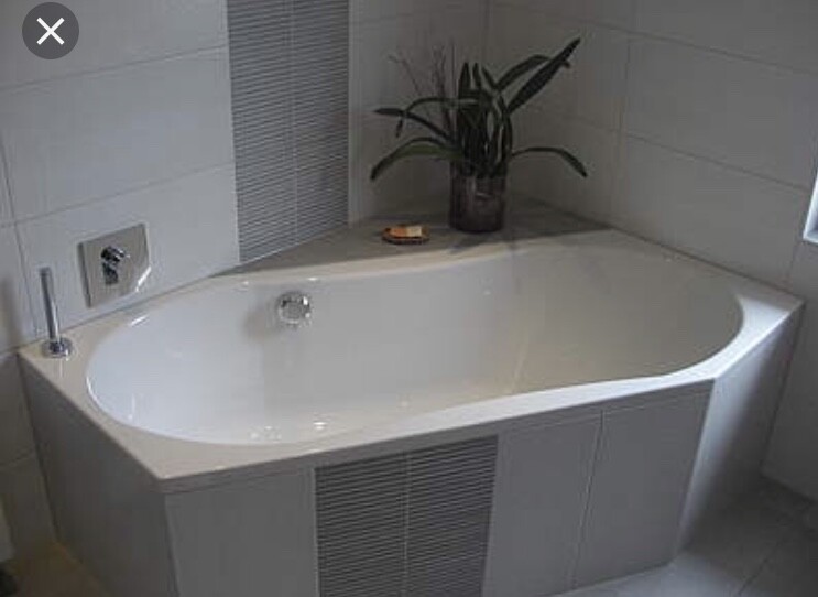

I really like the look of partially built-in freestanding bathtubs.
The room feels too small for a T-shaped layout, and we’re not really excited about that option either.
I’m grateful for any suggestions that can help me move forward!

The bathtub looks like an oversized sink... Without any dimensions, it’s hard to say anything because you don’t know what could actually fit where.You’re not wrong. I still think a half-embedded freestanding tub looks stylish. A regular angled one also looks nice to me.

Obstlerbaum8 Feb 2019 14:40Freestanding bathtubs mainly create extra plastering work and unnecessarily take up floor space. I would always try to avoid deliberately building everything too small, especially when you already have a 10m² (108ft²) bathroom...
