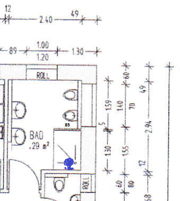

I am currently facing a similar issue:
In our new house, there will be a shower niche about 100cm (39 inches) deep and 130cm (51 inches) wide. The shower is on the right when you face it.
At the moment, there is a curtain in front, but we want to have a glass panel. When looking at niche doors with pivot hinges, the doors are usually between 58-68cm (23-27 inches) wide if there is a fixed glass panel next to them. A door 130cm (51 inches) wide is unfortunately not possible because the distance to the opposite wall is too small.
My wife has also mentioned that this might be too narrow for her.
Would a walk-in solution, like in the picture above, possibly work? Or is the width also too small for that?

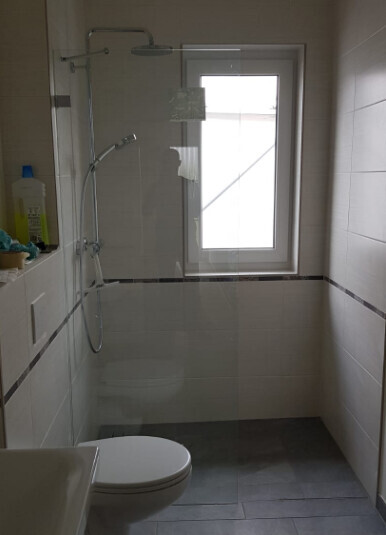

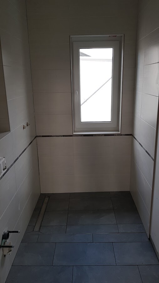

pagoni202029 Apr 2021 18:02@bra-tak Do you have a picture or drawing for a precise understanding?
We had two different showers installed here some time ago, and the smaller one is, for example, 120cm (47 inches) deep and 100cm (39 inches) wide, all without glass or curtain. On the wall side, we have a fixed glass panel about 25cm (10 inches) wide that protects the door.
Of course, this also depends—as always—on personal (shower) habits.

@bra-tak Do you have a picture or a drawing for better understanding?
We had two different showers installed here, and the smaller one, for example, is 120cm (47 inches) deep and 100cm (39 inches) wide—both without glass or a curtain. On the wall side, there is a fixed glass panel about 25cm (10 inches) wide that protects the door.
Of course, it also depends on personal (shower) habits as always. The blue mark indicates the position of the shower fitting.
I just quickly used Paint for this.
