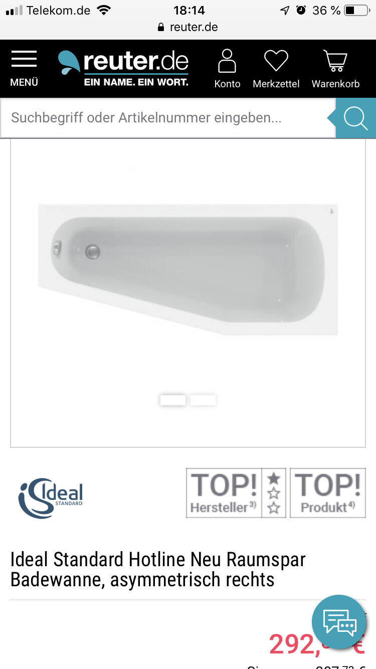

We have already decided against the double sink. We are now considering a 120cm (47 inch) wide washbasin with two faucets...
I also noticed the issue with the bathtub. I was thinking of a space-saving tub about 1.70m (5 ft 7 in) long and 70–80cm (28–31 inch) deep to create a bit more space in the middle.

These space-saving bathtubs are usually a last resort. I would not recommend relying on them in new construction.
