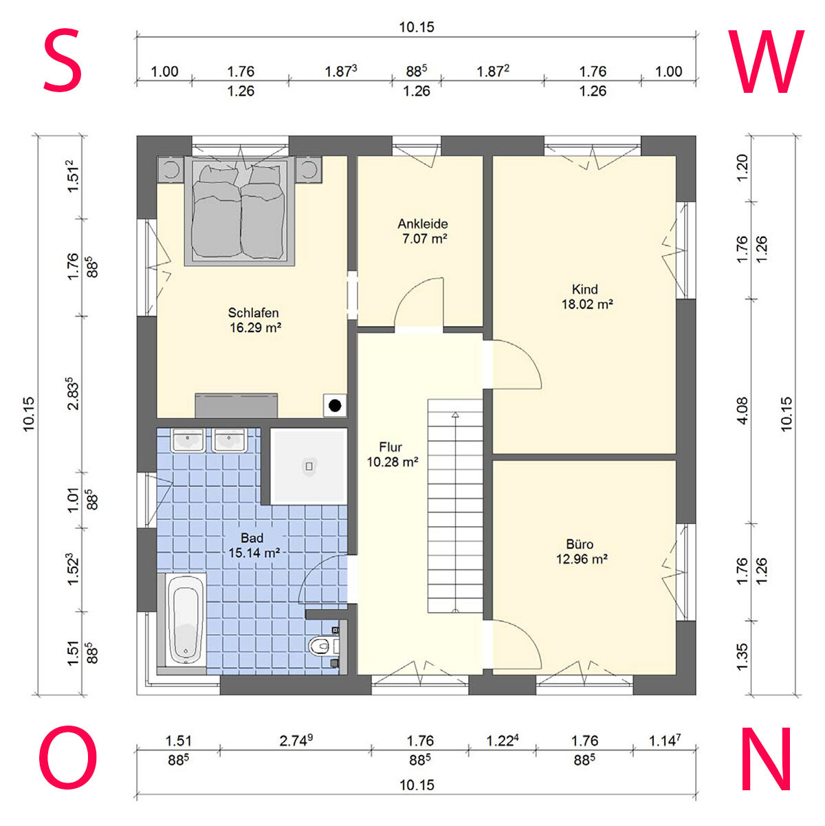

after receiving great help with the floor plan of our house here in the forum and getting some useful tips, we thought we’d also share the bathroom layout for discussion.
Except for the corner window, almost nothing is fixed yet. Practically everything can still be changed and rearranged, even the door. Our main requirements are:
- Walk-in tiled shower at floor level with a minimum width of 1.20m (4 feet) (is 1.40m (4 feet 7 inches) in the plan too wide?)
- Double sink
- The toilet should not be visible immediately when the door is opened (we have placed a small wall here for privacy)
- The bathtub should have a surrounding ledge for storage space
- We have dismissed the idea of a T-junction, although it was a favorite at the beginning ;-)
We’re looking forward to your opinions and suggestions :-)
- Double sink

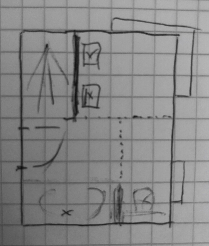

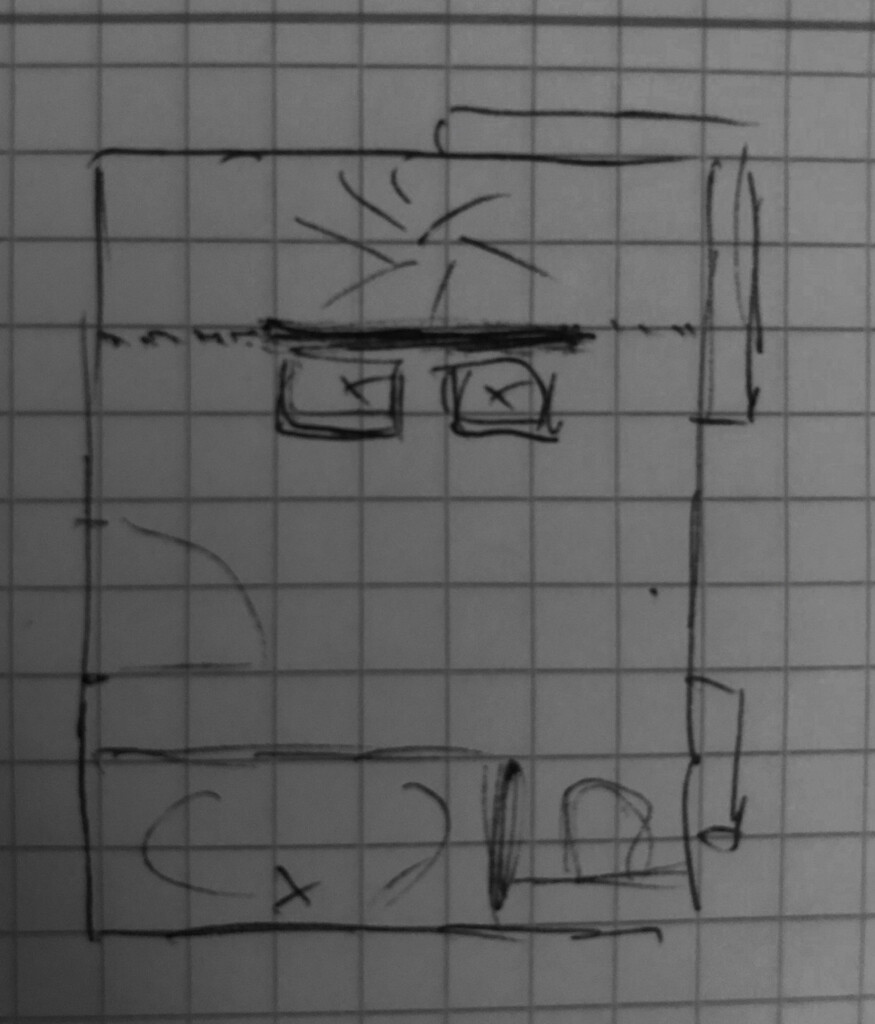

Or like this
Good zoning.
When sitting on the toilet, you can look out the window. A continuous line with the bathtub.
Walk-in walk-out shower: it has the advantage of openness as well as natural daylight.
I had other initial ideas, but none of them were appealing.
The wall between the toilet and bathtub is only about 140 cm (55 inches) high; for the shower wall in the walk-in walk-out shower, I would only make it about 2.20 m (7 ft 3 in) high or so.
Thank you for your ideas; these are quite different approaches. Somehow, we always ended up with almost the same results, even after experimenting. We’ve probably been looking at it for too long :-)
The WIWO shower would now be even closer to the window, which means you’re even more visible through the window than before. Of course, you can also cover the window while showering.
We have also considered a shower facing the door. I was only concerned that water might run towards the door. But with, for example, 1.60 meters (5 feet 3 inches) of depth, that shouldn’t be an issue, right?
