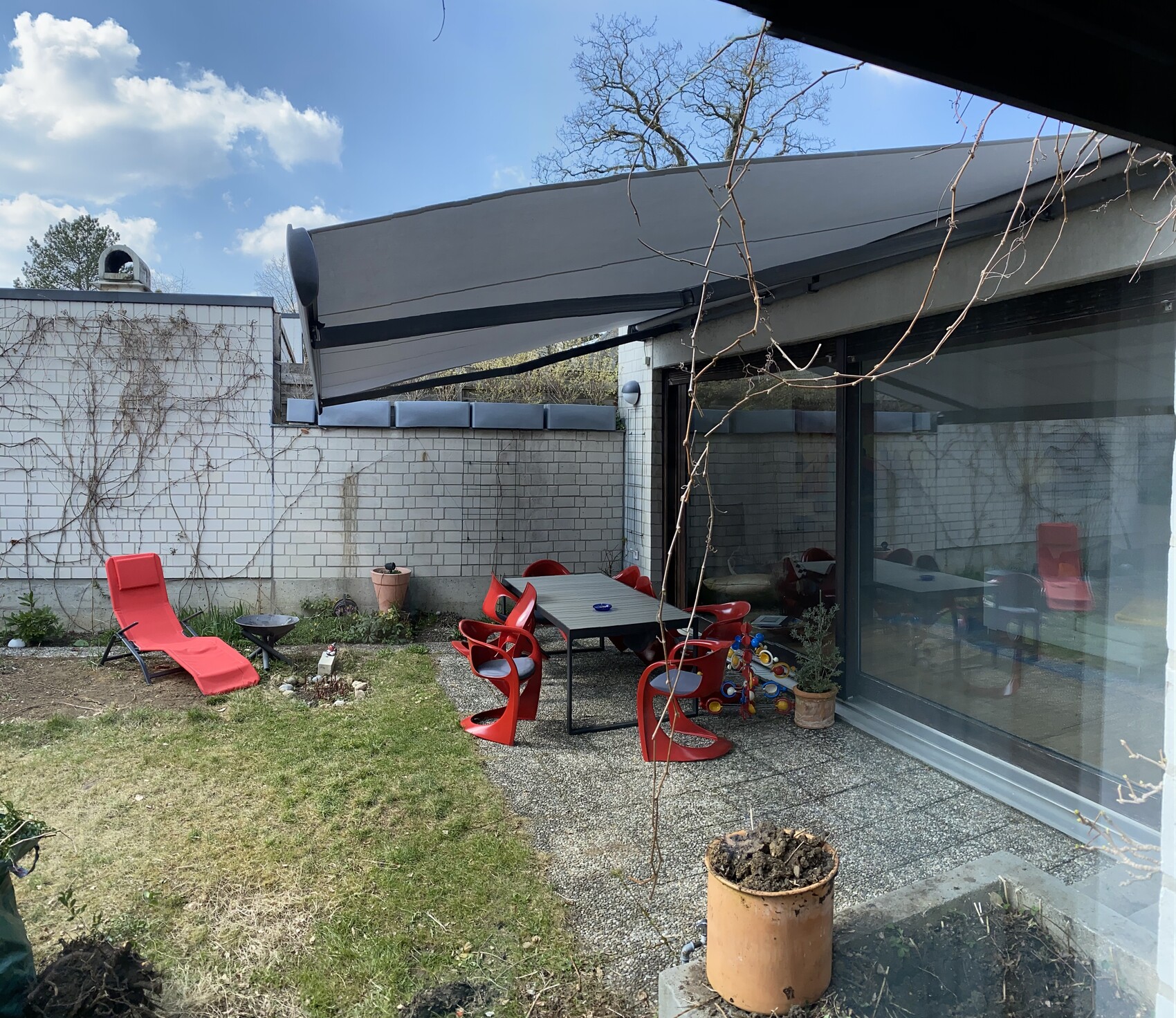

I’d appreciate a photo. Here’s my attempt at some photos. Unfortunately, I could only capture the awning like this, but we’re quite happy with it. We didn’t get wind or sun sensors (those will be added later with the new windows including external venetian blinds). It just rolls up and down electrically… and that’s it. We mounted the remote control on the wall so it doesn’t get lost.
I hope this helps you with your decision! Best regards.
Alternatively, cream or beige fabric was an option, but I felt the risk of it looking dirty quickly was too high.
