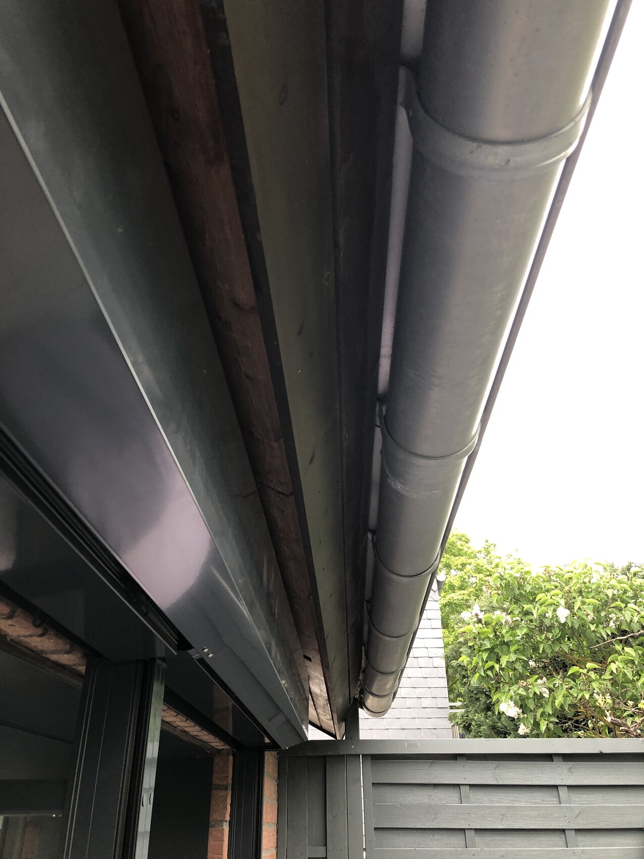

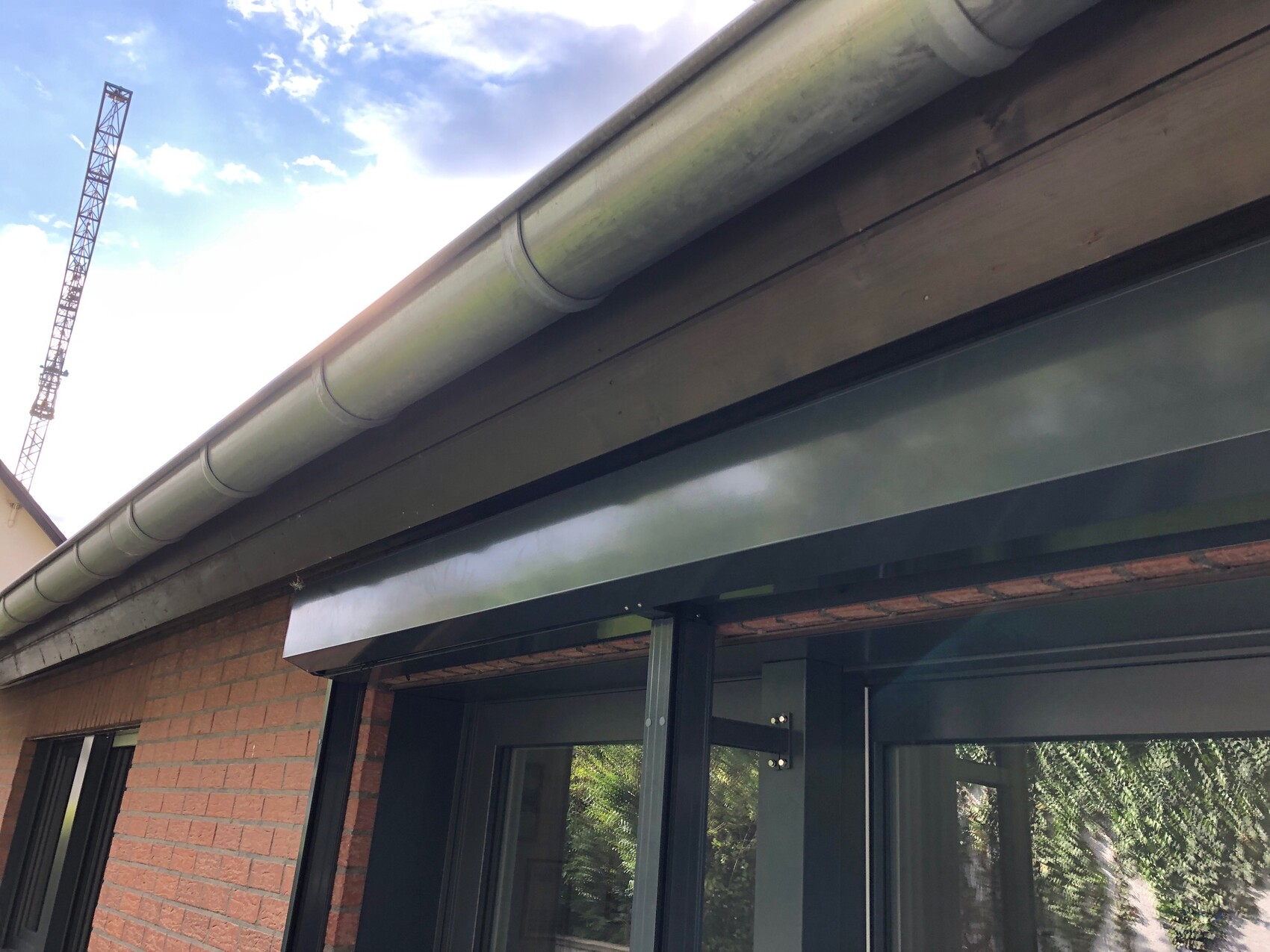

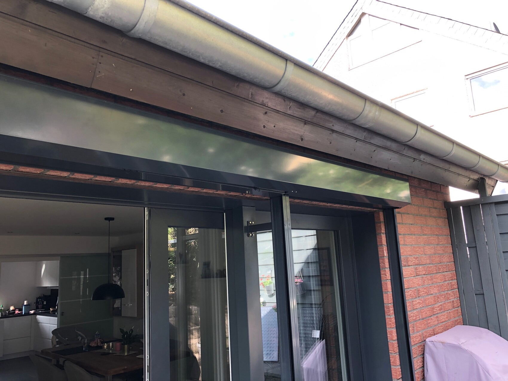

we would like to get a new awning. The problem is that the new venetian blind system takes up a bit of space. Previously, the awning was attached to the roof rafters, but now that might be tight.
We already had a company come by. They would prefer to pour concrete columns on the left and right sides of the venetian blinds, create a cross connection (square profile or something similar) and hang the awning there. The awning is supposed to be about 4.5–5.0 meters (15–16.5 feet) wide and have a projection of 3.5 meters (11.5 feet).
I don’t find this solution ideal and wonder if it might still be possible to fix the awning to the roof rafters. Normally, these mounts hang straight down. Would it perhaps be possible to have custom rafter brackets welded for this? The front cladding is only wood and could be partially removed. Where, for example, three nails are aligned vertically marks the end of the rafter.
I think the company will come back to take another look; so far, they haven’t properly checked the structure with the cladding yet. Does anyone have experience with something like this? I would like to know if my idea is completely unrealistic or if it might actually work with modified rafter brackets. Thanks.

Mycraft16 Jun 2021 10:03
It would also work with brackets that are screwed onto the rafters and move the mounting point in front of the external venetian blind.
