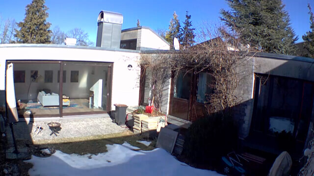

Summer is just around the corner, and we’re facing the issue of sunlight exposure.
We have a large window wall (southwest-facing) measuring nearly 8m by 2.5m (26 ft by 8 ft), and now we want to install some kind of sunshade.
An awning is currently our choice: what should we consider here? Which color is most suitable? I wanted a solid red, but apparently that color has the most problems with fading outdoors. Anthracite? Would that be too dark, and does it fade a lot?
What about dirt and stains — does it get warmer under a gray awning compared to, for example, a yellow one? Should we go for a full cassette or a half cassette awning? The half cassette seems to have the advantage that I can retract it just enough to stop at bird droppings and then wipe them off easily.
We have already arranged the electrical setup. The requirement is that it must protect the terrace and living room from the sun. We would also like to be able to sit under the awning during light rain. Does a rain and storm sensor make sense? Would you recommend having a light installed in the awning?
The windows will be replaced — the frames will be anthracite and fitted with external venetian blinds (is that the correct term for those slatted blinds?). But this will take a while and is quite expensive.
Thanks in advance for your suggestions. I don’t want to have the friendly salespeople come to the house unprepared.
Claudia

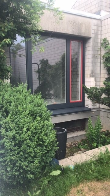

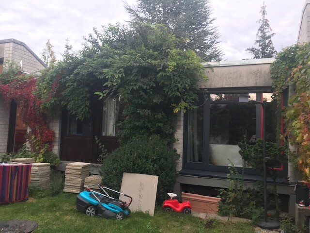

I took some inspiration from the original style of the settlement’s houses.
They all had different colored front doors; ours was originally a chimney red.
Now it will be bright red, matching the bench and the trash bin/mailbox.
The kitchen window and the garden window (where we removed the balcony) both have red frames.
I would like to find something that suits this; I have also considered some kind of pergola that could grow over time… but since our garden is not very large, that might take up too much space?!
