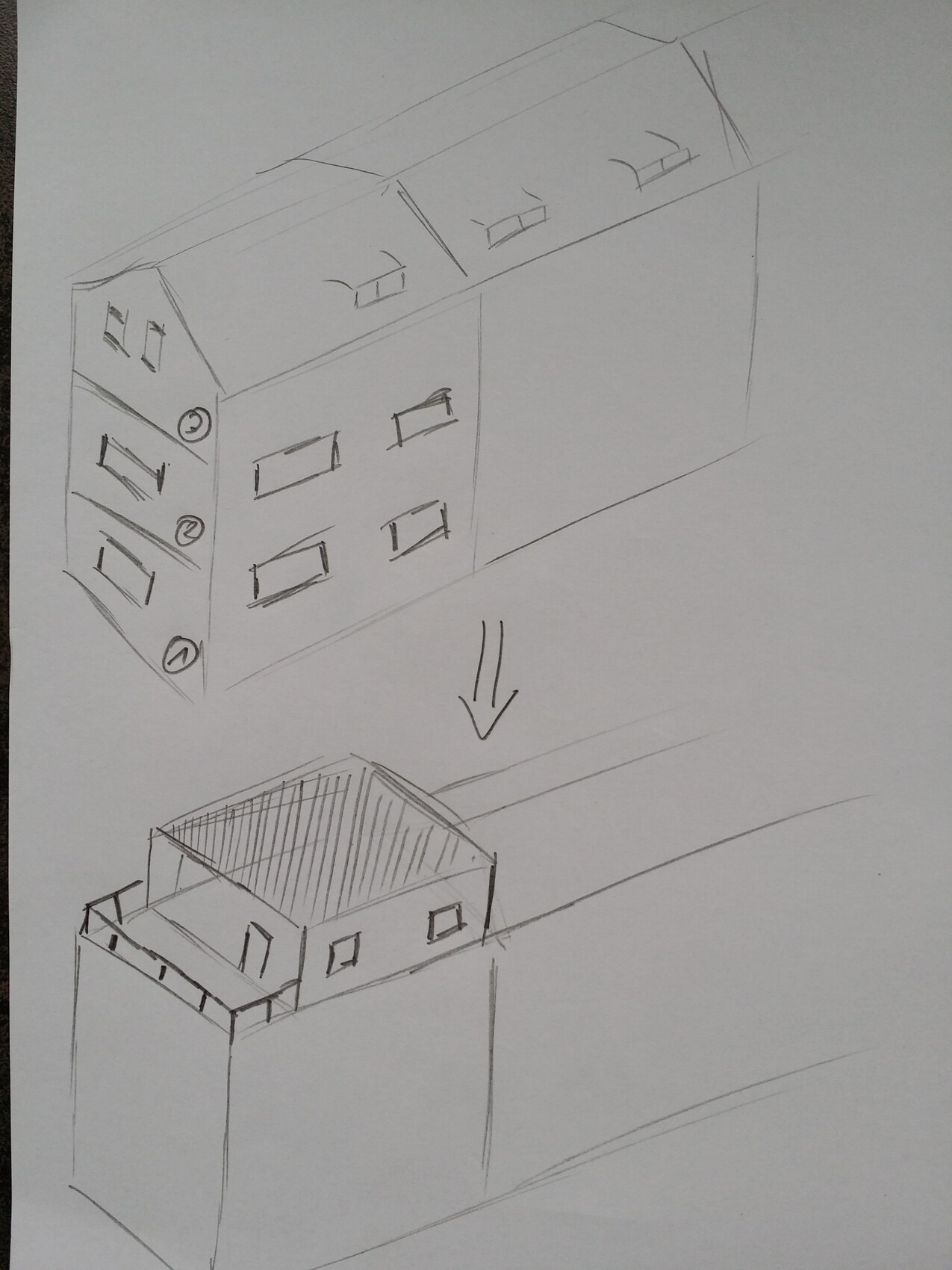

Attached is an approximate description of how this has been solved in the nearby area. Our current attic has no stair access; this would have to be through the attic apartment.

With its probable height of only 1 to 1.5 meters (3 to 5 feet), the attic is hardly usable without additional construction like shown in the drawing.
If you can obtain the necessary building permits (planning permission), no matter which direction you choose, the question is whether it even makes sense.
You can expect that a conversion like the one in the drawing will cost at least €50,000 [U](approximately $54,000) , more likely €70,000 to €90,000.
If this type of conversion has already been done in the neighborhood, you will probably be able to get the required permits.
I don’t fully understand the drawing. Is that an additional structure on top of the attic apartment, meaning another floor added, or is that the renovated attic apartment itself?

garfunkel18 Jul 2016 19:17My attic apartment was about 78m² (840 sq ft) and now, thanks to the dormers, nearly 95m² (1,022 sq ft).
But of course, that doesn’t help if the layout doesn’t allow for an additional room.
If the roof needs to be replaced in 10 years, it definitely makes sense to renew the insulation at the same time. Doing both separately is more or less pointless. Although internal insulation probably wouldn’t be affected whether the roof is new or being replaced.
That said, I’m not sure how you could cover the total cost with an affordable KfW loan. You’d have to look into that.
If you can add an extra floor and if this has already been done in the neighborhood, that offers great potential for a nice attic apartment.
You could set up the bedrooms in the “lower level” of the attic apartment and create a spacious living and dining area in the newly added upper floor with a nice roof terrace (which I would orient to the south/west, by the way).
Now to your questions:
You will hardly be able to make the attic space above the apartment usable. A friend of mine converted the attic space over two children’s rooms so that the kids can sleep up there accessed by a staircase or ladder. They love it, of course, as it’s like a hideout and very cozy.
But unfortunately, that doesn’t help you if you’re missing a room.
Expanding the space can also work without adding an extra floor. It depends on the current layout and how you have to work with the existing conditions.
A bathroom/toilet and a kitchen will probably have to stay where they currently are—because of the drainage pipes, stacks, and water lines.
Now you need to consider: Adding an extra floor obviously offers the greatest and best potential for space, no question. That would most likely solve all space problems—but it’s probably also the most expensive option.
Other alternatives are dormers. The gained space here should not be underestimated either. However, dormers don’t necessarily create an additional room. For that, the apartment’s floor plan is interesting as well as the size of dormers allowed for your property. For example, if you could place a dormer along the entire length of the roof, the new space gained along the length might allow you to reduce the width of other rooms and thus gain an extra room in the end. Then the sleeping area directly under the roof, like my friend did, could be an option.
But you have to like such a complex, segmented layout and keep in mind that children do not stay children forever and will grow up, especially taller. So, whether the space will still be sufficient then…
Dormers are cheaper than adding a floor, but the investment might not be worthwhile.
Of course, it makes sense. Just visit local construction companies, carpenters, or architects and share your plans. They can help you explore the different possibilities.
Building regulations—I assume you mean permits—always depend on the municipality (as far as I know). If it has already been done in your neighborhood, it will likely be possible for you as well.
