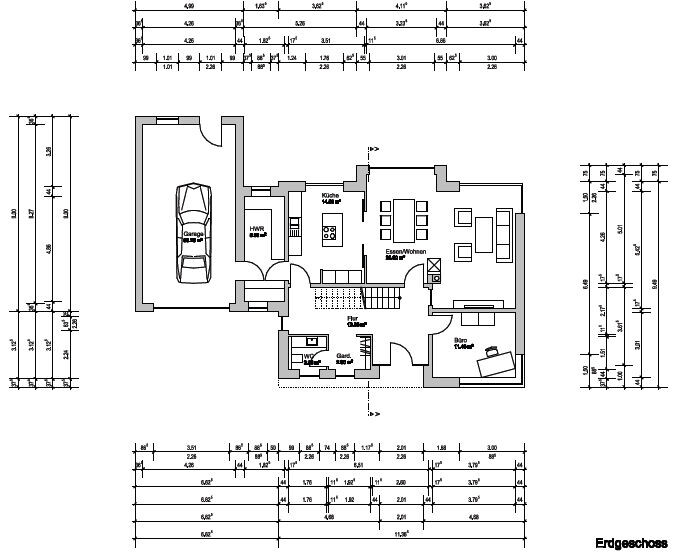

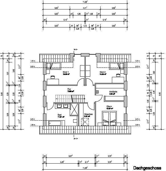

In the coming months, we will begin building our single-family house of about 170m² (1,830 sq ft). No basement is planned. The house will have a gable roof with a 45° pitch and a knee wall taller than 1m (3.3 ft). The technical installations (heating, etc.) will be located in one corner of the attic. The remaining attic space will be developed later. The south side faces the garden, oriented towards the kitchen, dining room, and living room. Although a straight staircase takes up floor space, it is indispensable for us.
We have attached the current floor plan that we developed together with the architect.
We would appreciate your feedback and tips to further optimize this layout. Especially regarding the kitchen, dining room, and living room being adjacent, we are concerned it might become too cramped.

kaho674 schrieb:
... When you enter the bedroom, you first run into the wall.I don’t find that a problem here at all: just put a mirror on the wall and that’s it.
What would bother me is the fireplace. You always have to walk around it, and there really isn’t much space.
Is that a window between the hallway and the living room? A stylish feature, but it would be very inconvenient if the sofa is ever placed against the free wall. Do you have two armchairs as shown, or are those placeholders? I would suggest you draw in your actual furniture.
Are those floor-level windows in the cloakroom and the bathroom?
