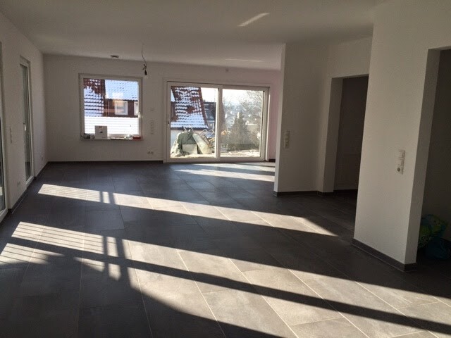

Doc.Schnaggls12 Feb 2015 16:11We had our ground floor (except for the guest bathroom) covered with Lucerna porcelain tiles from Villeroy & Boch, sized 45 x 90cm (18 x 35 inches) in the color "Graphite."
These tiles are not completely dark but are wonderfully durable thanks to their textured surface.
It looks like this:
By now, we are very glad that we did not choose darker floor tiles, especially because they combine well with other colors and are less prone to showing dust.

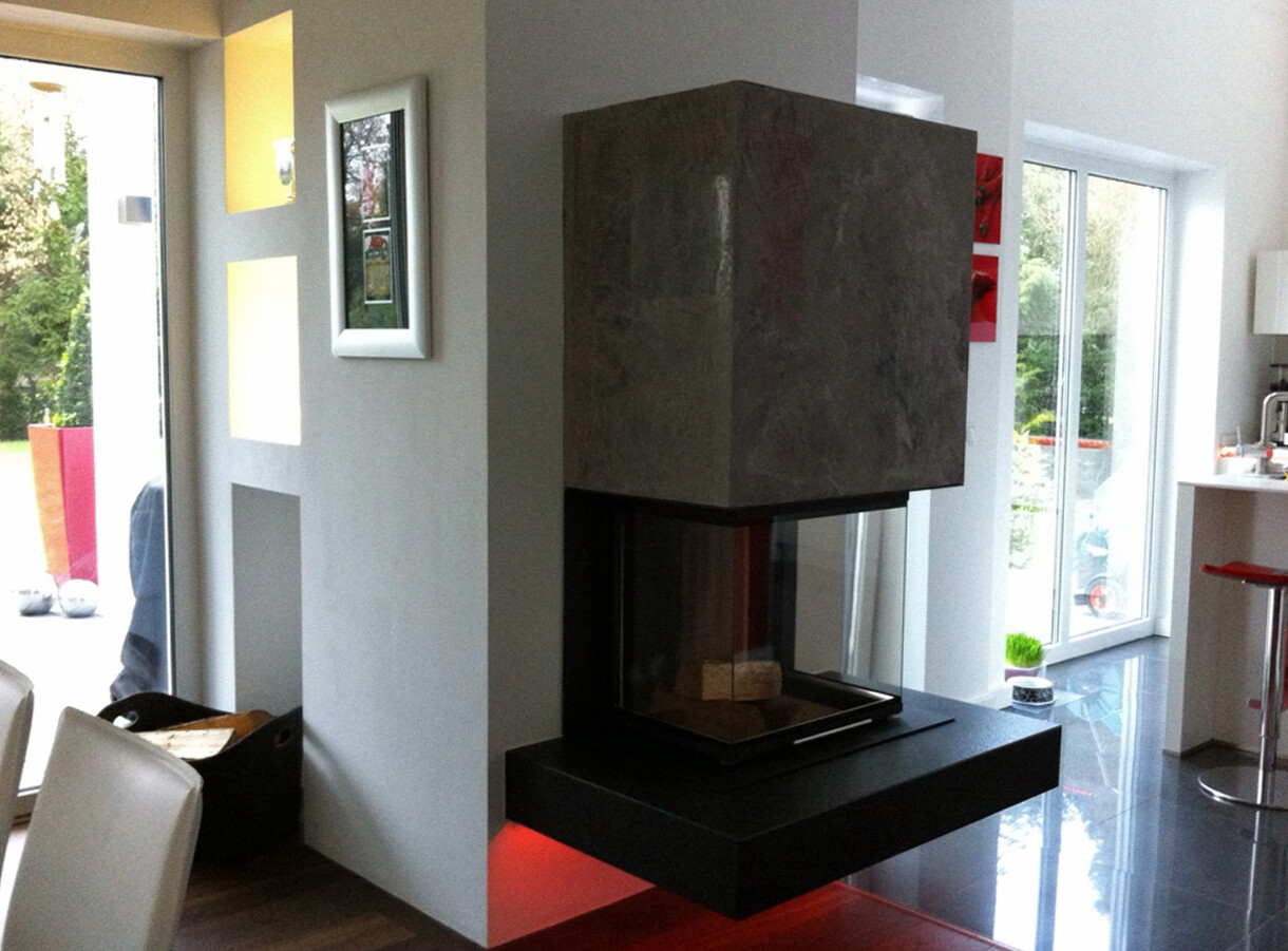

Bauexperte13 Feb 2015 09:45Hello,
Some of our clients have had V & B tiles installed both in high-gloss and matte finishes in 45 x 45 cm (18 x 18 inch) format; matte in the wet rooms, the rest high-gloss; only partial areas of the floor are laid with parquet as eye-catchers. And all of this in RAL 7016, a rather dark anthracite; not exactly inexpensive. It looks very good, no question; but it’s something else when it comes to everyday practicality. Just after cleaning, at the first step onto the high-gloss tiles—shoes always bring dust into the house—it already no longer looks nice; rather grimy. Add pet hair into the mix... well, I have other hobbies than cleaning.
Unfortunately, I don’t have a photo of “just” the floor covering, but in the attachment, I think it can be seen that high-gloss surfaces are not necessarily low-maintenance.
Regards, Bauexperte
